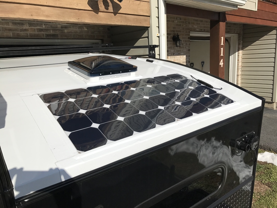

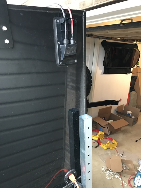

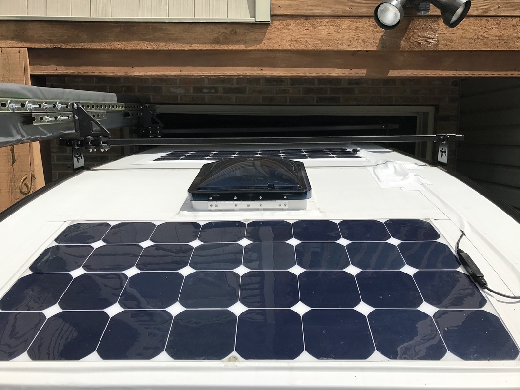

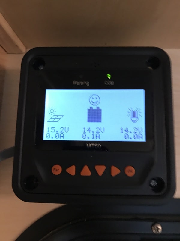

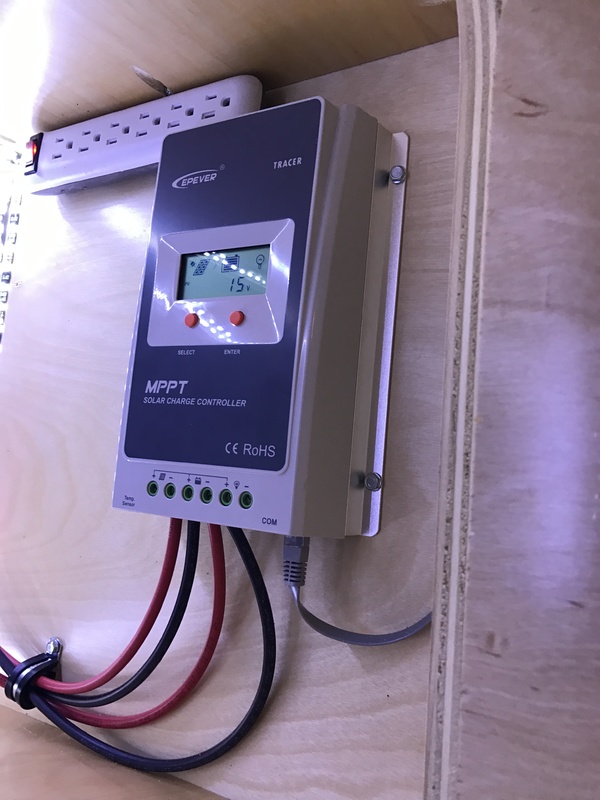

Let's start with solar. The 100W flexible panel was mounted and lines where run using Eternabond (in white) - this stuff is amazing. Word of advice - plan carefully as once it sets, you're not getting it off of there. The two solar cables run under the Eternabond back to the side rear pass through and into my MPPT solar controller.

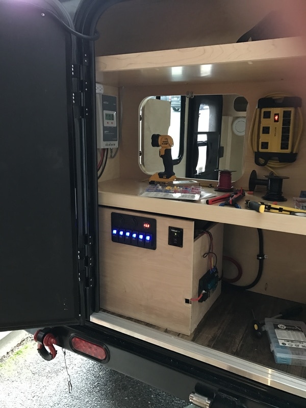

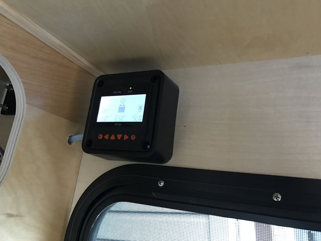

I also added a remote display / controller that runs inside the sleeping cabin so I could monitor the system without going outside.

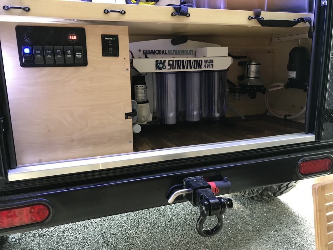

With the solar done, I finished off the rest of the power systems. Behind the wooden box there are 2 6 volt VMAX, 255 amp hour AGM solar tank batteries wired at 12v. They are supplying direct power to a Xantrex ProWatt 2000 watt continuous (3000 spike) inverter with a remote switch. The inverter is powering a heavy duty power strip that runs my TV, coffee maker, and mobile office equipment like laptops and phones (charging them). The shore power comes in through a NCCO pass through plug and immediately Ys off to a VMAX 20 amp charger that is permanently wired to the batteries and the other goes to a direct pass through to bypass the inverter if on shore power. All of this is fused and runs off of a master kill switch should I want to store the trailer for a long period of time. The system is strong enough to run my Climate Right 5000 Heat / AC unit off of the battery and the 20 amp charger will replace the used power faster than I'm pulling it. I would like to stress that I do not recommend this setup for normal deep cycle batteries as they are not meant to be used as pass throughs. This arrangement would rapidly decrease their life span. The solar batteries are the same as you'd use for your house if it were running off-grid and are designed for this.

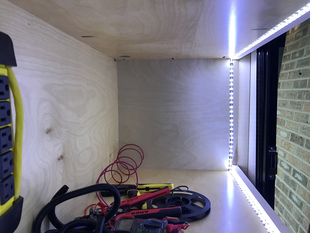

It's done now, but there's some clean up to do in this pic with wire hiding and covering so please ignore the mess... Also added some light strips around the center shelf behind the shelf lip so you can't see them and they are hidden on all sides when looking at the back of the trailer. .

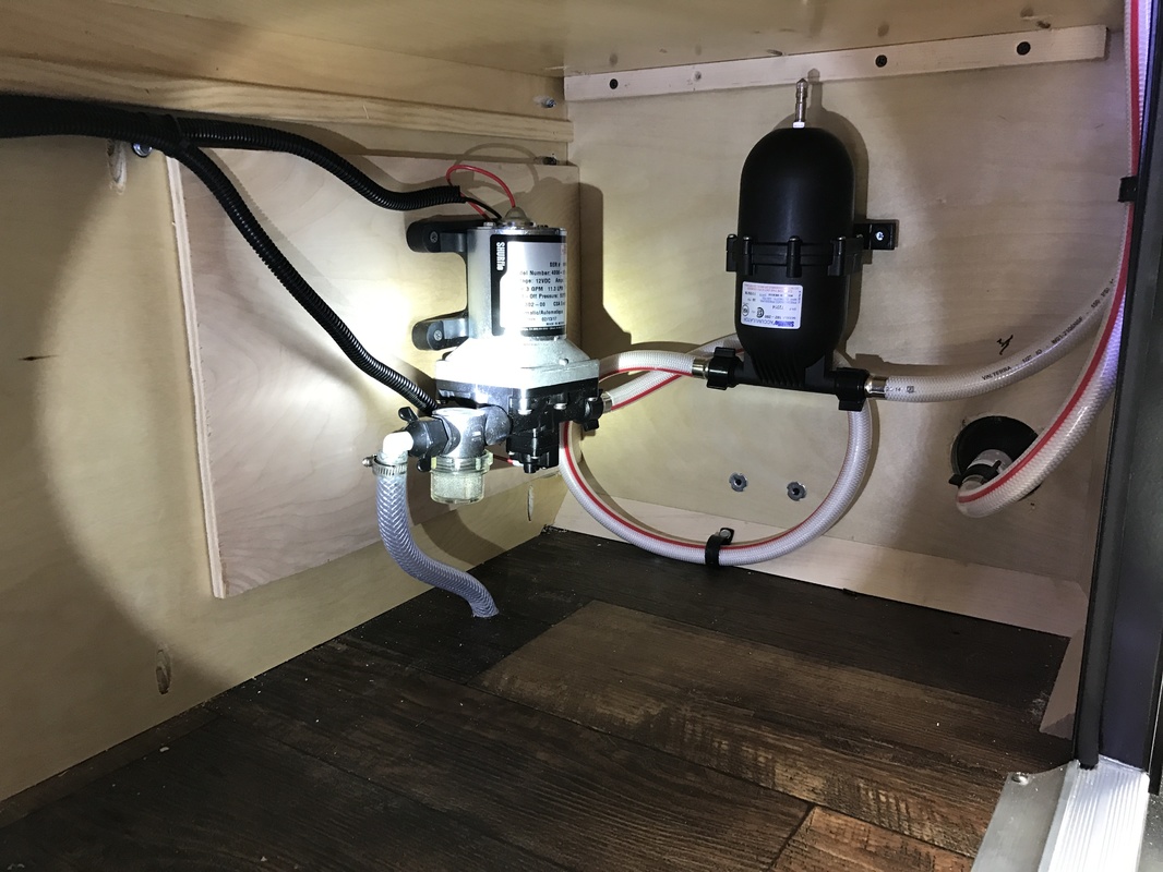

One of the switches on that panel runs to the water pump which I have installed to the right with quieting hoses and accumulator. The pressurized line then runs to a quick disconnect spray port pass through.

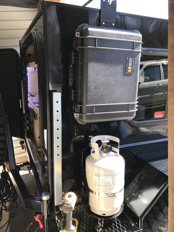

This weekend's project is to mount the on demand water heater and shower in the pelican case that is mounted on the side via quick disconnects.

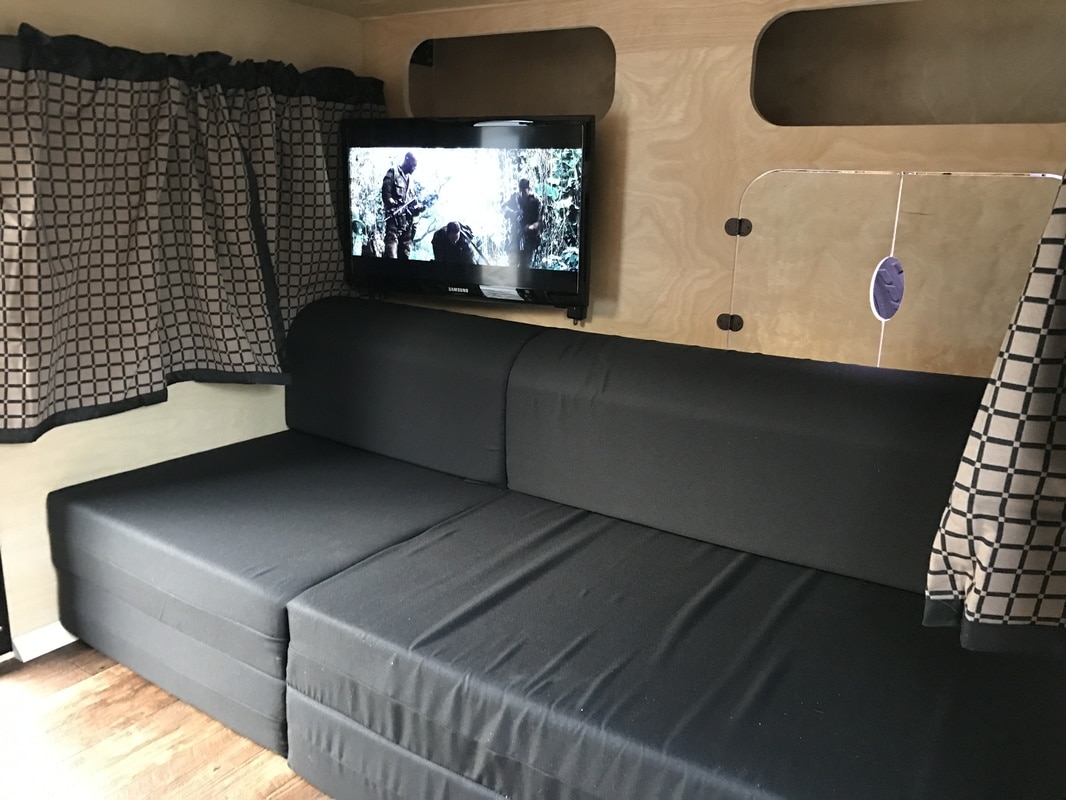

Moving inside, the 60/40 convertable mattress is in, along with privacy curtains, and the 24" Samsung Smart TV is mounted on a swing out arm and powered through the inverter.
I intend to sleep with my head toward the front, (facing the TV) so I wanted a softer light than the LED light ring around the fantastic fan put out. (The fan and light are great, it's just really bright.) So I added a dimable touch light, that is flexible for reading or just low light in the cabin. (Ignore the toilet box, it's next on my build list.) Also added the black cup holders on each side by the doors.

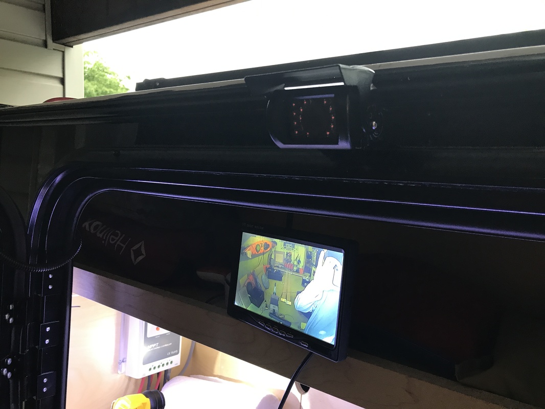

And since I'm here, I might as well post some updates to the trailer. Added a SAFH2O water purification system today. This will pull water from any source, filter it and sterilize it to fill the 21 gallon tank. It's powered from the solar bank so we pretty much have water indefinitely so long as a body of water can be found. It's built to also pull out so that we can fill jerry cans or water bottles too. It'll purify 180 gallons an hour.
Also added a wireless rearview camera. The monitor can be moved wherever there is 12v power (cigarette plug), so when towing the monitor is in the tow vehicle and when camping, it's in the trailer and acts as a security camera. This setup is nice because it lets you have a rear view camera no matter what vehicle is towing it! (Obviously the monitor isn't mounted there, it's just sitting in the photo so I can set the angle of the camera. Best $150 I've spent!

Added a second 100W solar panel. Now pulling in 200W, hitting 19-20v. In full size now in the spring I'm hitting 10+ amps. This summer I expect 15-20amps of charge which will reduce the charge time in half for my battery bank. Side note: I was planning on putting the CVT RTT on the Hiker but after some thoughts about logistics I'm not going that way. So that opened up the roof for the second panel and more sustainability.

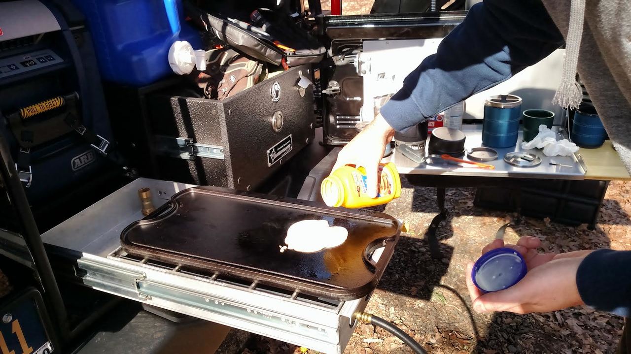

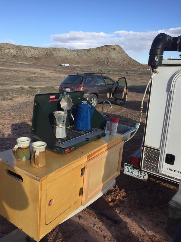

Whats everyone doing for kitchens on these trailers. I like them but I really want a complete kitchen in my trailer setup and havnt seen one yet.
Most people I've seen (on the owners FB group) use an addon counter that hooks to the side, like this. Personally, my kitchen is in the back of my tow vehicle, so I use my for storage, power and plumbing.
