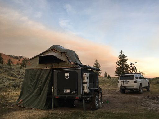

New to the forum, but I own a Hiker 5x8 Off-Road and traveled the NE, New Brunswick, Nova Scotia, Newfoundland, Rockies, Canadian Rockies, BC and the PNW for 5 months last year with it. Had some hiccups with the axel early on, but Rob, Wesley and Randy at Hiker helped resolve the issue. (They neglected to remove the alignment wedge which caused the axel to kickback and rub on the fender support, but once removed ran without a problem.) Couldn't ask for a more affordable, customizable and capable trailer. Last I knew they working on a airbag option which would be pretty sweet.
I'm sure you'll really enjoy it, my wife and I love ours.

The only modifications I made is wiring to the back where I plug in a Goalzero Yeti Generator, a fan and light, the rotopax's you see on the back half and I also have more mounted on the front, a road shower, 11lb propane tank mount, CVT Awning and underfloor storage.
Yeah, we slept inside and in the RTT. It just depends on the circumstances and if we had anyone else traveling with us.

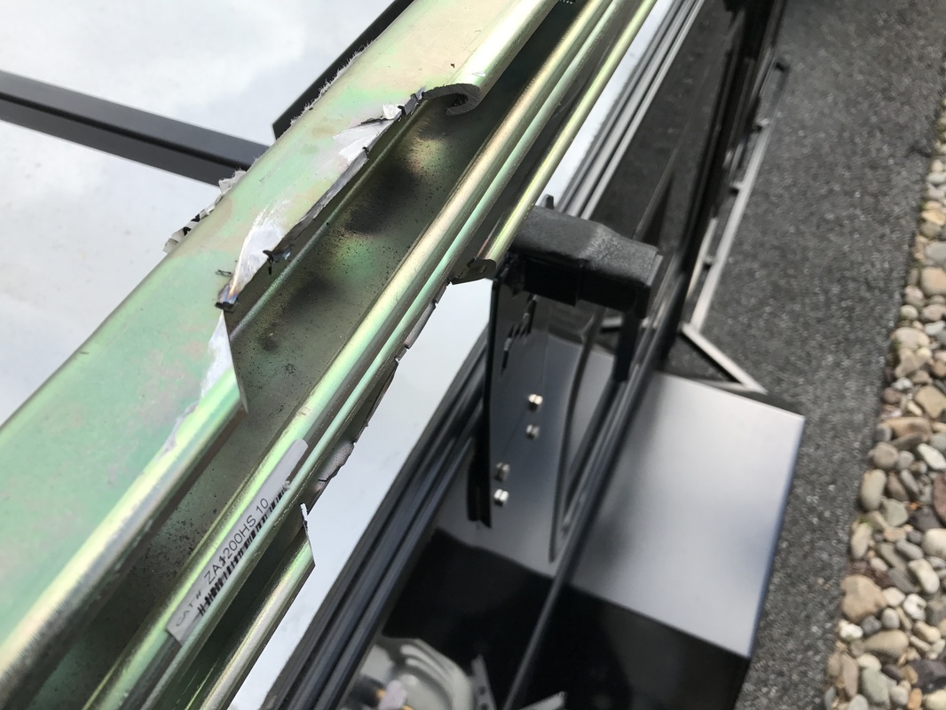

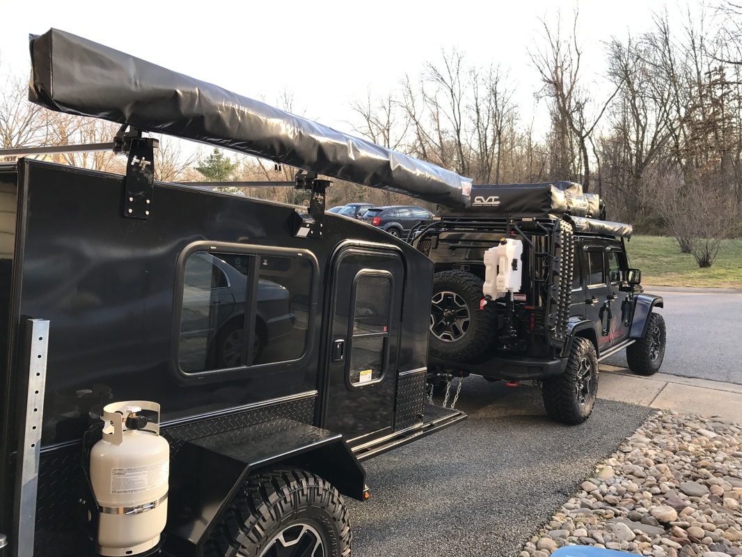

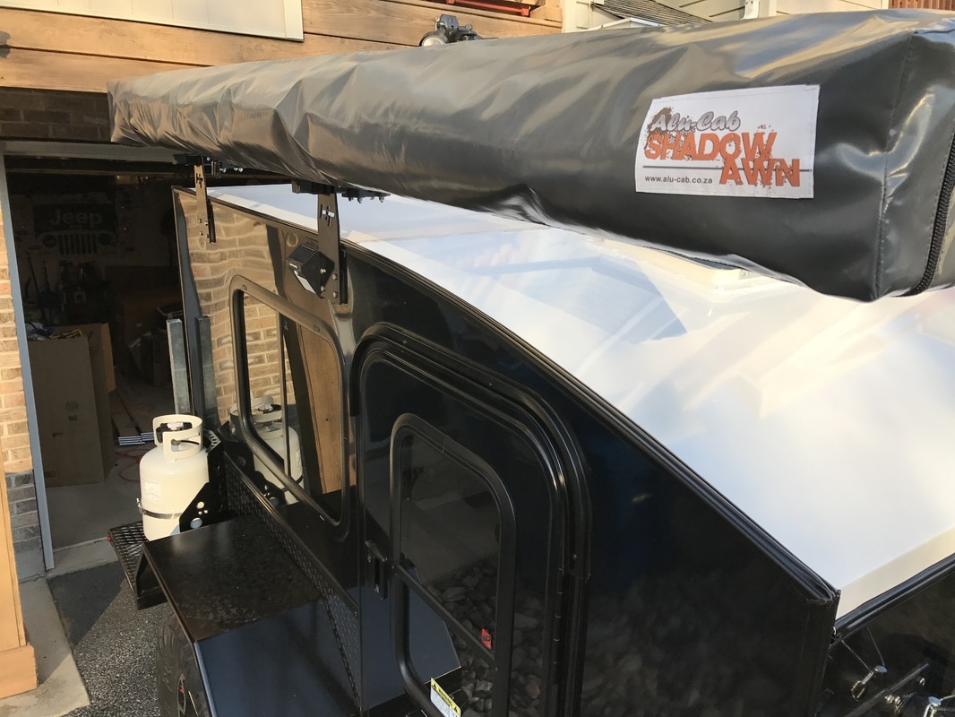

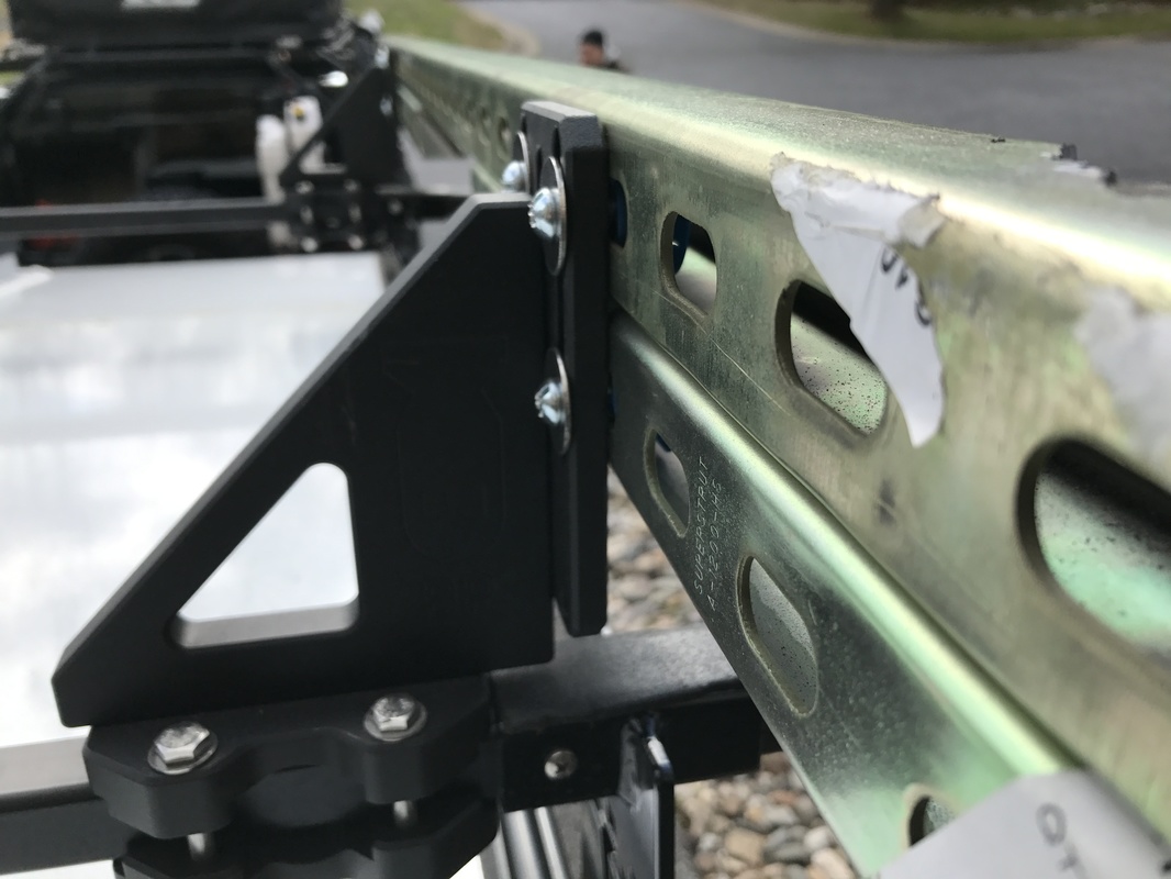

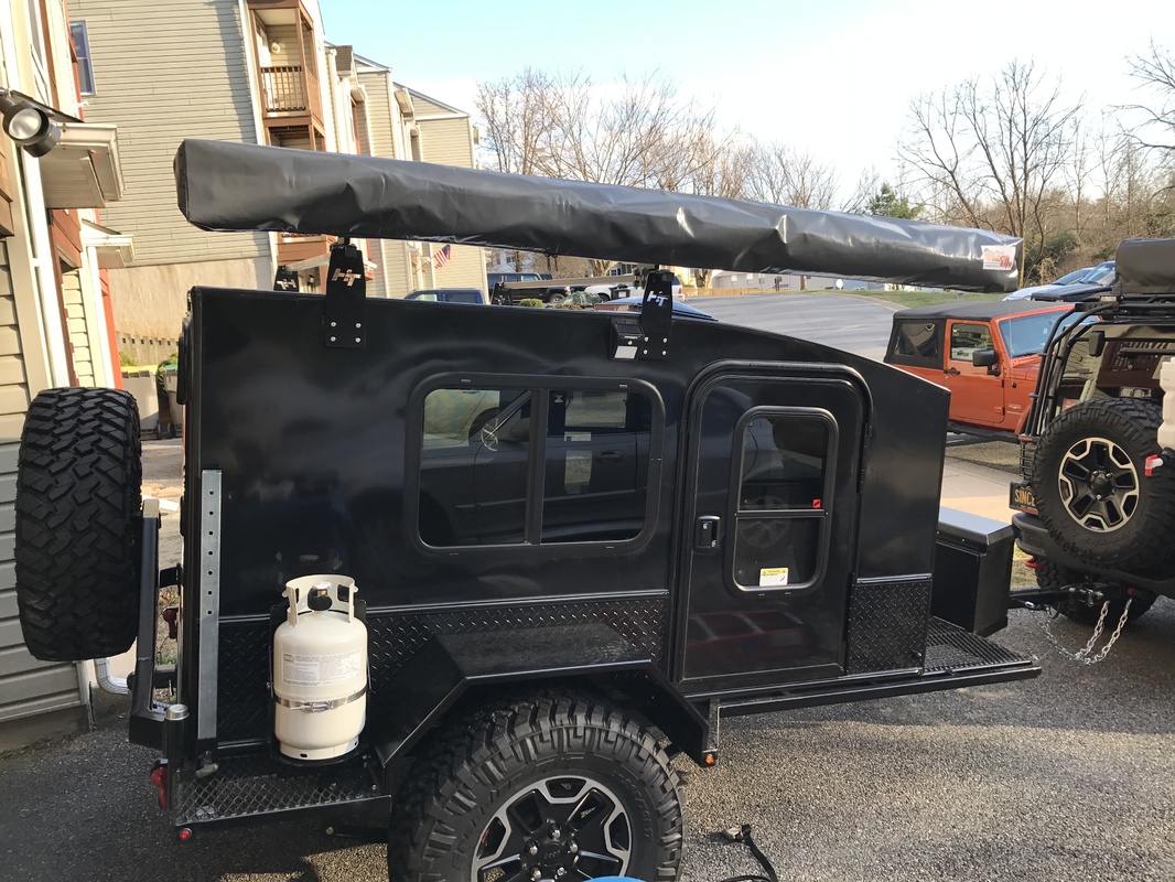

Started the electrical systems but a friend came over and we switched to installing the Alu-cab Shadow awning. If you've never installed one of these, let me just say, I don't know why they didn't pre-drill holes the length of the frame, but they didn't. So you either have to drill to match up to the Hiker roof bars or get creative. Not wanting to compromise the integrity of the awning frame, we got creative. The first step was installing a pair of Bomber Products Awn Locks which fit the Hiker bars perfect. This is a very long, very heavy awning because there are no structural supports when open. Because the holes didn't line up, we cut and mounted some square conduit rails from Home Depot. We double stacked them around the support brackets and then reverse mounted the awning to the conduit bars wherever there was a hole. That was the main problem was the the holes didn't line up and I wasn't comfortable with only two mounting points for this awning.
Because the awning was to be mounted flush with the braces, I had to notch the pivot point because the nuts stuck out of the back. I coated the cross bar end with foam tape so there would be no catching the awning fabric when opening and closing.
The result is a supper strong support system that I can pull myself up on and it will take whatever the awning throws at it. I will get some pics of it opened soon. We had a storm coming in the east coast and raced to get this done. I'm also stoked that at 6'5" I'm finally going to have an awning that I can stand under without having to hunch over. This opens just under 7 ft high.
