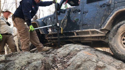

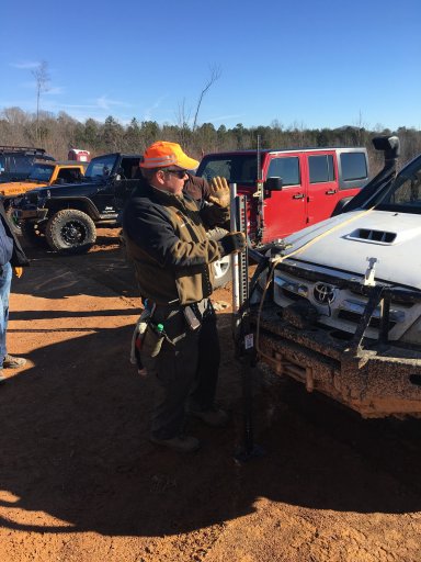

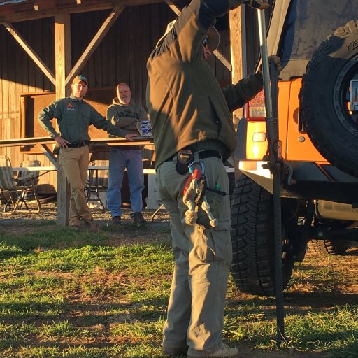

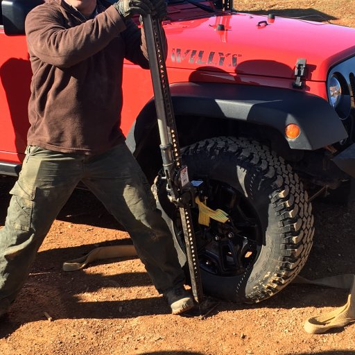

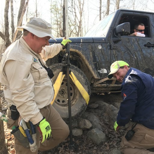

I am a big fan of Hi-lift jacks, but I believe a person should be trained before using one. Understanding some basics like which tire to chock goes a long way. Having open rock sliders make great jack points when high centered, simply use a soft shackle to wrap around the slider. Front and rear recovery points make for good jack points using a soft shackle. Its a lot easier than trying to lift from under the bumper, especially with steel bumpers falling out of fashion on overland rigs. I've been part of some really fun recoveries where we have driven off the jack in the move called a jack and cast. To do this, use a short 8' tree saver to lift the wheel. Hi-lift makes specific product for this purpose, but its easier to use tree saver in my experience. I carry a 48" jack, but will swap out for a 60" soon. Too many situations where 48" wasn't enough.

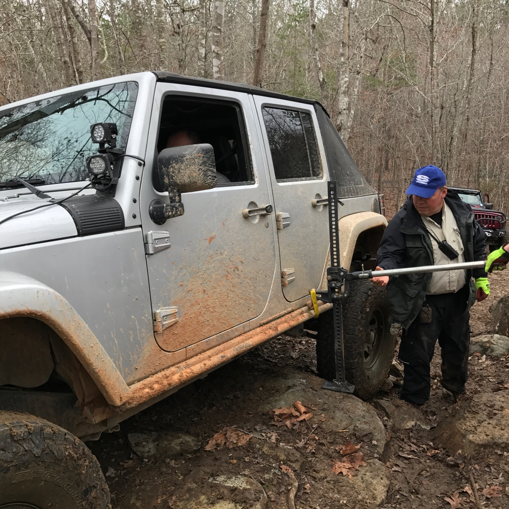

I4WDTA Trainer, Scott Fields using a 60" on high-centered JK. We couldn't get the Jeep high enough...
Charlie using a soft shackle to lift from slider.

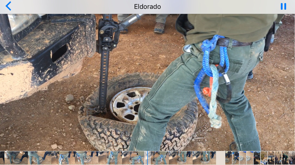

I4WDTA Trainer, Ron Parish using the hi-lift to adjust a tire that came off its bead. We ended up using air tank to reseat.
Here is a shot from another I4WDTA trainer, Tony demonstrating Hi-lift Lift-Mate.
Scott using rear recovery point to lift vehicle. Using a soft shackle would have made it more stable.

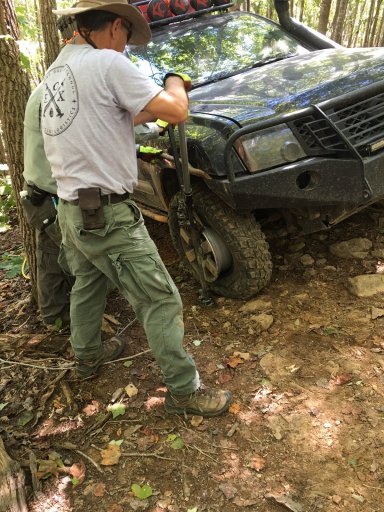

Scott demonstrating on a Hilux with an ARB bumper. ARB bumpers have jack points which make lifting from the front really easy.

@RichardS Thanks for the pics! Question about the Hi-Lift and tire off the bead. Is the Hi-Lift being used to unfold the tire from the rim? It's hard to see exactly, but looks like the tongue is hooked under the bead.
Yes, exactly. The tire rolled off the bead with a nice pop! Needed to use the jack to reposition the tire.
I've practiced the reverse before. It can be hard to unseat a bead to repair a tire in the field. You can take the wheel off, place the tire under the jack and start jacking the vehicle up. The force will break the bead. Once the tire is repaired or valve stem replaced we used starting fluid to reseat the tire. It was awesome.

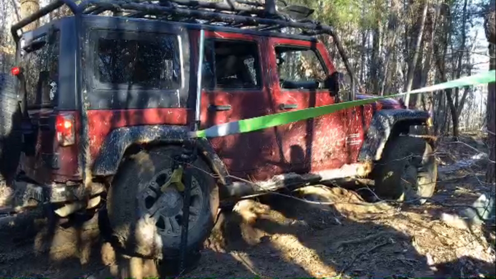

Fair point, but the driver needs to remain in control of the vehicle. If it were to come off the jack or worse roll over, the driver would need to steer it out of the roll. In this particular recovery, the intention was to drive off the jack. It's a fantastic recovery method. I've got a few videos I've taken. It always seems to happen with stock 4 door jeeps. You use a second tree saver to wrap around the jack to keep it from kicking back and nailing the vehicle's paint.

I'll check it out on Instagram. Wish we could link videos. Anyway, here is a screenshot of what I mean for the tree saver. You slip the loop around the jack (you can also take the handle off) and keep outward pressure on the jack to keep it away from the vehicle. Let's the person hold it 8-10' away.
