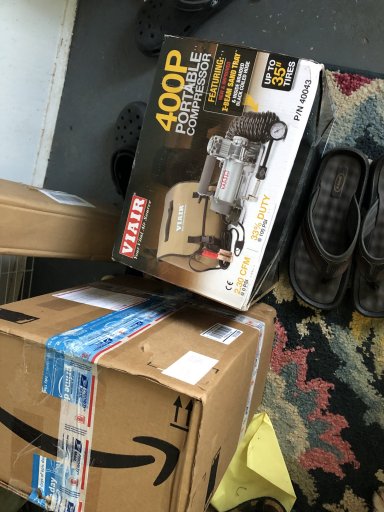

It took me years to do, but I took an ARB twin air compressor, and have it setup as an portable, instead of mounting it in one vehicle. With the tire size you will be using, I would go with the 400P. The better duty cycle does make a big difference! Besides, having the portable air system, you will be filling everyone’s else’s trucks too, after wheeling! Haha. Vance.
Dustinfromohio
693
Wooster, OH, USA
Dustin
Parsons
Dustinfromohio,
Ordered!
