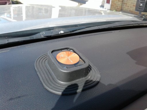

I use a Garnin GLO ll that connects to my Phone and Ipad loaded with GAIA by Bluetooth. I had to take the phone to T-Mobile to turn off th cell based locating and link it to the Garmin, it took them a while but they finally figured it out. So if know if I am going to be out of cell svc I will pre download the maps that I wil need but always link to the GarminB0A0EC60-D833-4F9B-A1AB-B8C14E494061.jpeg

Does Dual or Garmin require a subscription? Or is the service a one-time purchase with the unit? I don't see any mention of subscription fees but don't want to assume...
There is no charge for GPS data. The Dual receiver just relays the data to whatever map system you decide on. There may be a charge for the map system to organize, show you that you are lost. LOL
