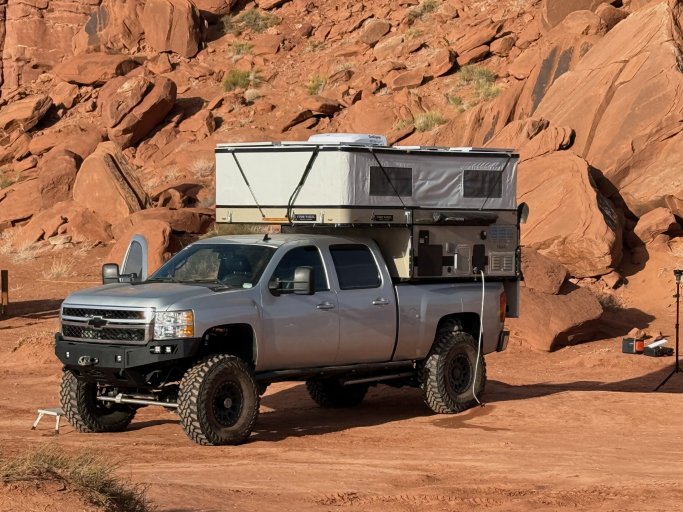

Got the camper back on and took it and my RV to the Mint 400 for a shakedown (@orange01z28 for scale):
The top of the FWC popped up is nearly as high as the RV. I’m going to bring the front back down an inch or two, then set the rear air to match which will get the four link bars perfectly horizontal.
Overall it drives much better now, more stable and less sway.

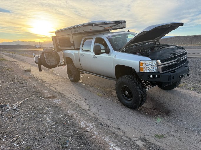

I drove the truck from Vegas to Palo Alto on Monday (with the FWC still on the back). Honestly I'm super impressed with how smooth and stable the ride is now with the whole new rear suspension. I'm sure it's some combination of flaws in the previous setup (factory leaf/Deaver pack starting to break down, no rear sway bar, pretty "basic" upgrade shock) and improvements in the new setup (Kelderman air-suspended 4-link with track bar, high-end 3-way adjustable shocks, sway bar) but it really was night and day. The 40"s run quiet and smooth too (we did use Centramatic balancers, I have them on my RV too and am a big fan). The truck cruised ~77 MPH very happily even in some pretty high winds and I did push 90+ a few times (for the sake of science, of course). I really can't believe how effin' good it is. The ~8.5hr drive went by like nothing, whereas before the truck was a bit tiring to drive that far (it felt like the rear was "loose" and any directional input would cause a feeling of the whole truck/camper moving over the axle before the suspension took a load, accompanied with a good lean). To be fair, it wasn't "bad" before and I had plenty of 8+ hr drives in it as it was before the rear change. Now it's just damn good. Overall, I'm very happy.
Of course, I still have some hiccups and things to work out:
  • need to do BCM programming to get rid of "Hyperflash" with the LED turn signals we put in
  • the front left TPMS isn't working properly so I get dash warnings
  • we have longer front limit-straps on order, so right now I'm not running limit straps (darn, no jumps ;) )
  • we are going to order longer 12" stroke coil overs for the front (for now we used a longer lower "eye" or whatever you call it to get the height in the front)
  • might need to go a bit further with the trimming at the front of the rear wheel openings, we cycled it with a forklift but things are always different "in the wild"
  • once we have the right coil over I think we'll actually bring the front back down about 1", which will match the rear when I set it with the 4-link bars perfectly horizontal

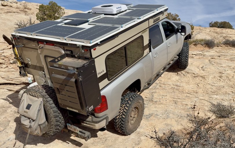

The latest round of mods for this rig focused mostly on the FWC itself, but the truck got some work too... and now the truck is under the knife again. So, here's where we are:
On the FWC the batteries finally died-died earlier this year and I threw in some cheapie Amazon lithium batteries. They actually worked really well, however I didn't update/change any of the things like DC charger, solar controller etc. to fully take advantage of the lithiums. Even though the el-cheapo lithiums worked great I've always wanted to do lithium right. Another goal of going lithium was fully deleting propane from the camper.
I worked with Las Vegas Overlanding Co. and we went a little crazy. We ended up over 1200Ah batteries, over 800W of mounted solar (and a 200W external panel), a 3000W inverter etc. for the electrical system. It's all top-notch stuff, mostly Victron, and all controlled through either a panel in the camper or Victron's app. With all that power we were able to upgrade all the "systems" in the camper, including adding a 12V DC AC/heat pump on the roof. Obviously the AC is a big upgrade in-and-of-itself (keep in mind I live in Vegas), but going with the heat pump style unit meant we could delete the propane heater. The water heater was swapped to 12V as well. Finally, the propane cooktop was fully deleted and replaced with a portable induction cooktop.
The cooktop delete itself also had a secondary goal. I never liked that FWC put the sink forward towards the bed, and the cooktop behind it. When I'm solo and use the bed in the side-to-side config it's no big deal. However, when my better half comes along we like to slide the bed out to the King config. This requires closing down the sink, which means you can't use the sink once the bed is made (but the cooktop was of course accessible). This never made any sense to me. If "nature calls" in the middle of the night, it's nice to be able to wash your hands inside with hot water (vs. using my outside rotopax), but I've yet to need my cooktop at 4am lol. Rather than hard-mount a new cooktop I just wanted the portable induction so it's easy to use outside (I prefer to cook outside unless it's dumping rain or freezing cold) and to create more usable counter space.
The batteries ended up where the water tank was, the water tank in the cabinets under the sink/prior cooktop area,
and obviously it got a new countertop and the cabinets were reworked accordingly. I did lose most of my "kitchen" side drawers and cabinets, but I still have plenty of space for all those things in the remaining ones as well as under the dinette seat and above the fridge. A ton of other little things were done like exterior outlets, lighting under the rear tire swing/step, reworking the struts for the top, rewiring nearly everything (higher quality, heavier gauge), a massive DC to DC charger etc.

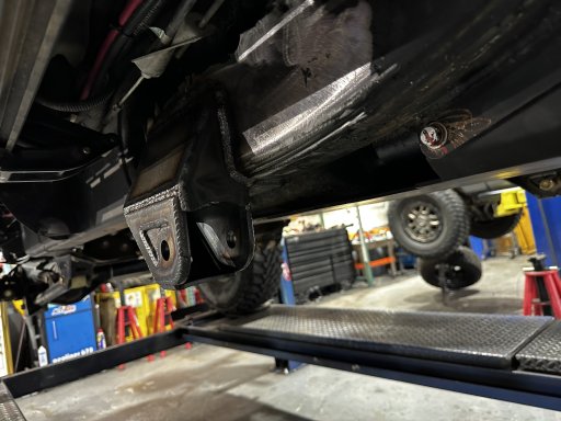

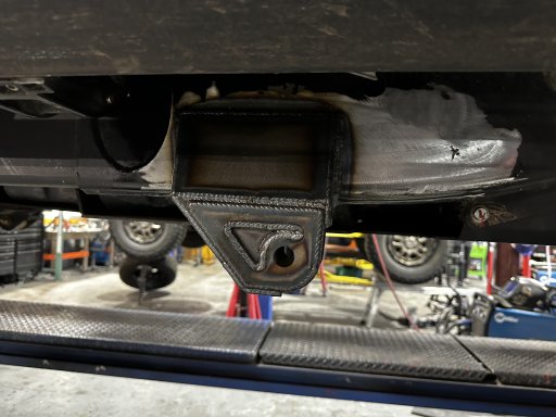

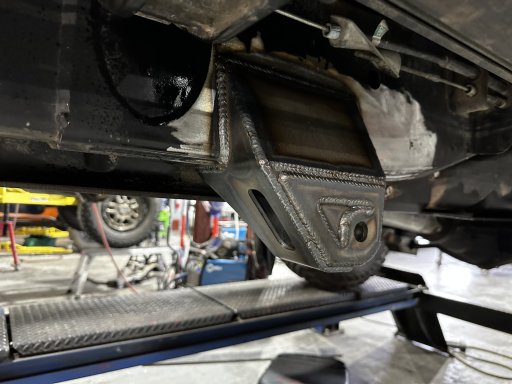

The other thing that has always been a liability in the rocks is the LCA bracket for the Kelderman. They hang the lowest in that section of the truck, and they are perfectly vertical:
I was thinking of having the shop I work with just triangulate the mount forward, adding strength and creating more of a "ramp" to the LCA. They had a much better idea, they're going to extend the front LCA pickup point forward to where the frame starts to kick up (arrow).
Here's the start of the new LCA mounts:
I have a trip at the end of the month, so hopefully my next report will be with all of this stuff complete, and some actual dirt under the tires!
-TJ
There will be two more supports reward. The supports are "open" now to allow full welding of each plate to the frame, but they will be capped of course. These are just the "foundation" of the sliders, obviously they will extend out further.

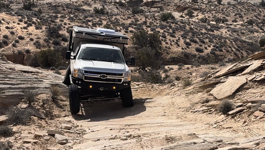

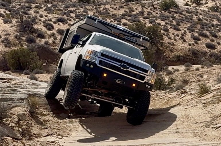

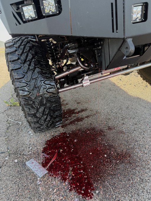

I finally got the truck back out, though not before a little drama. I headed out for a 3 night trip with Colorado Mall Crawlers in Moab. The first day was meant to be Metal Masher, which I was really excited to run with the big girl... though a bit apprehensive about clearance for the camper in one spot. Unfortunately, on the way out of Vegas my (new, OEM) trans cooler line had other ideas:
Luckily we were able to tow it back and get it fixed that night/the next morning, so I headed up to Moab a day behind. I was able to meet with the group and do some wheeling and camping for the next 3 days/2 nights:
Overall the truck performed amazingly. We ran some trails that folks were pretty surprised I was doing with a truck this big/heavy. The first day I accidently only had one hub locked (the passenger axle had come out to fix a leak, and I guess that hub was left locked... so when I locked hubs for the trail I just twisted both to the opposite position they were in, not paying attention, and ending up with one locked, one unlocked) which meant I was basically in 2WD all day other than the few times I hit the front locker (when I was in "3WD"). Still, it climbed everything I asked it to, and only took a 2nd or 3rd try once or twice (those were the spots I locked up). Had I been in true 4wd I doubt I would have even had to lock it. I did notice I wasn't getting any front drive in 4wd without the locker, so when I got to camp I looked around and noticed the hub "issue." To be sure that was all it was, I jacked up each side individually with the hubs now properly locked, the truck in 4wd, and the front locker on... sure 'nough both were locked in properly. Everything just felt easier the 2nd and 3rd days on the trail, and I didn't ever "need" to lock up - but still did over a few technical spots.
I did run into two issues:

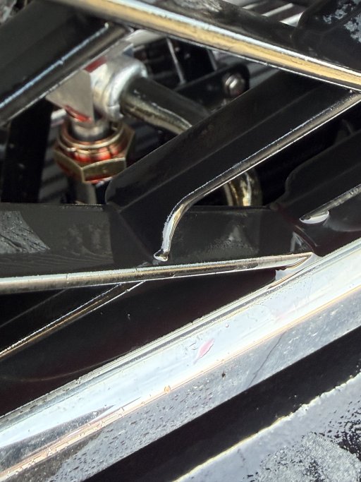

First the new long, rear lower-links contact the old link bracket when I air-down at camp. That will be an easy fix (we can cut and scallop the brackets a lot higher, they are only mounting the upper control arms now so we have room to work with).

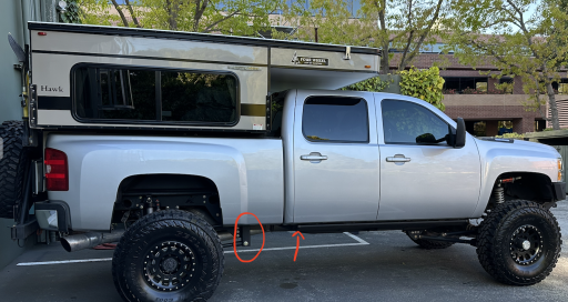

Second, the passenger side clam-shell mount on the front sway bar came loose. I suspect the bolt actually snapped, as it was under crazy load when the truck tried to articulate. Between the sway bar setup, and the limitations of the radius rod front susp I don't have much down-travel. I'd like to get more droop, but I'm at the limit of driveline angle where the limit straps are set. Going to a 3/4 link could remedy that, but I don't think this truck "needs" to go that far. I think I'll ditch the front sway bar for now (the truck drove home with effectively no front sway really great, actually) and see if we can sit the truck 1-2" lower, giving me 1-2" more down-travel.
As you can see, it did its best impression of the Toyota Wave:
