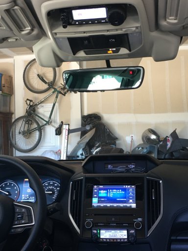

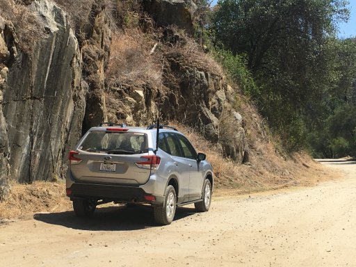

Mount options: I haven't looked a Jeep cowl recently, but I recall that there are many options for Jeep-specific mounts - I'll let the Jeep Guys comment on those. A good generic option for the hood is a Diamond K400 lip mount with either a UHF mount or NMO mount to match your antenna.
Mounting on the hood or tailgate can cost a little antenna efficiency, but not enough to tie yourself in knots over. Try to space the antennas apart from each other and from the metal window pillars. When I ran hood mounts on my 4runner, the configuration that seemed to work best was to put one antenna on each side (the rule of thumb I use is half a wavelength - about 40inches for 2m ham), and locate them at least a foot from the A-Pillars (far enough for radio separation from the metal pillars and far enough that when I open the hood, the antennas don't hit the windshield). The fiberglass will be less of a screening obstruction than metal. A hood mount might look something like this:
