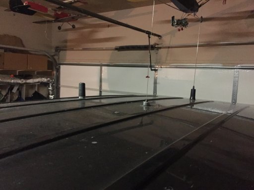

You mentioned interference between antennas above. This is my current configuration. Th3 stubby is connected to a dual band Icom 2730. The center antenna is a 2meter quarter wave for a single band 2m icom. The rear antenna is a Larsen 10m that I sometimes use for CB. That position is a floater, since I put various antennas there, often a UHF quarter wave.
I have not noticed any interference between any combinations of radios in use.
Reactions: Oranger and Ubiety
