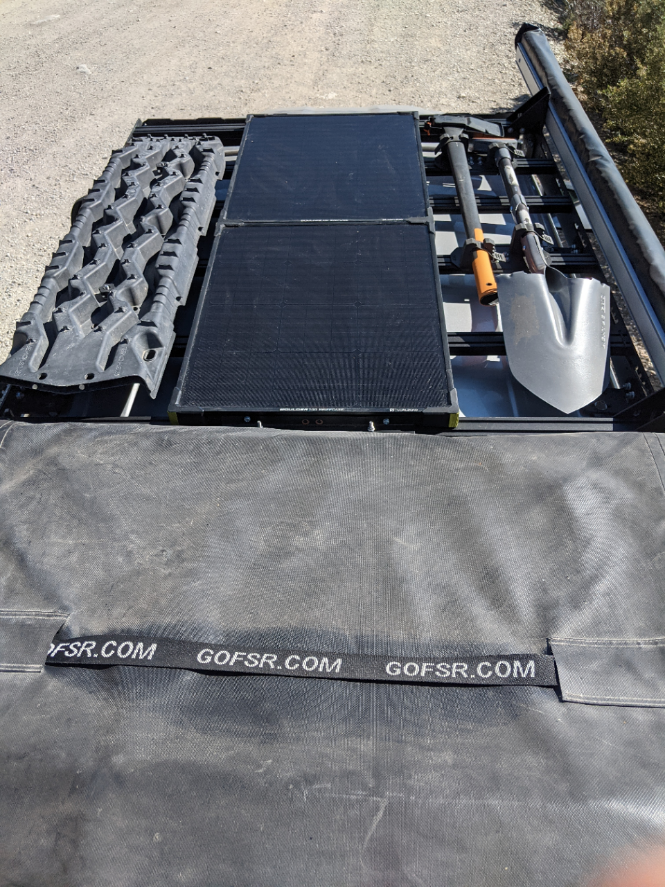

This a pic of the items installed on the UpTopOverland Bravo Rack.
  • ARB Tredpro Recovery Boards
  • Goal Zero 50 watt panels X2
  • Fiskars 36" Splitting Axe
  • Fiskars 44" Shovel
  • OVS 6.5' Awning
I purchased the Awning bracket and the Chop & Dig mount from Uptopoverland. The recovery boards are using a modified Yakima recovery board mount. The solar panels are using a bracket that I cut down to size and drilled out. I had to rewire the panels due to the cables being to short to fit in this orientation.

Drew, take the shovel and axe and use them a bit. I know this isn’t you, but whenever I see new unused shovel and axe I laugh at a fashion statement. I really like the way this is coming along. I will not be there tonight as I have to see a friend that’s in town.
We'll miss you tonight! I just got the Axe and shovel before my trip two weeks ago. We could have used a full sized shovel in Joshua Tree. We were all out there digging away with these tiny shovels meant for digging poo holes! My old Axe has a few chips in it so I figured that a new set was in order.
I do agree though, I hate to see stuff on rigs that go unused. I almost feel like I need to roll them in dirt. I at least removed the bloody stickers. That was difficult. Damn Stickers wouldn't budge.

Yep! I carry a folding shovel for under the rig. also a yard shovel for all else. Those T shovels are hard on me.
