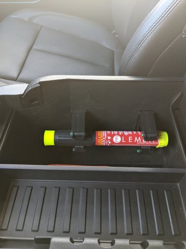

Mounted mine in the center console, using two Large Grip Hook (Everbilt) from HomeDepot...wanted to grab it in the middle , without offset/rattle
