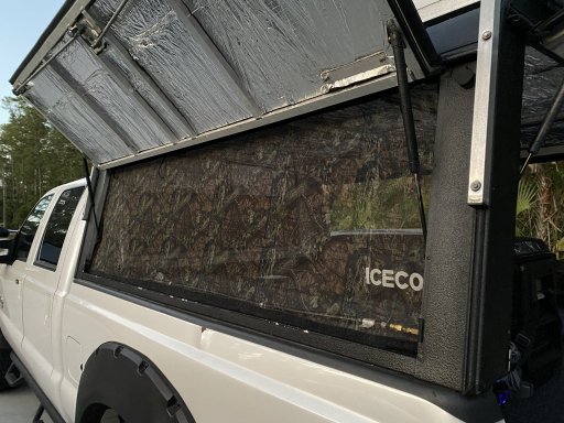

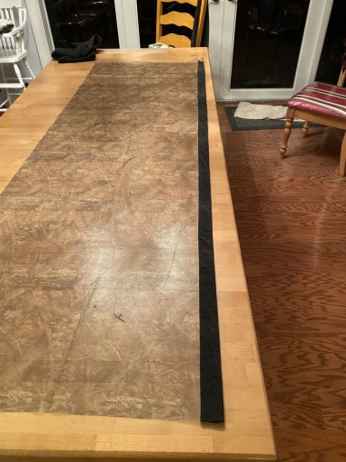

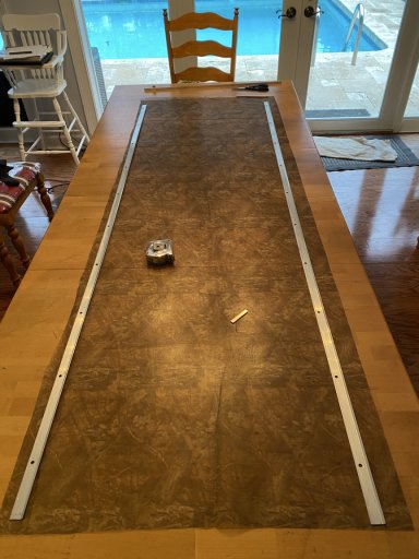

Update: Finished both sides of the bug netting. I think they will fair well but I might have to add more magnets in a strong wind.

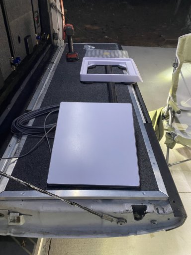

Last night the Starlink Mini arrived with a very nice 3D printed magnetic mount with a cover. It snapped hard to my roof top! I still have to route the power wire but that is simple.

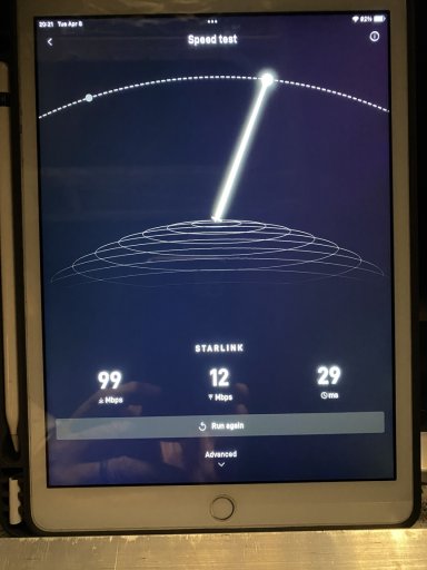

Starlink update: it seems that the power consumption at rest is steady at 9-10% battery per night. 30+ watts. I turned on sleep mode last night for 6 hours and it seems to only affect data as power stayed consistent. In the end it’s an emergency comms package so it will suffice! Speed test last night between an iphone11/old gen2 iPad and battery monitor this morning.

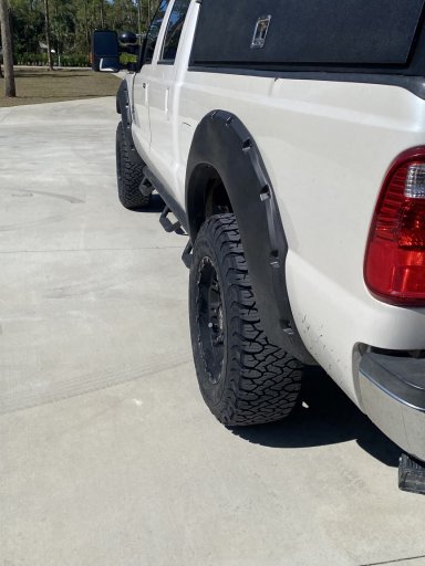

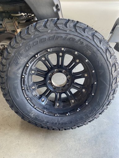

Pissed off update: for the second time in 4 years I have had tires decide to separate and bubble. I will never buy Nitto Terra Grapplers again. Let’s hope the BF Goodrich KO3’s will be better…
MidOH
1,298
Mid Ohio
Clark
YourHighness
Consider Cooper or Toyo.
I run Kenda, but haven't tested them in that heat.

I did considered Toyo and Patagonia’s but in an agitated mood I went with what I know (BFG’s). I ran them on my 08 F350 so let’s hope they hold out for a while!

The week before, the TPMS I have showed 106/104 degrees on the fronts and 109/111 on the rear so that might be a big reason…or dumb luck..

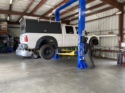

From the start, I have always said that I am not a trained mechanic. But I played one on tv once.
Anyways, my 4wd is vacuum actuated at the hubs. When I rebuilt the axle, everything was replaced. When I went on my test ride to north FL, I got stuck in the sand. That’s when I knew something was wrong. We traced it to a vacuum selonoid and I trusted my friends shop had tested everything. Then I hit the GAT. When I got stuck on a slick hill and had to winch myself out I watched the front tires not spin in 4low. So from then on I set the hubs manually!
Fast forward to today, we find out that the hub seals are bad AND the locking hubs are loose (did not replace them during the rebuild)
At first I thought it was my fault when I rebuilt the front axle.
Then we opened the new seals from ford and one is bad. So it might not have been “all” my fault except not knowing what a bad new seal looks like.
So I don’t feel as bad now..

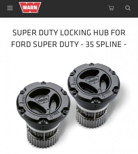

More good news came the other day!! Not only are the knuckle seals bad, so is the driver outer shaft. We also received 2 new seals from ford and one was bad!!! At least I will have spares if I break on the trail! I love all this good news!
I hate paying Ford dealer prices but I’m at the mercy of my truck being on a lift at my friends shop! Shout out to Leo @ Golden Wrench!
At least the Warn manual hubs arrived today!

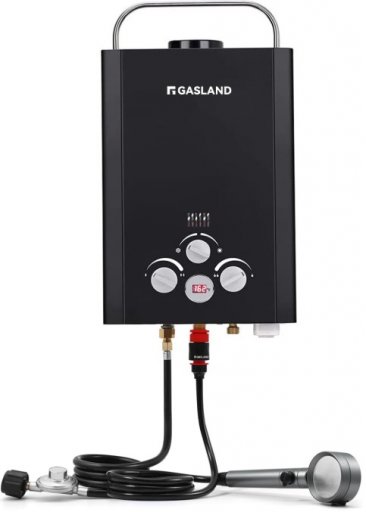

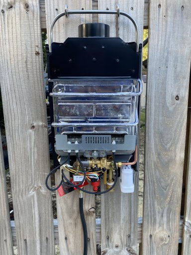

Well, I haven't posted on this page in a while so I guess I can get it updated.
Gasland tankless Hot water heater journey. So I found out that I broke it! Too many volts burned up the ignition unit. Reading is fundamental. Max volts is 3, I connected 12vDC. oops! Anyways, in my research, all of these units are almost identical. I mean the $5-700 unit is spot on exact on the valves, switches, controllers used. So why pay more??? I am thankful that they warrantied the unit so I got another. I swapped out the igniter pack and sure enough, it is definitely the igniter unit. I am trying buy a replacement part but so far their support hasn't responded in 3 days for replacement parts. At least I have spare parts for the new one!

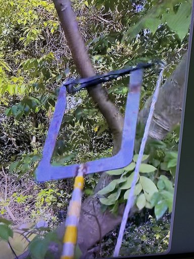

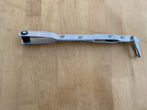

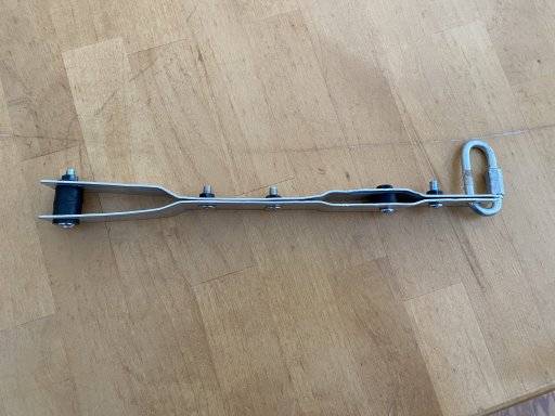

You know you’re bored when you take a YouTube short and create a tool!!! Not sure what I think about this idea yet but it's either tossing a rock or using a tool??? Maybe I am just bored?? But if getting that pesky “garbage” rope over a tree branch could be easier, why not? Part 1 complete. Now to make the u-shape with notches and find a cheap collapsible pole

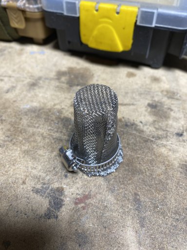

Diesel Heater spark arrester: After reading about fires, how to avoid them, then seeing that things like this are mandatory out west, I decided to make a spark arrester for my diesel heater exhaust! Just another thing to add to the tool kit!!
