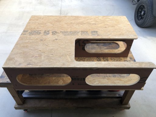

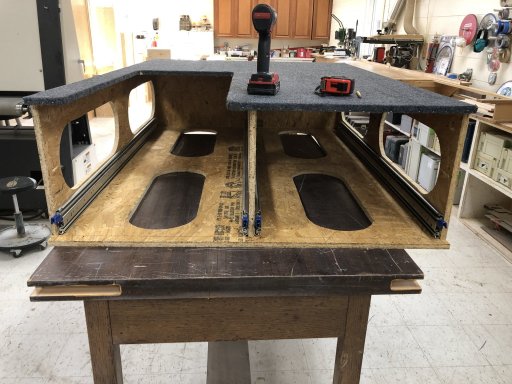

The final leg of the cabinet build is under way. Completed base cabinet, installed 4-500 lb slide rails, and made the initial slide boxes. Many items to change/cut out for the pull out sink/cutting board, the pull out Blackstone griddle and then figuring out the best storage ideas for the left over space. I have ideas but its a build as I go and see what works. I am absolutely positive that all this will change after the first long distance ride...Plan your work, work your plan and all will be ok. Some other things I have completed are building a quick removal platform instead of a rear seat delete. Installed the Midland radio and finished the TMPS mount. Plus so many other small little things i wont bore you with.

The final leg of the cabinet build is under way. Completed base cabinet, installed 4-500 lb slide rails, and made the initial slide boxes. Many items to change/cut out for the pull out sink/cutting board, the oull out Blackstone griddle and then figuring out the best storage ideas for the left over space. I have ideas but its a build as I go and see what works. I am absolutely positive that all this will change after the first long distance ride...Plan your work, work your plan and all will be ok. Some other things I have completed are building a quick removal platform instead of a rear seat delete. Installed the Midland radio and finished the TMPS mount. Plus so many other small little things i wont bore you with.
Where did you get the carpet material. Mine sucks bad. And the glue I used sucked even worse. LOL

I like the carpet very much. Rubber backing to boot! I used spray adhesive from Lowe’s and so far only the edges are a problem. But that’s understandable.

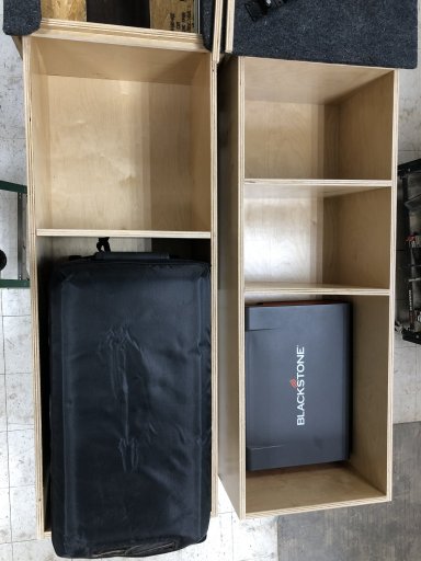

Made the initial slide boxes. I must be weird. I like the developing process. Taking a concept, a picture, an idea, and build it. Of course the ideas change when its physically in front of you, so plans change. I always wanted the griddle to pull out of the main drawer. Yet when you start war gaming how you are going to cook, clean, store items, other ideas pop up. How many changes I go with is a hard decision. So I ordered 2 sets of slide rails, a usb fan to push out the fridge compressor hot air and another set of lift top table hinges. One slide is a side mount and the other is an under mount.
The griddle pull out will be a low profile drawer that is 19" long. So the cabinet will be (52+19) fully extended. The overhang past the tailgate seems perfect. The 500 lb slides are more than capable.
The fridge slide low profile drawer that uses the undermount slides, will hold the collapsible sink and a cutting board/prep area. When cooking, the main slide will only be pulled out 28", to the edge of the tailgate, and then the prep drawer will come out 30". This creates the perfect "corner" kitchen area.

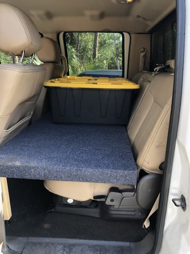

Another task completed. Made a 2” memory foam sleeping pad from scratch! With much help from the web site www.sailrite.com, the fabric calculator (bottom of page) and the videos were spot on. He said 30 minutes but it took me 4 hours… who knew¿
32”x72” fits nicely on top and next to the fridge!

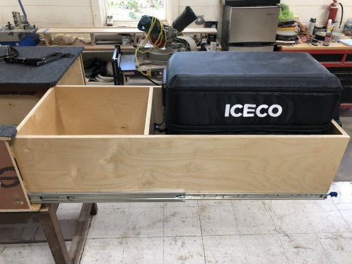

ALMOST there!!! Fridge side slide is 95% complete. Hinges for the rear storage lid, fridge tie downs straps, a cutting board and the final facia cover is all that is left. I pulled it apart and did the final glue and square and edge banding.

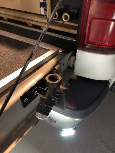

Getting the final "nickel & dime" items knocked out. So I had to think about an easy way to use my water without disconnecting a hose. Requirement is for cold water for cooking, drinking and washing. Hot water for washing dishes, general clean up and showers (not daily). So I made a bracket that can be added quickly to the tailgate and then mounted splitter valve. When I set up camp, its a really quick hook/screw and connect the quick disconnect stub lines. Then I have a lead for the sink area and another for the propane hot water tank.
I know some might say... that's a lot. Maybe so but I am a rookie and it might be a rookie mistake. Yet I know that my personality is that I am a scenario driven guy. I look at my truck and say...what do I want and is it practical. So far the 3 amigos in my head all agree!! We will see...
