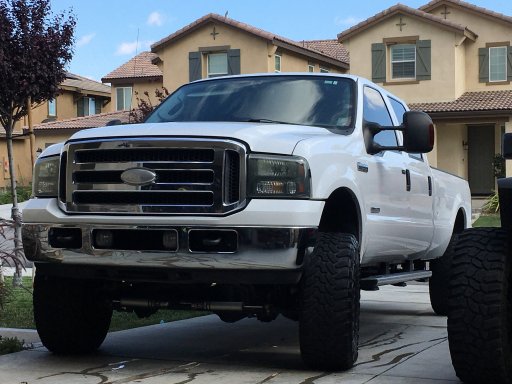

I’m studded with BP EGR, OEM cooler, IPR Coolant filter with ELC, new FICM and monitor. She’s been a champ on the 35s but I was curious about the 37s. I don’t want to mess with the turbo but I will get a safe tune soon. I think I’ll stick with the 35s and use the extra cash for goodies!

Nice looking truck.. I have a Powermac v4 for the 6.0 in storage we never used my shop manager just reminded me about. Mounted and then went to twins... would take a reasonable offer for it.
I'd add the Bullet proof diesel oil filter relocation kit and cooler, adds huge oil volume. just don't put it under the front bumper like they recommend. The cooler in front and the oil filter on firewall works awesome.
I liked that body style of truck.. had a crew cab xlt that I wish I'd kept... but it was a LOOOOOONNNNGGGGGG BED, Long wheel base definitely NOT an Overlander.

Here’s a picture of my girl.View attachment 170057
Thanks, I’ll have to pass on the turbo but thanks. I’ll definitely look into the oil filter relocation kit.
Yes, it won’t be an exploratory vehicle. More of a fishing Basecamp to spots I know I can fit it in and yes it’s a very long truck.
