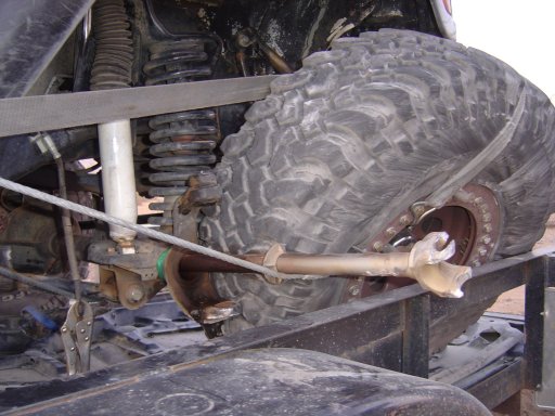

Ever wonder what happens if you break a ball joint on the trail?
smritte
Ontario California
Scott
SMR
8846
KO6BI
This happened in Doren canyon up in Calico some time ago. If you look carefully, you see a car hood laying on the trailer. We used that as a skid to drag the Jeep backwards out of the canyon about 200 yards to a trailer. the only thing that was holding the knuckle/tire on was the steering. When the ball joint broke, it instantly broke the other one then snapped the axle and brake line. This is one of three I have seen.
For some reason, people don't tend to check ball joints or don't know how. This includes shops. The load you put on them combined with the off-road driving lessen the life span and makes this very important to keep an eye on.

There just happened to be a car hood laying around? More pics are needed here
Unfortunately that's the only picture I still have. Found it by accident this morning while I was looking for something else. This was not taken with a digital camera, I had scanned it into my folder. The hood was from an abandoned car someone spotted earlier.

The driver side ball joint had play in it also. So, Yea, high mileage and wear contributed to it. And yes he was under power.
Eight or nine months later a 4Runner in a group I was in, was cruising down a dirt road broke one also. She was going up a mild hill. Fortunately the damage wasn't as server. The surviving side had a bit of play in it also. She had just bought it and the shop that inspected it, gave it a clean bill of health.
Every vehicle I have seen that broke a ball joint was high mileage. Not all of them were 4wheel drives and not all were off road.

How do you check them? I should be more specific. I've checked a few old buckets and the joints passed. But the truck was loose as a goose.
I'm going to give a basic description here for the people who don't know how these things work as well as answer your question.
If you watch the video posted, that's the basic procedure, mine is similar. I'm looking for up/down movement. You can force a good one to move if you try hard enough. I have some I use at work as demo's with close to 1/4 inch of play.
Here's for people who donk know how they work.
To understand how they break you have to understand how their built. The steel ball sits in a pocket surrounded by a soft metal. Normally this is bronze. Between the bronze liner and the outer socket is what's called a spring. This normally is a thin, very hard rubber. The spring serves two purpose, one is cushioning the other is keeping tension on the liner to the ball. The ball joint is designed to support up/down and very little side/side as well as allow turning.
Over time the rubber spring becomes brittle, the bronze wears and now we get up down movement. On the street this isn't bad. Dirt on the other hand works it harder, add in the side pull from a front diff and we get wear on the sides also.
Once this is bad enough, they don't really break as much as pull out of the housing. On the street, it has to be worn badly then al it takes is a good bump to unseat it. Off-road the front diff pull can pull it out of one end. That's what happened in the picture. If I had thought to take better pictures, you would have seen where the bottom pulled out and the top was ripped out.
As I stated before, I have seen this three times off road and twice on the street. ALL of them had the same issue, worn and pulled out.
When I posted this, I didn't think it would get the push back it did. Just because someone hasn't seen it doesn't mean it wont happen. If they do see it, it also doesn't mean they took the time to analyze the problem with understanding how the things are assembled.
