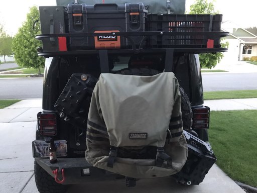

I mounted my mats between my spare and trasharoo. I used some square tube and angle iron. I had a spare tire license plate mount laying around that I welded in. I don’t have the tent on the rack anymore, so now I carry the mats on my roof rack. A13D8631-BAF4-48F7-8391-74C9F050D0D2.jpeg

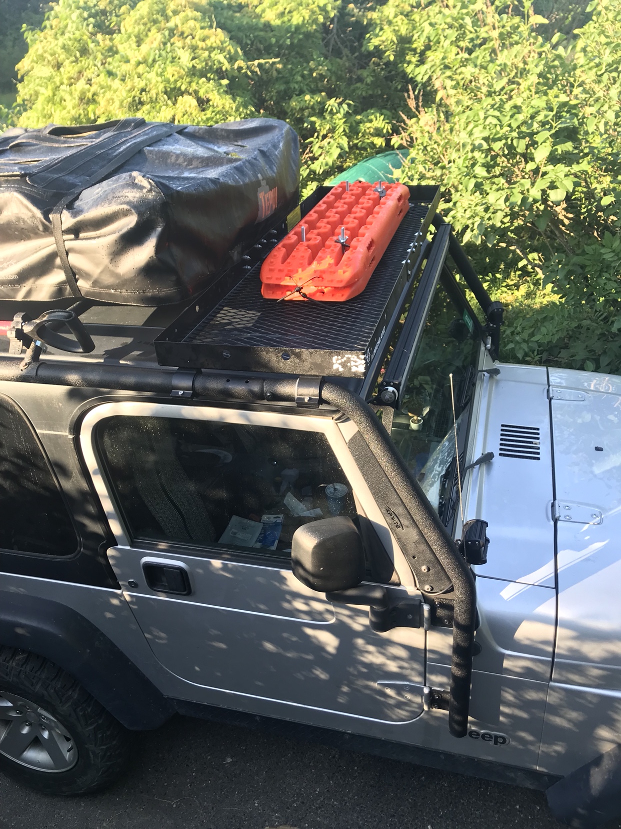

This is how I decided to mount them. It’s a modified trailer hitch cargo carrier mounted to some heavy duty tubing mounts. (4 clamps rated at 50 lbs each.) My tent is mounted towards the rear of the jeep so I figured I would make use of the space. I got some long bolts an sandwiched the mesh floor of the cargo rack with some big washers and a nut then I put a wing nut on two of the bolts to hold down the boards.

That’s a cool idea, I see them on Craigslist for 25-50$ allot. How did you remover the receiver part?
jeepwillikers
It was actually a 2 piece rack bolted together by the receiver part. I just cut the receiver section flush with the bottom of the rack with an angle grinder.
Highland 1042000 Hitch Mounted Cargo Carrier
GS Power's Bracket Clamp (choices of 1 / 1.25 / 1.5 / 1.75 / 2 / 3 inch ). Mount LED Light Bar, Safety Flag, Antenna onto Bull Bar Tube Rack Roll Cage Bumper on Boat Can-Am ATV UTV Bike (2 pc)
These were the parts I used. Amazon prices fluctuate a bit but I think I spent about $75.

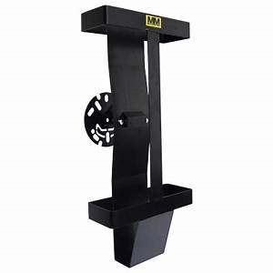

There is this, for a spare carrier that is more substantial than straps, and much more secure:1565321525141.png

have you found any source to purchase this Item?
Not Stateside. Made in Australia, and so far, I do not think it has been imported into our country. BUT........more and more items are making their way to our shore all the time. Looking at that design, it would not take much to update the actual mounting plate to attach to a side rack. A 'bungee' cord, or lockable clip would keep a set of boards in place.
It's possible someone has a similar design that might be produced now domestically. Research on that would have to be done. Maybe someone who went to EXPO East/West, could better answer that, as the shows have become a magnet for new product releases. I know that you can now get a Max Trax mounting board table for a Toyota Troopie aka...4X Overland...(could be modified for a side rack/roof rack) , that was once only available overseas. So again products are trickling in from other places. I'm surprised that Chinese manufacturers haven't jumped head first into Overlanding. You would have expected companies like Smittybilt to have something out by now.

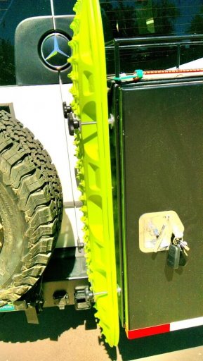

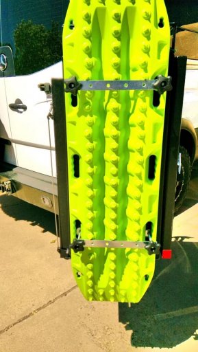

Not on the spare but I mounted ours on the side of our galley box with 4 long bolts and some star knobs from Grainger. Cost about $10. We now have 2 pairs on the same mount instead of just one.
