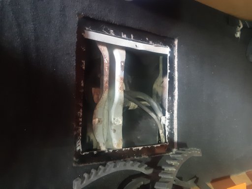

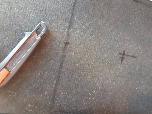

A maintenance flap must be installed in the bottom so that the hoses, connections and fuel sender unit can be accessed from above. No sooner said than done. Measured and marked. Sawing in this area is very tricky, because the tank is located just below the floor panel! I really had a lot of respect for that. So I first drilled a small hole and built a wooden stop limiter for the drill. Then I could see if I had hit exactly the center with my drawing. For sawing I decided to use an air saw. I could handle it nicely and it worked well. But I would still recommend removing the tank if necessary to be on the safe side. Because I kept sawing, checking, sawing, and so on. A cross brace also had to come out.

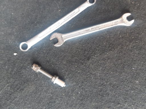

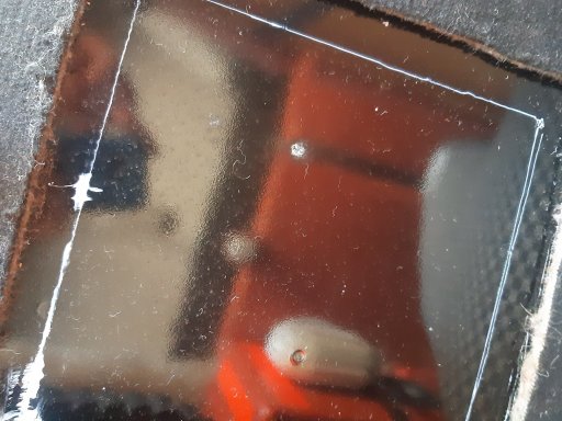

As kind of lid I used a 3mm aluminum sheet. This I have bolted in the bottom with four M4 bolts. For the fastening in the floor I put rivet nuts. Lacking suitable riveting pliers I did it with the bolt wrench trick. Also this went very well. As a seal serves a foam rubber plate, which I glued to the aluminum.

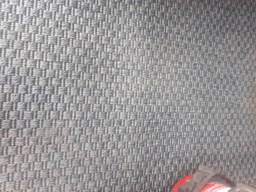

In the end, the cutted piece of carpet came back in place and the floor carpet was over it - nothing to see and yet quickly accessible if it should ever be necessary.

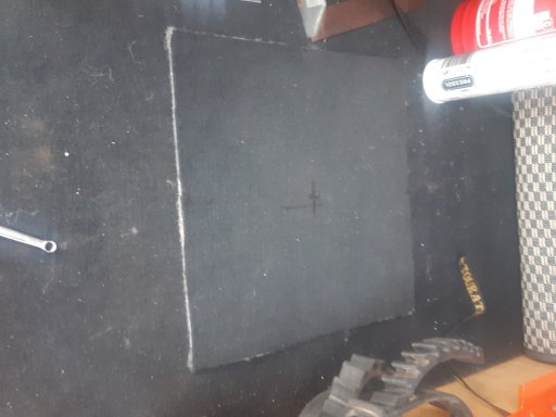

The start:
Measure twice, cut once:
The big hole:
Installing the rivet nuts with two spanners:
Floor carpet back in place:

Little update on this. At first, I had decided against cutting out the cross strut as well. I thought then the floor lacked too much stability. Instead, I thought it would be better in doubt the tank sender unit to thread around the strut.
I looked at it again and today removed the strut - it is perfect and still enough stability in the floor. And I have left a piece of the strut right and left, in case I want to add there a piece of metal for stabilization with bolts, but I think that will be unnecessary.
Now I can get to the sender unit and fuellines really good in case of maintenance, cleaning and eventual repairs. Regular cleaning and control in this area is very useful, by the way, because it collects a lot of dirt and moisture up here. It's a perfect combination for corrosion, so I'll be looking in there as part of regular inspections in the future.
