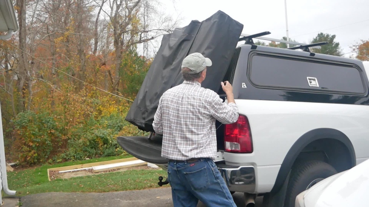

Great designs right here! But if you can lift 125 pounds, there is a much simpler way. A couple aluminum tracks and a strong back. I'm nearly 70 and I do this all the time.
check out the video
