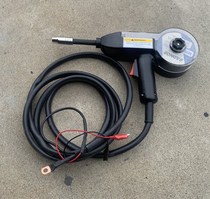

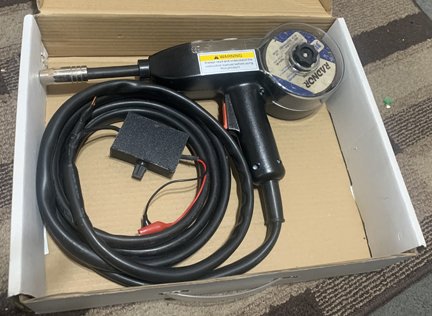

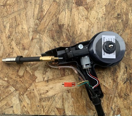

Cheap Amazon spool gun.

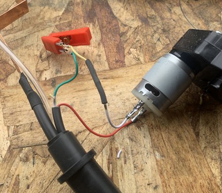

The way these are set up, the trigger is wired to the welder and the welder turns on the spool gun motor. Here I have exposed the switch and motor.
Now to connect the switch to the motor. When I pull the trigger, the spool motor will run.

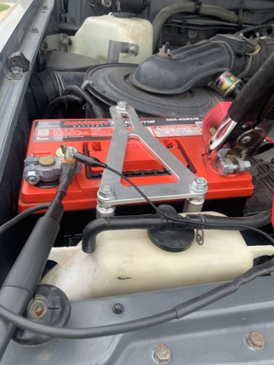

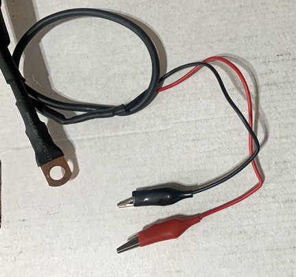

The other end of the cable had two plugs. One large one for the main power and a small one for the control. I cut off the large one and installed a single lug. The control plug was replaced by a pair of wires with small alligator clips. The spoolgun needs to have the wire feed be Negative and the metal be positive because your using flux wire. The main power lug will go to the negative post of one battery.

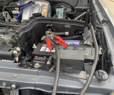

Power lug hooked to one battery, negative and the motor control hooked to both positive and negative on this battery. My red lead ran off the edge of the picture here so you cant really see it.
This is my other battery. I used my jumper cables to tie the negative of this battery to the positive of the other. I'm using my other jumper cable to bring positive voltage to my metal (remember, spool gun must be negative).

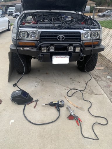

Front view (kinda hard to see everything).

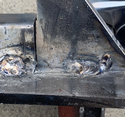

Please don't make fun of my welds. These were quick tacks because it started to drizzle on me. The upright and lower plates are 1/4 inch and the square was 1/8 inch. I overheated the 1/8 inch and had to come back over it. The quarter got good penetration. I was using very old .035 wire.

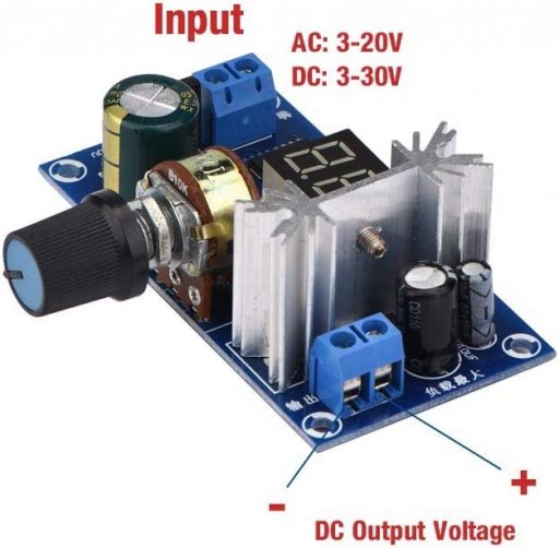

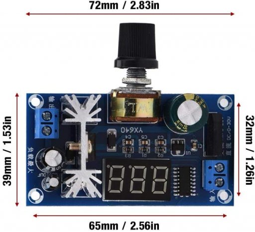

Speed controller
Amazon special. I wanted something smaller I could incorporate into the gun. The only way to make that happen was to build my own. Way easier just to buy it. The only bad thing about the one I chose was, it didnt come with wiring instructions. I had to go to the Amazon picture. Details for the one in the picture below is backwards. I started to let the smoke out when I hooked it up. Fortunately the controller is still good.
I did not get any pictures of the board wiring before I sealed it (sorry). Its basically hooked up inline . I didnt need to see the display because the speed I want is just back a little from max.

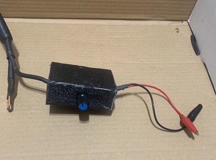

What I have left is, find a nice box for it and get a folding/compact welding hood.

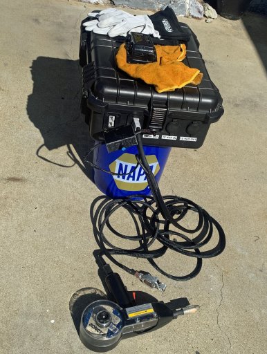

Finished project with controller

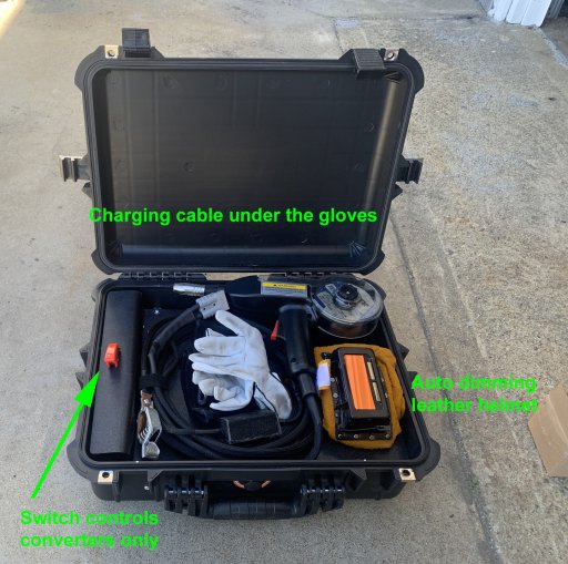

New update.

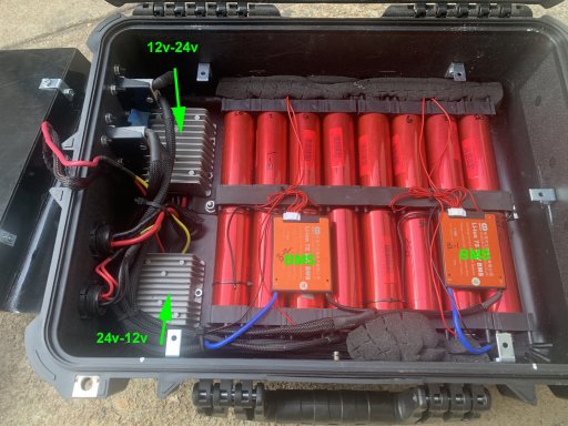

I finally finished the portable battery part. I'm just going to post pictures and not a whole part break down. If anyone wants to build one, message me and I'll get you a part list. You could also use the info to build your own battery bank for camping.
As it turns out, most of the major welding companies had a battery powered welder, a few years ago. They were very expensive and only good for small things. They designed them around their professional machines. Basically, they took one of their welders, added in a battery and inverter. This added weight, added higher cost and drew down the batteries quickly. The people complained because they thought they were buying a welder they could use all day.
Another group builds the Karnage welder. A friend of a friend, did a pod cast with them and they mentioned lithium battery's was something they couldn't get correct. They achieved the voltage using two small 12v AGM's (24 v).
From what I researched, no one seemed to figure out how to achieve high current without resorting to AGM's.

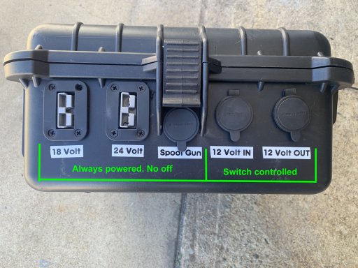

MY build uses Headway 38120 batteries. each is rated at 200 amp's. I use 16. Two groups of eight. The output voltage is 24v (High) and 18v (low). I welded 1/4" to 3/8. The weld was good but that's the limit of a single pass. If I wanted thicker, I would increase the wire size.
18v Is a bit light on 1/4 but rock's 3/16 and 1/8.
Testing the battery pack, I'm getting about 140 amps on high and 110amp's on low. I spent about 20 min's playing with diffrent metal thickness and depending on a few factors it should last 20-30 mins of solid welding. The batteries stayed cool the whole time. That was one of my worries.
I decided having a dedicated 18-24 volt battery was useless as a general battery supply so I added two 12v Anderson plugs. I have a 24v-12v converter. Charging the pack is done with a 12v-24v converter. Everything I've done is set up around Anderson connectors. One issue popped up while I was testing. The spool gun would stop working after about 10 seconds of usage. Whet it turned out to be was the welder was creating voltage spikes. This made the 24v-12v converter angry. Considering the spool gun wants 12v, I tapped power straight from one of the 12v banks. Problem solved. Looking back, I could pull 12v from each bank separately and wire those to my 12v output. The Anderson plug has two outputs. This would work well except the capacity would be in two part's. It would on the other hand eliminate the 24v-12v converter.
The only part I will change in the whole system is my spool gun speed controller. I finally found one that fits in the gun itself. I was going to make it part of the battery pack until I realized I wouldn't have speed control if I just used my vehicle batteries. I will say this. The speed control make this whole thing work very well.
Picture time.

You mentioned you installed a new smaller controller in the gun itself. Would you mind posting that part number and possibly some photos?
I tried a couple diffrent controllers, nothing fit. I would have to have one made. I went to a 10 ohm potentiometer (20 watt?) as a speed control in the main box (for testing). So far it works great. I will probably put that in the gun.
