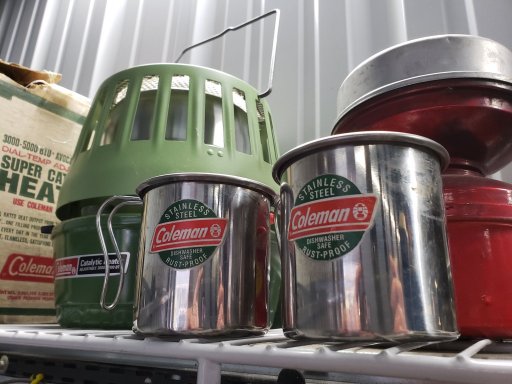

I just got these oldish stainless Coleman cups. Anybody know anything about them?View attachment 144461
All I know is I'm now wanting some!!

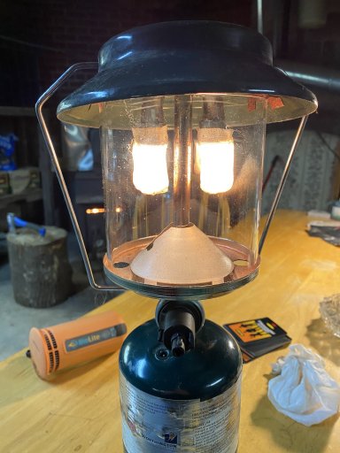

Replaced the generator in my beater 288a to get the leak fixed where it attaches to the valve. I also opened the valve while it was off and blew whatever trash was causing it to leak out so it doesn't constantly push fuel through after it's shut off when the tank is pressurized.
Would removing the pump valve and blowing air into the fuel holding tank be another good way to clear out any obstructions or am I blowing smoke and not understanding the problem ?
It's not actually the pump check that's the issue, it's the seat of the control valve had trash in it and it wouldn't completely seal. If you didn't vent the tank you'd come back to a wet lantern and a really exciting time trying to relight it with the generator standing full of liquid fuel! O_O
Is that seat similar to the seat in a faucet. Duaaaa
