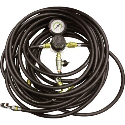

Just wanted to clear some things up here. Air, Nitrogen, Oxygen, Argon, Helium, etc are normally stored in high pressure gas form (yes, I know there are exceptions but not that equate to traveling/Overlanding). Where as CO2 is normally stored as a liquid that vaporizes in the cylinder. This is why when you look at the volume of a normal scuba tank it says something like 80 cubic foot @ 3,300 psi. When referring to a CO2 tank you will see tanks listed as 5lbs., 10lbs., and 20lbs., because you are literally weighing the liquid in the tank.
The conversion rate from liquid to gas from a CO2 tank is one pound liquid = 8.741 cubic ft of gas, so a:
5lb CO2 cylider would hold 44 cu ft. @ 850psi
10lb CO2 cylider would hold 88 cu ft. @ 850psi
20lb CO2 cylider would hold 175 cu ft. @ 850psi
Also, under normal conditions a CO2 tanks pressure will never exceed 850psi. As you use the gas vapor off the top of the liquid, the liquid remaining vaporizes as you go until all the liquid has turned to gas. I find it funny to see 2 gauges (tank pressure & line pressure) on a CO2 system because the tank side will always read 850psi until it's all gone. You can regulate the pressure on the line side via tank regulator conected to the tank valve or with a combination tank regulator and in-line regulator. For example, I have a fixed 150psi regulator on my tank so when filling tires it gets all 150psi line-pressure to the schrader valve, but when using air tools I connect an inline regulator and dial the pressure back to 80-100psi depending on the rating of the tool. I use a digital luggage scale (looks like a handle with a hook on it) to weigh my cylinders to determine how much CO2 I have remaining in each tank. I have also seen people use deep-sea fishing scales with a dial. Any kind of weight scale will work. Just remember to weigh your empty tank with regulator and anything that will normally be on the tank (tare weight) so you can subtract it from what your tank weighs after filling and determining how much you have remaining while on the trail. I always write the tare weight on the tank with a Sharpie.
I just wanted to make it very clear to all that there is a big difference in carrying a 10lb. CO2 tank @ 850psi and a 80 cu.ft. Scuba tank (with Air, Nitrogen, Nitrox, or Argon) @ 3,300psi. While both look similar, both carry about the same cubic feet of gas, and both will scare the holy crap out of you if the valve gets knocked off, the high pressure 3,300psi is more apt to seriously harm or kill you. When I was working as a high-rise welder there are tunnels in New England that you cannot drive your welding truck through because you are carrying high pressure gas cylinders. Believe me, they are no joke if that valve gets hit. Just be careful and do your homework, know what you are putting in and on your rig!! And for goodness sake, have fun.........
