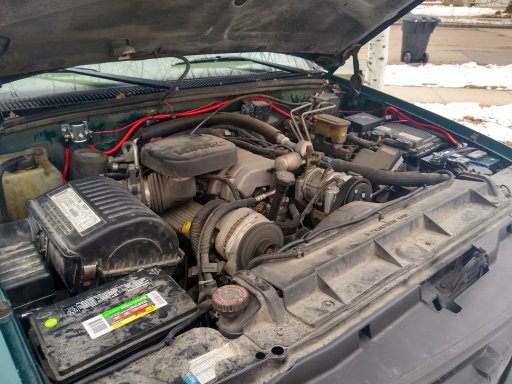

Couple updates: got my "isolated" dual battery system in. Luckily there was an existing tray unused (it's there for the diesel option) so that made it easy. IMG_20210129_114806807_HDR.jpg

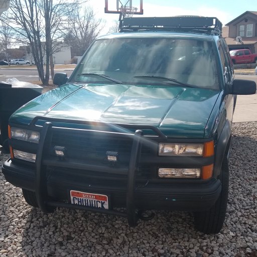

Pulled the CD player to mount switches for lights.
And I cut the "wings" off the grille guard I had picked up at the tear-a-part, fabbed some "custom" brackets out of 3/16" bar steel (meaning I cut it, whacked it with a big hammer, drilled out holes) and mounted it with grade 8 1/2" bolts and lock nuts. Mounted the flood pod lights on what is now basically a push bar.

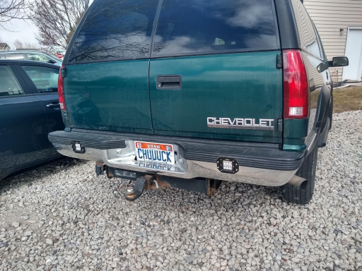

These lights are connected to the sasquatch switch. Rear lights and roof light bar still need install. Started working on cutting the rear bumper for those lights. I'll pull it off when i have that worked out and hit it with a coat of bed liner before final light install. More fun to come...
