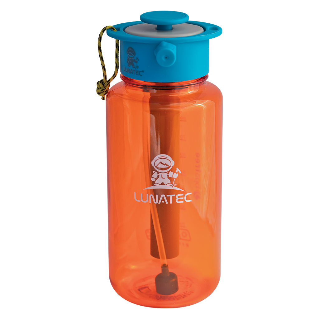

This thing is simple and amazing. I have tried many other showers and this is my favorite. Amazing how much water you can save. I also use it to rinse off dishes.
I have one of their prototypes that I love. I keep it in my DD for cleanups and after beach foot washings. It goes on trips for dish rinsing.

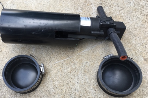

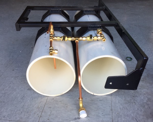

We have solved the shower issue in a relative inexpensive way. It is an outdoor shower and has 2 tanks of 9 gallons each in the location of the spare of the 80 series Land Cruiser. The tanks are made of 8" schedule 40 PVC pipes with caps. There is a pressure reducer from the air tank with a one way valve that pressurizes the tanks. The rear heater was removed from under the passenger seat and the plumbing was used to heat a heat exchanger. It heats up 9 gallons to 125F in 20 minutes when the engine is warm.

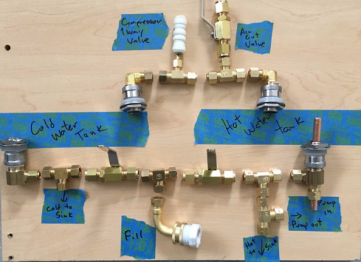

The water system looks like this...
The fittings are standard. The exception is the fitting on the bottom right of the pic. It is drilled and tapped so the pipe that goes up feeds the hot water from the pump and the outlet that goes to the left comes from the bottom of the tank to the pump and the shower. I was trying to drill as little number of holes as possible on the PVC.
They tanks support up to 140F. The frame for the tanks was welded from $15 worth of steel.

The rear heater that resides under the passenger seat was removed, and the two pipes that connect to it were used to connect to the heat exchange unit. If I had to do it again, I would have used this unit which is more compact and will take 40 minutes to heat the water instead of 20 min, but we always have time. :)

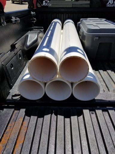

I hate to necro this thread but 'm currently brainstorming on a water system for my square drop. I recently came across a FB marketplace deal that I couldn't pass up and now I'm hoping to add a little bit of a solar warmed water system. I'm wanting to stay away from pressurized systems and do some sort of pump that I can power with 12v. I previously had a waterport and loved it for the first year then for whatever reason it stopped holding pressure and the hand pump quit working as well.
So I got a 7.5 foot long x 6 inch piece of PVC that already capped off on one end and 5 pieces of 5 foot the same diameter. When I bought it the guy had advertised it as suitable to pressurize and was planning to make a hot water shower out of it. In my excitement I didn't realize until I got home the pipe specifically says not to pressurize on the side... oops!
so all of that said I'm trying to figure out the best route to add a 12v pump to and use it like that! I'd just be using it for spraying the dog down, possibly a quick shower for my wife and girls. I already have a 15 gallon water tank in the galley of my square drop for dishes and such.
Suggestions?

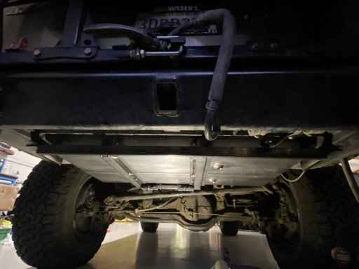

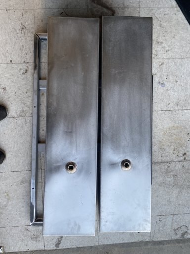

Did an upgrade on the water tanks. Round 17 gallons PVC to 25 gallons square stainless. Everything else stayed in place. Had to reroute the end of the exhaust a bit.
