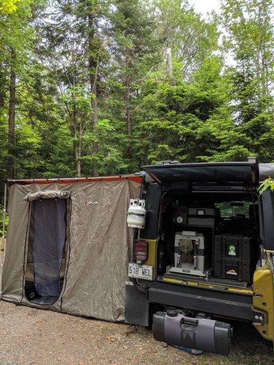

Testing hot water setup. Now to make or buy shower enclosure.
This is the exact type of water system I'll be building. I have a black Diamondback cover on the back of my truck that gets hot in the Florida sun. I'm going to find a water tank solution that I can mount on my Diamondback cover, make sure it is also black and that should heat up the water good on Sunny days when outside of Winter time. When it does get cold I plan to have a gas water heater on demand like yours. The only change I would recommend is put a Y on the water coming out of the pump so you can direct water one to the water heater and then another way for cold water, that's my plan. I have lots of ideas on how to improve my truck for Overlanding but most of them aren't free!

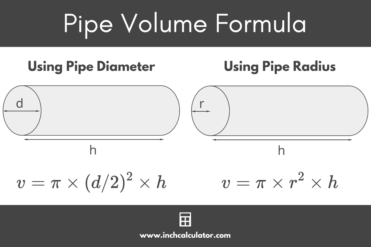

BTW, here is a link to a pipe volume calculator for those of using PVC or other pipe for the water container. I have 63" of width on my Diamondback cover to use for a water tank and a 6" PVC pipe gives me 7.7 gallons of water, not bad.

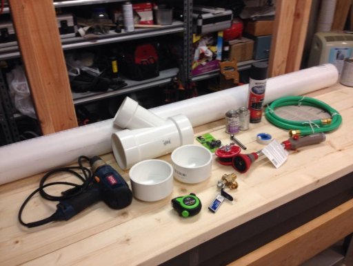

Found at Roof Rack Shower for Outdoor Activities
5" PVC pipe (Im building a 5"d x 60"l = ~4 gallons)
1- 4" to 4" to 4" junction
2 - 4" PVC end caps
2 - Tubeless tire valve stems
1- Single outlet ball valve
1- 3" Pressure test cap
1- Hose sprayer
Length of garden hose
PVC primer
PVC use thread tape
Spray paint (Obviously the darker, the warmer the water can become)
I fill mine with a 10lb CO2 bottle to about 18lbs psi. Pipe should be rated to 100 psi but with the ball valve seat, I didnt go any higher.
Open 3" pressure test cap, fill with water to the bottom of the angled PVC. Replace cap, add CO2 to pressurize. Install hose/handle, open ball valve, squeeze handle and smell clean again!

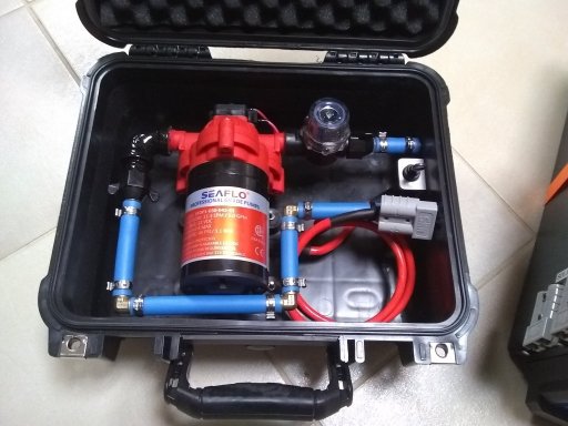

Over the past 40 years I've used everything you could imagine to take a warm shower while boondocking. Now that I'm using a RTT mounted on a small trailer or on the cap of my truck, I can step up my game a bit.
I built a solar charged "battery box" to run a "Pump Box" i built and use a Eccotemp 5L portable on demand propane hot water heater. As good as the shower in my house!
What is the blue hose, is it Pex?
