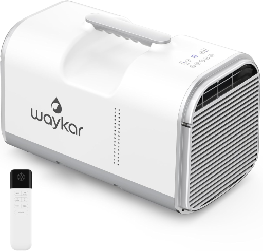

portable air conditioning unit i can take camping. unfortunately it is more of an idea than it is a reality. compressors and heating elements are just power hungry by nature and that is why electric heating and cooling is not something that is currently going to work well off of a battery. i'm sure in time there will be a tech breakthrough that will allow for it...but until then, i have found only one solution that works.
