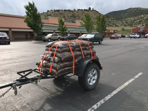

I recently went through this same thought process. I don't have 5 grand to spend, let alone 10 grand to buy a trailer (though I suppose I could finance it, but don't really want to go down that route, with two car payments and a mortgage), so the decision was pretty easy for me.
Unlike you, I don't have the skills or equipment to weld it using steel, so I have to go the wood route. While it's not ideal, I figure what the types of trails and routes I'll be taking, wood will work just fine.
The idea of having a trailer that's always ready to go is very appealing to my wife and I, since we love to get out and go, but currently it takes me many hours to collect all the equipment, and get it loaded into the rigs (and we currently take two due to space, and gear, and the fact that we both love driving).
The question is.....if you look at what's available in the $10k range, can you build something much better for less? If the answer is yes, the to me, it would make sense to build your own, even if you start from pre-done frame.

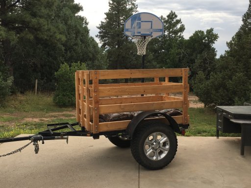

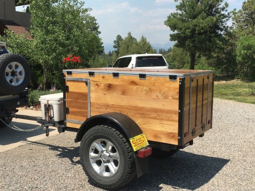

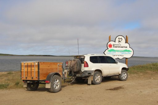

I find $10k to be a lot of money to spend, but I do love my trailer. I think since 2014, I have about $4-5k in it.
I was lucky that a friend built the frame based on his M416 trailer, another friend helped me build a box from plywood to look like a M416 box. In 2017 I built a new box out of Hickory wood (tongue and groove for sealing and strength), the tongue hitch slides up to 3’ for adjustment in towing and I just purchased a new axle because I bent the old one. This trailer has over 50k miles on it, two trips to Alaska, the Arctic Ocean, a lot of the mountains in CO & NM and trips to Texas and the Midwest. I use matching wheels with my vehicle and when I replace the vehicle tires, I do so at 5-6/32 of tread and then use the older tires for the trailer.
Now, I use my trailer to carry stuff, camping gear, supplies, etc. When I camp with my friends, we set up a central cooking, eating and sitting area, so to have pull out stove and sink or whatever it’s not what I want, I want it portable. This year I will add a smaller box to carry my older ARB fridge and mount my RTT to the trailer.
One more thing, I can remove the box on my trailer and use it as a stake box or flat bed to carry other stuff, like a load of fire wood, a pallet of pavers, etc.

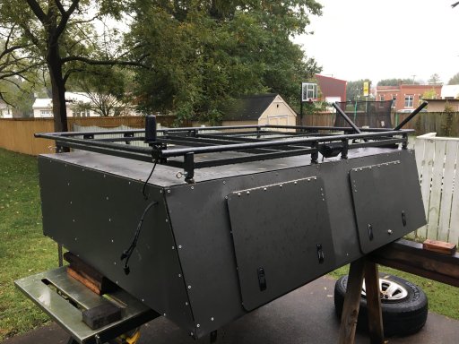

We've decided to build our own. I built this cap for the Toyota, then sold the Toyota. Tried to sell it but as I already knew, it's hard to sell a one off piece. So.....I'll build a bottom and put this on top. Cost should be minimal. If you have the skills and the desire to ask the right questions, build it yourself. You'll be much happier than slamming 6-8 stacks down on the counter for something you have no control of.

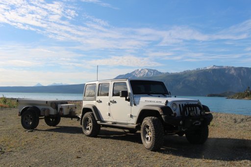

Including the cost of the original trailer (4x6; Carry On) I have a bit under 4,000 dumped into it, ending up with a heavily modified, overbuilt, lightweight trailer, 1500 lbs loaded. It does go anywhere our Landcruiser will go. I cannot weld, but I have friends that do. A year ago we were in the San Rafael Swell with a friend that rented an “off road” trailer that retailed for well over $20,000. It was big, heavy and cumbersome. What struck me though was how poor the fit & finish was. Hardware was rusting, drawer & fridge sliders were weak and flimsy, and the water heater attachment points had failed. Gaskets were flopping around as well. I figured normal wear & tear maybe after a few years, but no, the trailer was less than a year old.. here’s mine. Build your own, would be my best advice.
