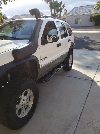

So, today I finished extending the breathers for the diffs, Transfer case, and Transmission. Although I have no plans to really submerge the jeep, a little piece of mind is worth the $0.69 a foot for tubing. The 545RFE and its variant on the V8 have a dinky little breather which just dangles across the top of the transmission, so moving it up was a must. The transfer case and front diff were both lengthed moderately from the factory, but I extended them up to meet the other two. I relocated the rear diff breather to run to the front, as I had enough breather hose to do so, and the oem hose was stretched and wrecked anyways. Eventually, I'll pair all 4 breathers into a filter kit, such as ARB's Universal Breather filter.
Eventually, I'm gonna snorkel the old girl. Not so much because of water, but because the dust factor out here has such an impact on filter life, and many African expedition vehicles are equipped with them for just that reason. By moving your intake up, you supposedly take in less dust, at least that's the hope. And with extended breathers, if I ever do need to so a "moderate submerge" I don't need to worry about the transmission turning into a strawberry milkshake dispenser.
