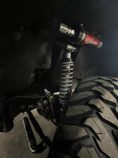

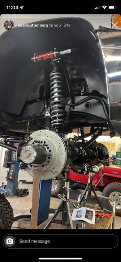

Foxes are on:
-TJ

Foxes are on:
-TJ

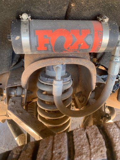

Heck yeah, you’ll love them. I have a set of fox shocks that were on my 14 Silverado and that’re now on my 17 with about 300k miles on them now. Zero complaints and would buy them again.
Reactions: dp454so and tjZ06

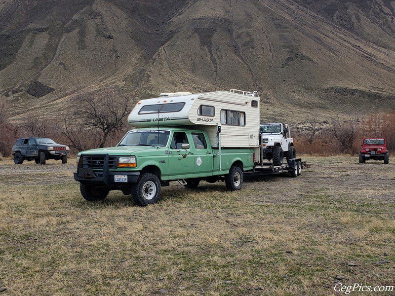

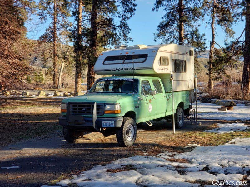

My full size. 1996 F350 460ci, 5 speed, 4x4. Mainly a tow rig for Base Camp 4x4 trips.
LOVE this setup. My uncle had a standard cab blue and white F250 with a cabover that he had the blue stripe on so they matched......would love to find a decent one of these to make a project....

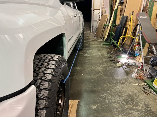

Finally did the "Norcal" mod to fit the 305x70x17's KO2's and man, I should have done this ages ago. Was concerned that I would have to pull the coilovers off and crank up the preload (i.e., lift) but the tires fit with no rubbing and the King EXT version shocks are in their sweet spot for both up and down travel.
It rides very different and like a truck should ;) The 6.2 still has more than enough pull to turn these easily but I might look into a tune or even gearing to get some mileage and torque back, and to keep some strain off of the trans. If I can find a decent kit and/or parts, may even build and add a trans cooler.
