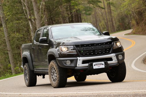

So back in February '21 I started this infamous thread: Trying to select the correct vehicle for first overland build and ended up buy a Colorado ZR2 Bison in Black. Name is partially a tribute to my dad, who sadly did not live to see this truck (he named his old Silverado Betty, presumably after Betty Grable). Here she is bone stock (actually I think it's got the stubby antenna):
(Yes I paid Killboy for my Tail of the Dragon photos lol).

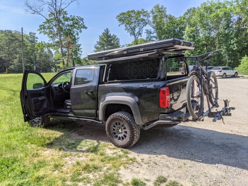

I don't want to get too much into my sleep setup (there are tons of videos on youtube on how to install this rack, it's pretty simple)
Here are a couple of pics with just the rack:
Honestly not a bad solution if you want to just carry a bunch of stuff; Gear pod, traction, water, etc. I have seen a few builds use this without a tent.
Getting the tent on required 3 people, although you could probably get by with two (Roofnest Falcon is only 140 lbs, but its also ~7' long so it's kind of a big lever). Was able to get some vaccinated friends together to help, but I'm 100% leaving it on year round (no impact to my normal driving MPG). It does slightly hurt the handling, but not enough that I care. Takes corners well, but I feel like bumps are *slightly* harsher.
Here is the full setup during a shakedown trip to New River Gorge:
Took it on one of the OHV trails there (actually I think it's not even technically OHV, but it would be a bit much for most cars): https://www.alltrails.com/trail/us/west-virginia/new-river-gorge-off-road-trail
Roofnest is very comfortable and I love the headroom. I know there have been some mixed reports on quality but I can't comment yet. It does seem fine in the rain. Overall, I absolutely love the setup/takedown time: 10s to set up, 1 minute to take down (assuming its already empty).
