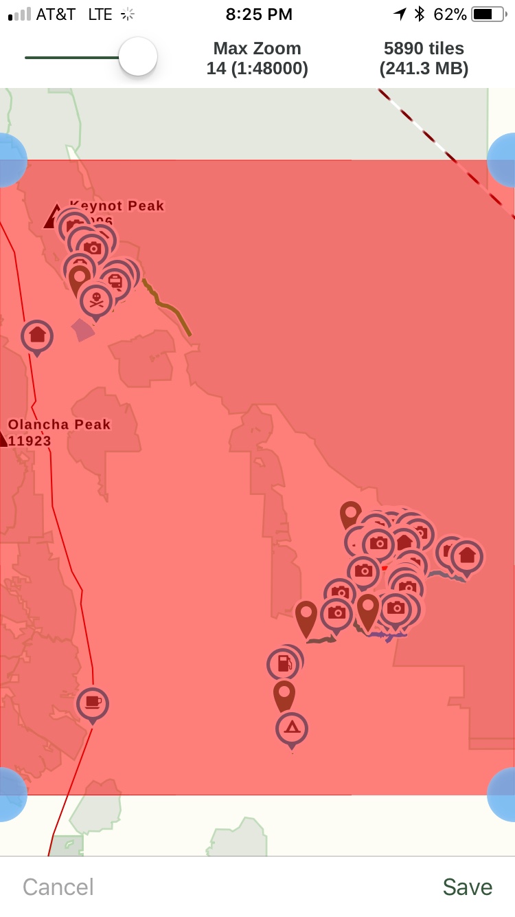

1. When downloading the map for an area, do I need to be on the layer that id like for it to download? For example, I’d like to download the Gaia Topo and the USFS 2016. I have inputted my waypoints and created the tracks as seen in the picture.
You need to select the map layers you want to save and then save them. Another option if you have a track is you can download along a track. Many times this is good enough and a faster method for longer routes. Especially if you don't plan to deviate. Yes plans can change but you might download a very detailed map along the route/track and less detailed for a large area that still gives you some detail.
