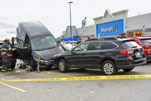

i think most vehicles will hold up just fine "overlanding" in the united states...
its crossing walmart parking lots where they are put to the test...
I would love to see the poluce report and interviews on what happened for this one. Cameras would be useless since they dont work at walmart.
