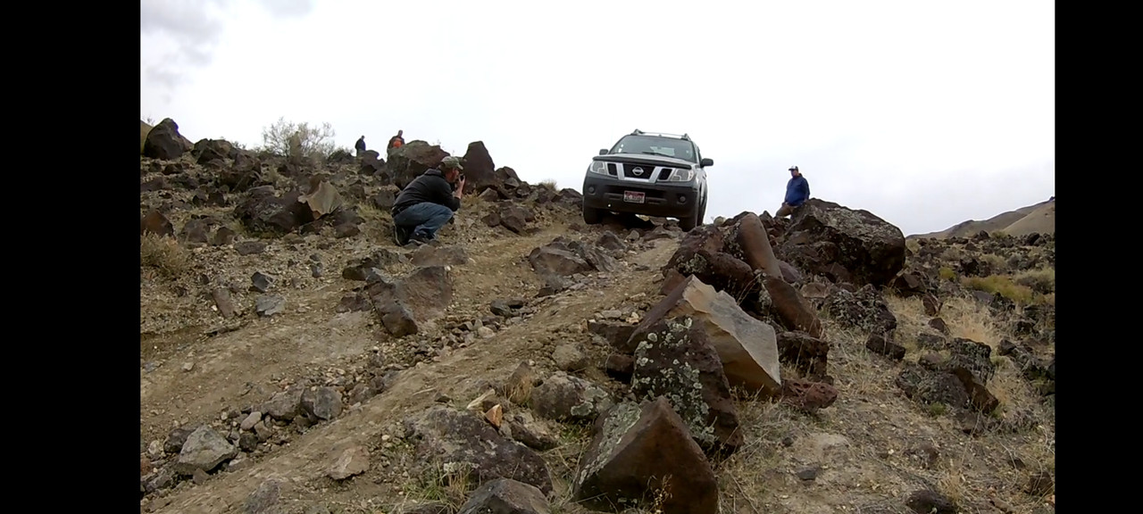

Your tires are plenty big enough. Also, those rugged treks will be just fine. My frontier (which is NOT my dedicated overland rig, but still sees plenty of off road use) had all season tires on it until about four months ago.
My wife wheeled it down this hill on all season tires:
No punctures or traction issues. And no, she didn't break the truck. Only a damaged plastic mudflap (and a very proud husband).

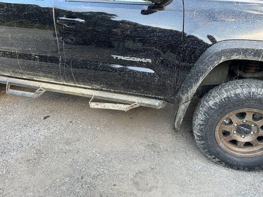

Yes, They are big enough. The stock tires were big enough, well....until you bolted on the Amazon steps. Those gotta go. You WILL catch the steps on something and bend them. Or, as to gain confidence you will eventually hit the rail portion on something solid and bend the lower rocker. Function first!
Tacodrew22
306
Michigan, USA
Andrew
Haight
Those are the factory steps. And yes rock sliders are my next mod. I already have a full set of skid plates on the way!

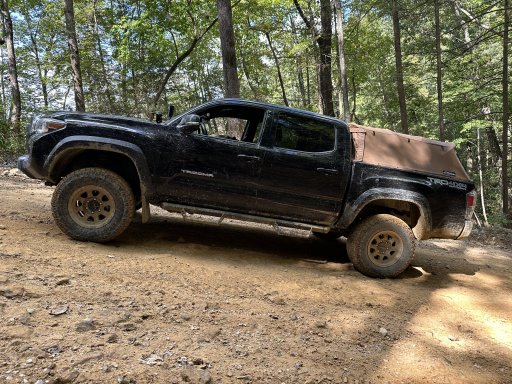

I thought this may be a good time to give a nice update on this thread. After 1 full year of wheeling a lot. I was wheeling hard and I can confidently come back to this and say that my wheels were plenty for what I encountered in 3 states. Did I find some moments where bigger would have been nice of course. I got to wheel all throughout Michigan, West Virginia, and Kentucky. I had such an amazing time in the process and it has been amazing thought I’d share some photos! IMG_1260.jpegIMG_0046.pngIMG_1256.jpegIMG_1217.jpegIMG_9926.jpegIMG_9852.jpegIMG_9639.jpegIMG_9882.jpegIMG_0721.jpegIMG_0780.jpegIMG_1204.jpegIMG_1211.jpegIMG_1215.jpegIMG_9929.jpeg

I thought this may be a good time to give a nice update on this thread. After 1 full year of wheeling a lot. I was wheeling hard and I can confidently come back to this and say that my wheels were plenty for what I encountered in 3 states. Did I find some moments where bigger would have been nice of course. I got to wheel all throughout Michigan, West Virginia, and Kentucky. I had such an amazing time in the process and it has been amazing thought I’d share some photos! View attachment 267084View attachment 267077View attachment 267085View attachment 267083View attachment 267082View attachment 267080View attachment 267081View attachment 267079View attachment 267076View attachment 267075View attachment 267074View attachment 267073View attachment 267072View attachment 267078
Great photos! It's awesome to see a new member getting out and adventuring, hopefully with greater confidence and skill thanks to the useful input of many here.
Once you cut those useless steps off, depending on how those rails are bolted onto the truck, they will probably make decent sliders at least for the time being - they look pretty solid.
