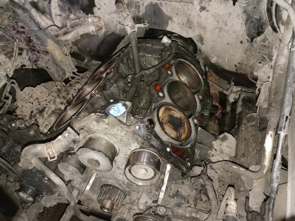

So a few things have happened, as you can see the heads are off. Everything went pretty smooth, until one of the head bolts snapped in the block.. It broke off about 2" below the deck surface, and since drilling it didnt go well I will be helicoiling the hole and using a shorter bolt. Not exactly what I want but it should work.

So the truck was put back together but something wasnt right. Then it started leaking. So the heads are coming back off and quality headgaskets are going in. My headbolt repair seems to be holding though. I put 2 helicoils in the hole and used a length of 7/16 hardend all thread that I also JB marined into place. It held the full 46 ftlbs.

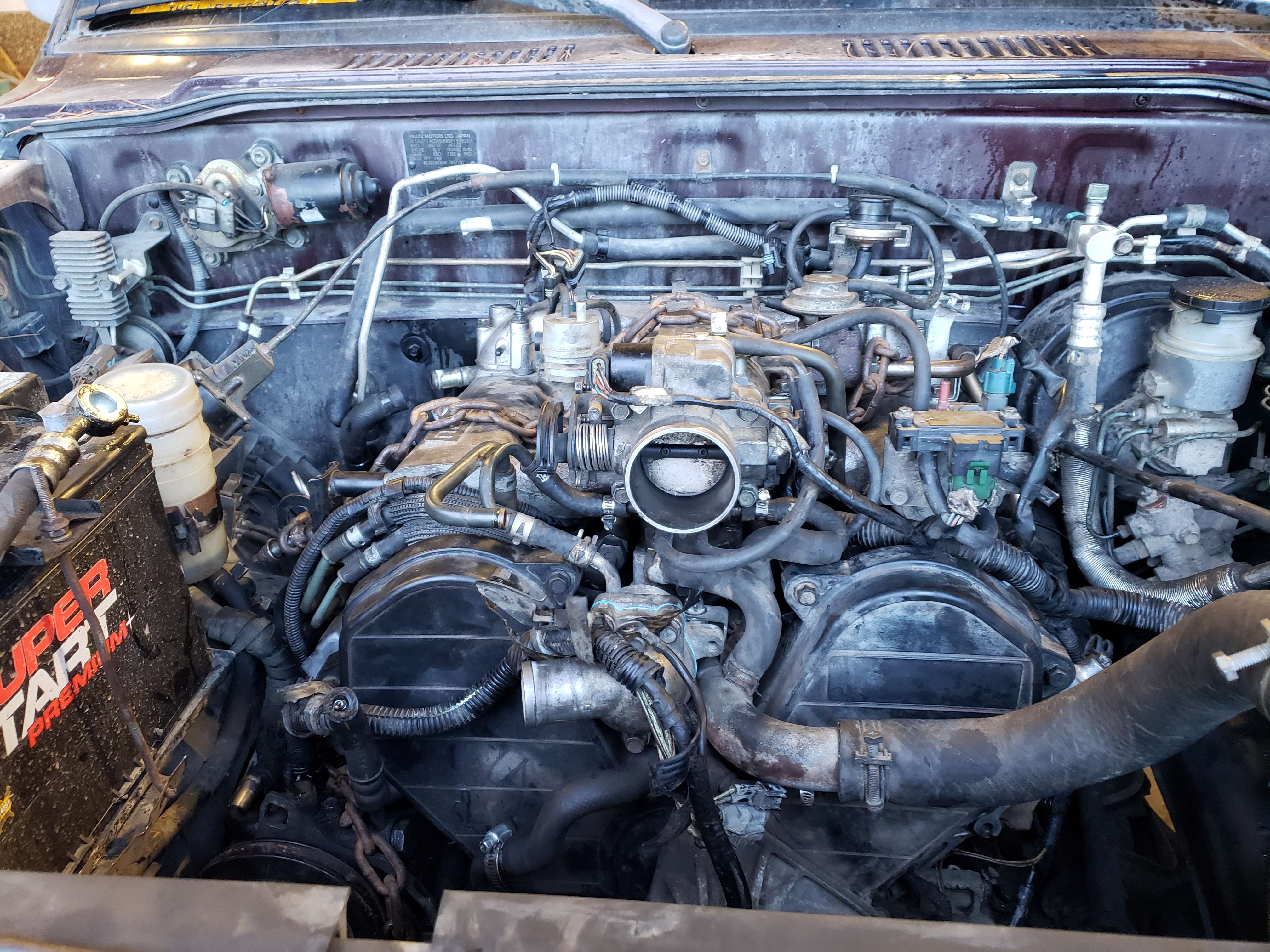

OK still here still wrenchin on this thing, its gettin to the point I can actually take it places.
First I had to solve my engine issues. so I replaced the engine.... and the transmission.
Out with the old.
In with the new. Resealed used motor with 119k. Backed it up with a resealed trans with a mere 64k and new clutch.

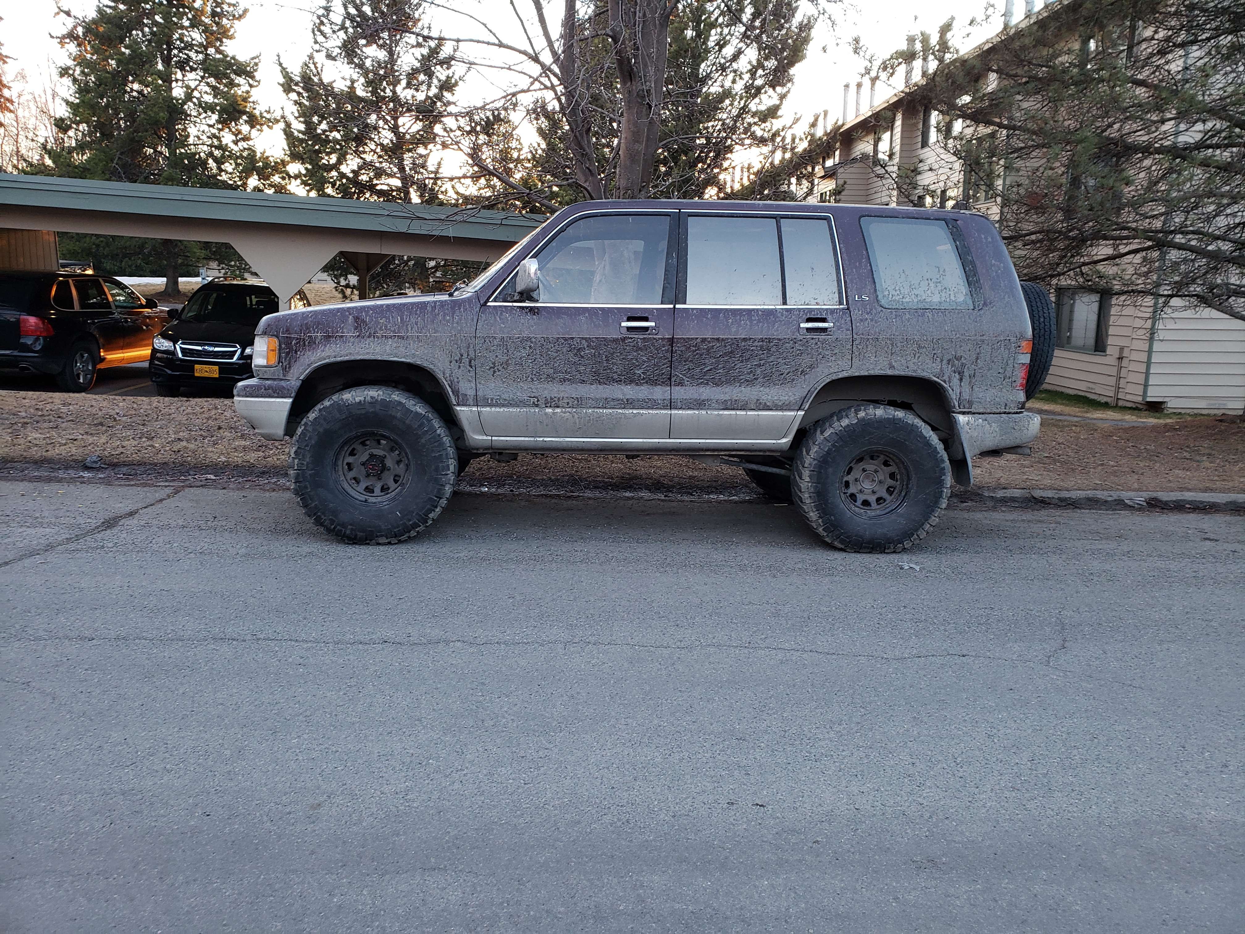

About 7 months ago I sold the 33" K02s. I needed the cash to go to school.
Its ok because I now have 35s

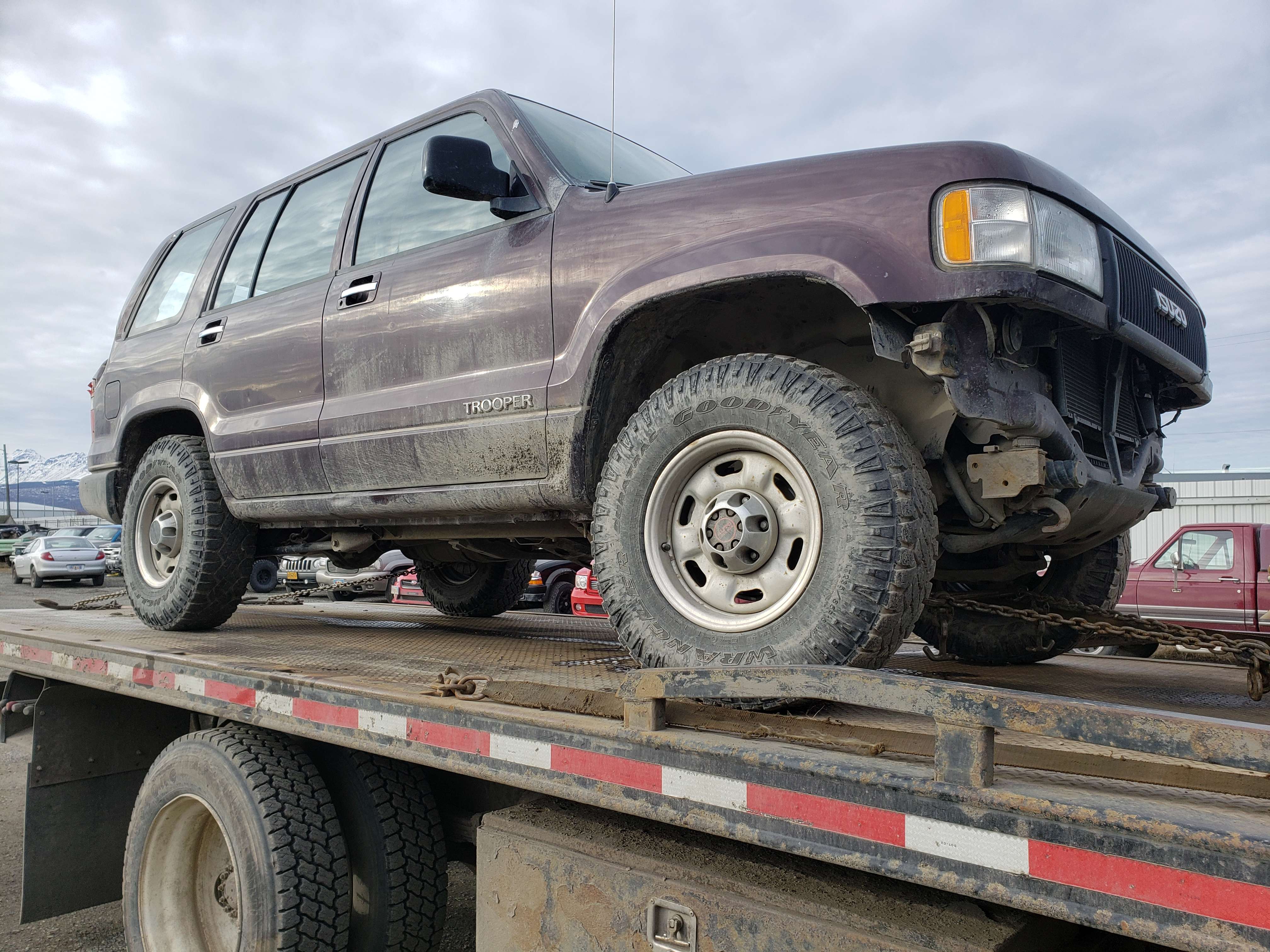

And on monday I bought this

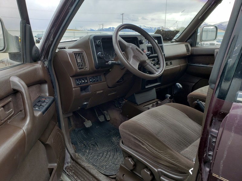

This is a very clean one owner truck that was passed down to a teenager who promptly drown the motor and now its locked solid. however, it has a very clean interior and lots of little parts my truck is missing.

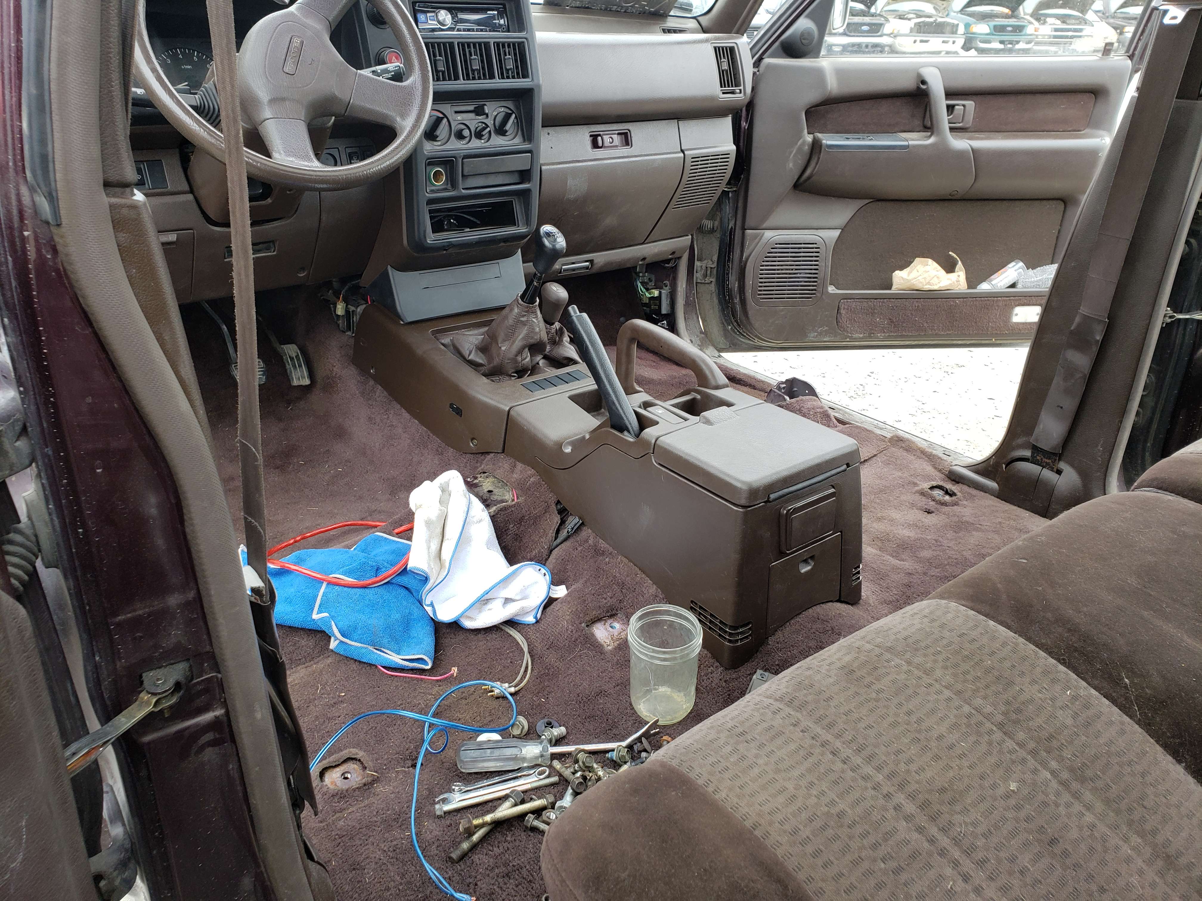

Today I pulled the interior out of the parts rig and pressure washed the carpets. I am going to clean and compare all the parts and put all the best ones back into my truck.

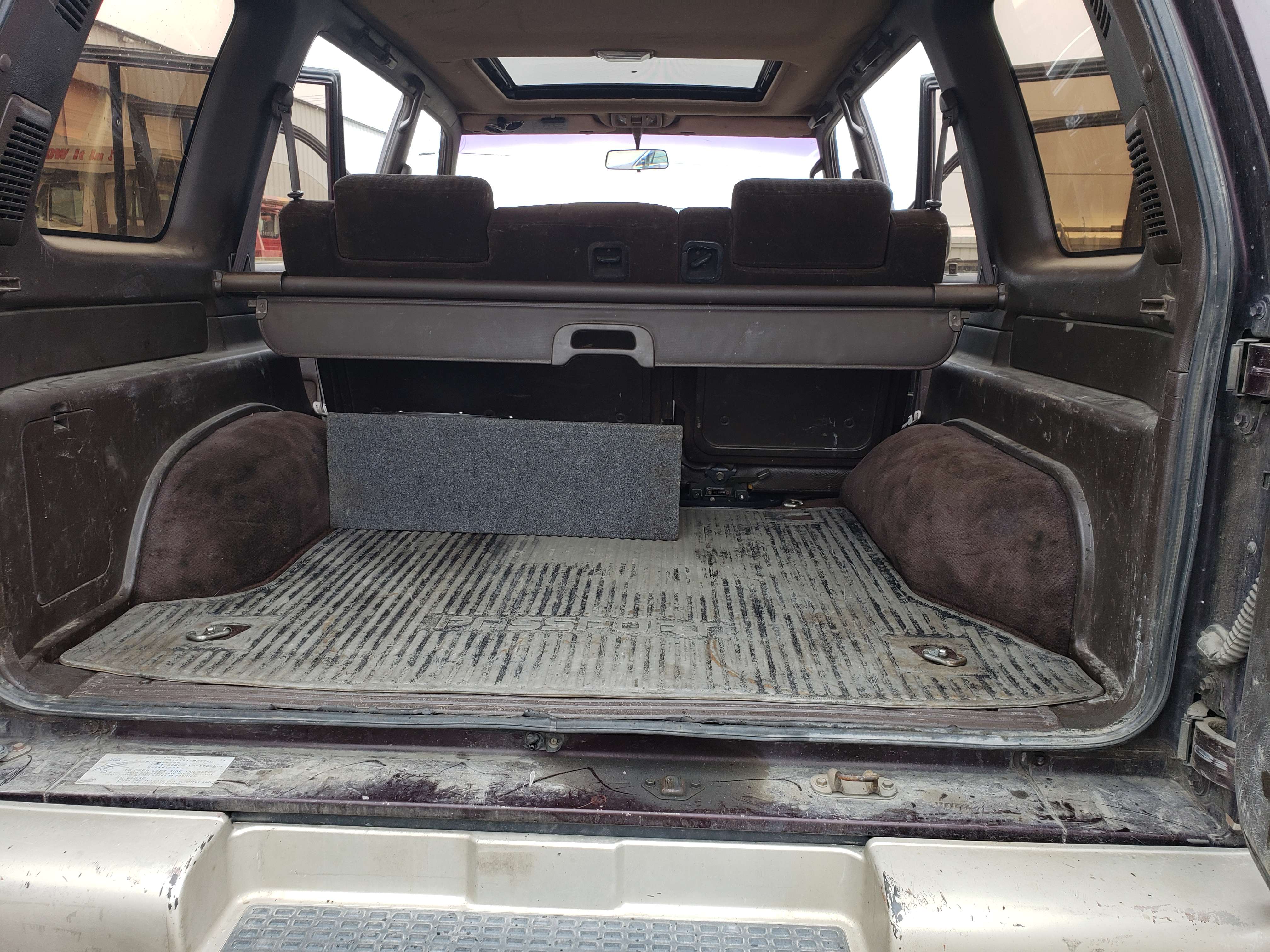

Pulled the carpets from both trucks and pressure washed all of them and re installed the best sections. thankfully the carpet is a 4 part setup. The rear passenger side carpet was nearly gone from a previous owner leaving a battery back there.
They are still stained in places but most of what the camera is showing was easily vacuumed dirt.
every piece that came out went back in after a good scrub.
even found a cargo liner from a passport that happens to fit. its ugly from some previous person painting it black but since I keep a bunch of tools back here it will protect the cleanish carpet/

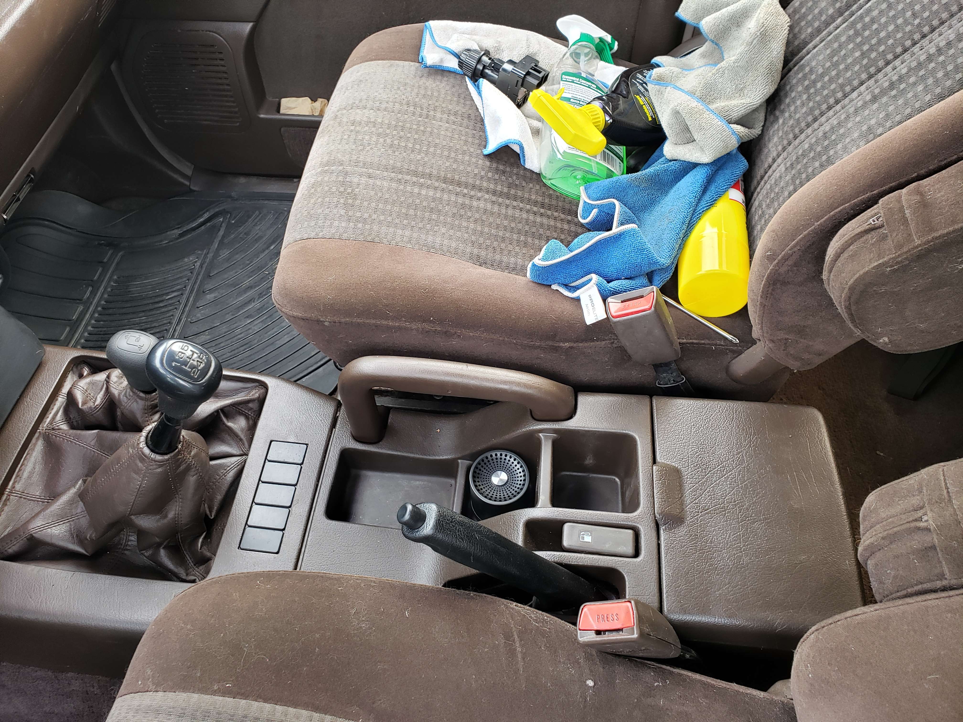

this center console was nearly a bio-hazard when I started.
After every thing was put back together the rest of the interior plastics were cleaned and detailed.
much better place to spend time now.
