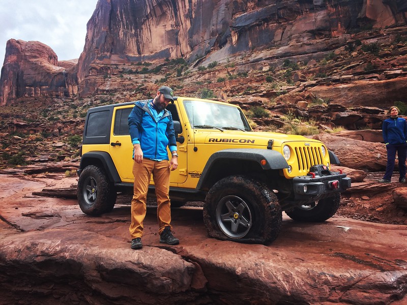

I used to air my 35x12.50 BFG KO2 down to 10-12 PSI with non-beadlocks. I now stick to around 12-15 PSI, since this happened on Moab Rim at 10 PSI... By the way, an ARB Twin compressor can set a bead. Ask me how I know...
Doh, that's a bummer. Glad you got it re-seated and were able to drive out without switching to the spare.
I have my Staun deflators set to 15-18 psi and have not had any issues or found the need to go lower (no beadlocks).
