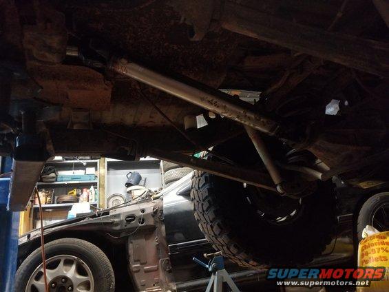

Well I hope it works well. Getting the driveshaft built tomorrow so hopefully driving it by this weekend. Gonna be wierd without the old 90hp motor lol

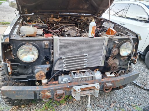

Grill and accessories off the front, going to freshen everything up and repair these rust holes. Possibly going with LED headlights, anyone have experience with the cheaper ones??
I have now halogen lights but I think the LED would be a major upgrade.

@Urban gorilla Yeah, my experience is that everybody I've known who has bought cheap LED's has regretted it badly. I can't speak for the higher-dollar LED's, pretty sure Sylvania makes LED bulbs, but I use Sylvania HID's in all of my vehicles when given the choice.
They aren't the whitest, they aren't the brightest, they consistently last about 2 years at best. They also don't have a flicker rate that causes motion sickness for other drivers and triggers seizures for pedestrians like those obnoxious LED's (don't know a brand name) everybody puts in their Camry's and 4Runners.
Please be aware that "more" light is not always desirable, and blinding LED's are unkind to other drivers and pedestrians, and in some locations lights considered "blinding" or "dazzling" are against the law.
I get bright flashed almost every time I drive at night in my Explorer, but I flash 'em back and they understand that if I wanted to blind them, I could. You might run into this once you put better lights on your rig, regardless of LED, HID, or any other upgrade you should decide upon.

I'm a big LED lighting nerd, and you really have to do some research when converting.
I'd recommend the sealed beam replacements from JW Speaker, but they're pretty top-dollar.
The big issue with LED headlight bulbs is that while they're bright, they don't have the focal intensity of stock assemblies.
Effective upgrading means also going to a projector style assembly like in an HID application. Something that will concentrate and focus the light while also providing a good cutoff so you don't blind people.
My other recommendation is to use warm white or slightly amber tinted LEDS. Cool white lighting kind of blends in with the bluer tones of early evenings and early mornings and makes me feel like I'm flying blind.
Anywho, I'm loving this build. The Montero is a really rad design with a good chassis that is easy to mod. I'm looking forward to where this goes.
