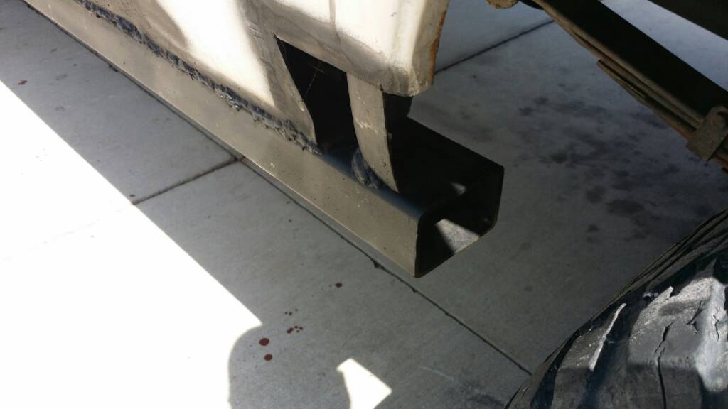

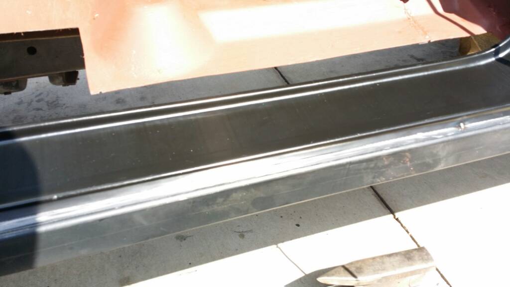

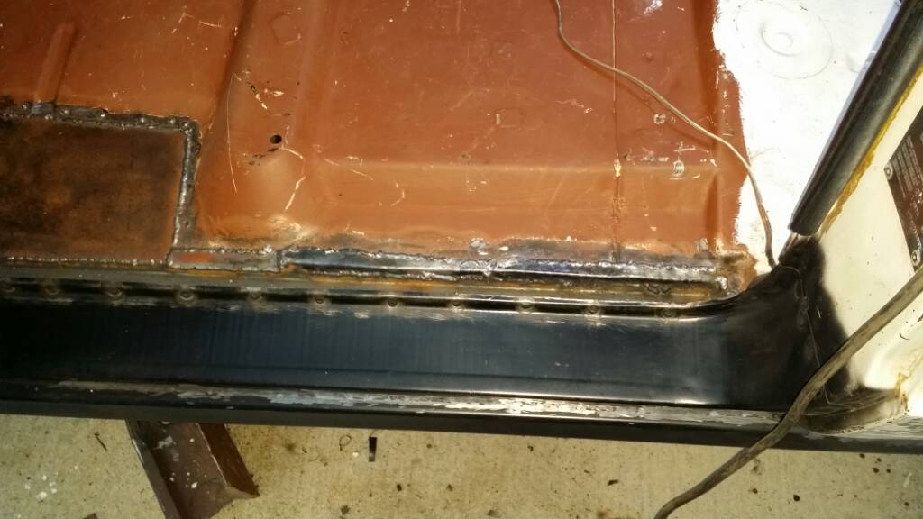

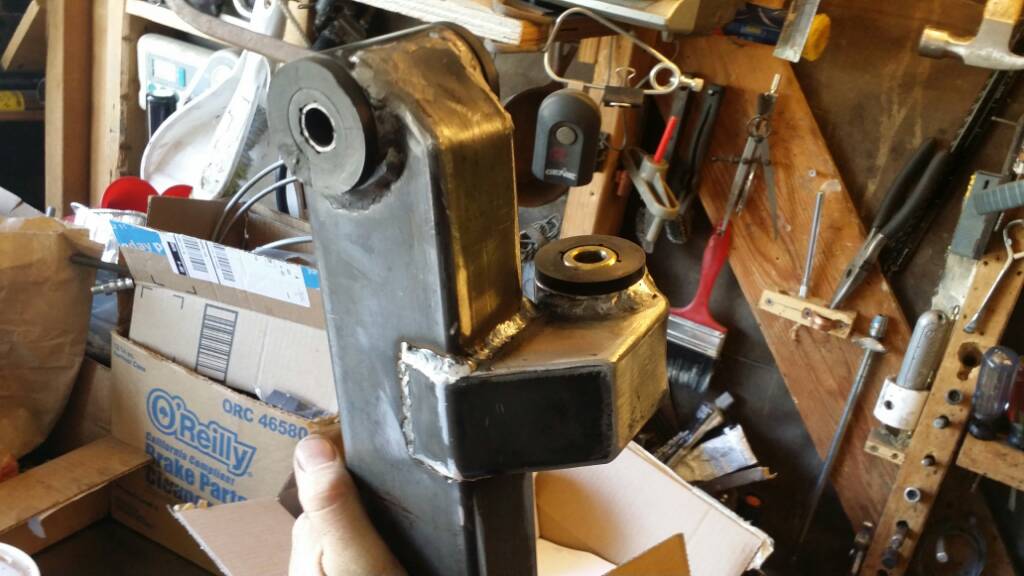

I'm running an ho72 which was the predecessor to the 14bolt. It has 3 pinion bearings like the 14B and has a bigger pinion shaft. it has a drop out 3rd member like the ford 9" and a cover on the back. Better clearance than a 14 as well... the ring gear is 1/4" smaller in diameter though.

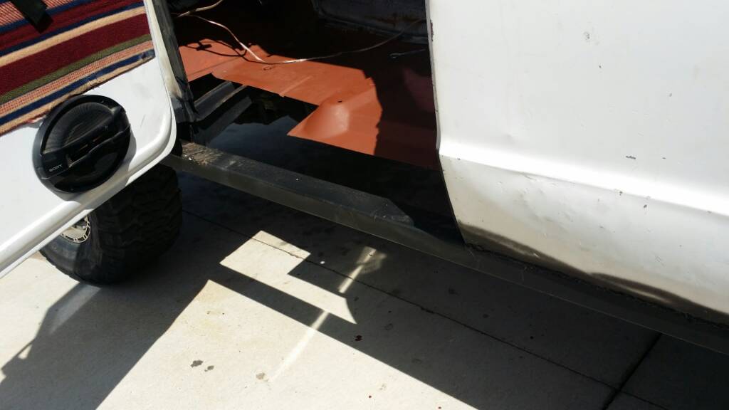

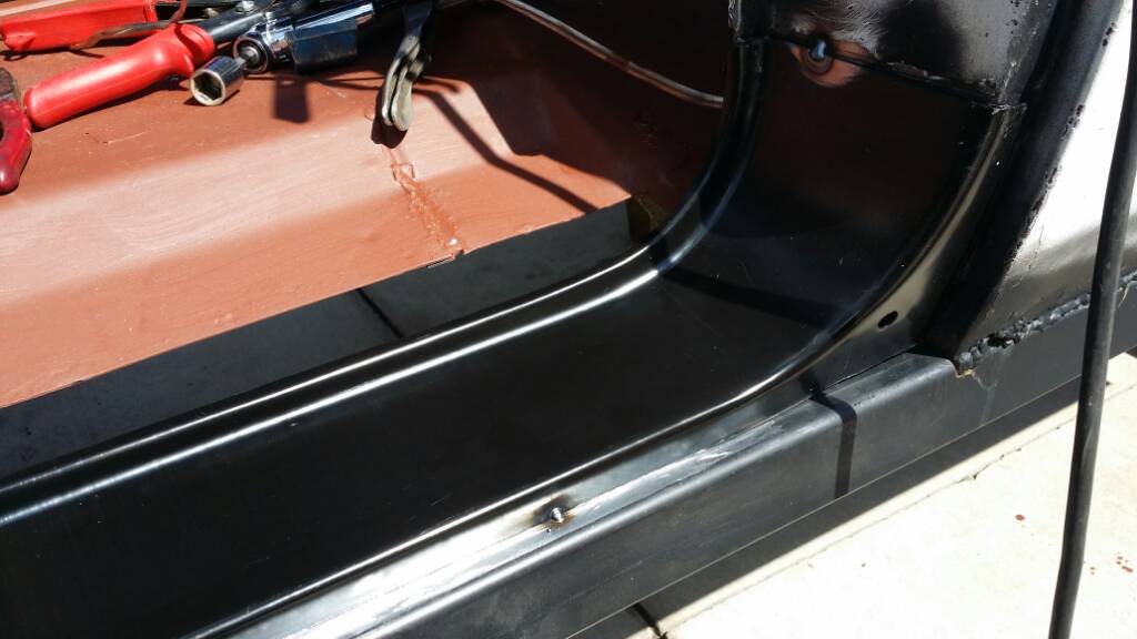

I actually welded in 2x3" rectangle tubing instead of buying new rocker panels when I did all the sheet metal work. They work great and are up nice and high. The down side is that they're welded to the body and not bolted to the frame, which isn't a problem as long as my body mounts are in good shape. (Which they're not). I'll be replacing them in a week or so.

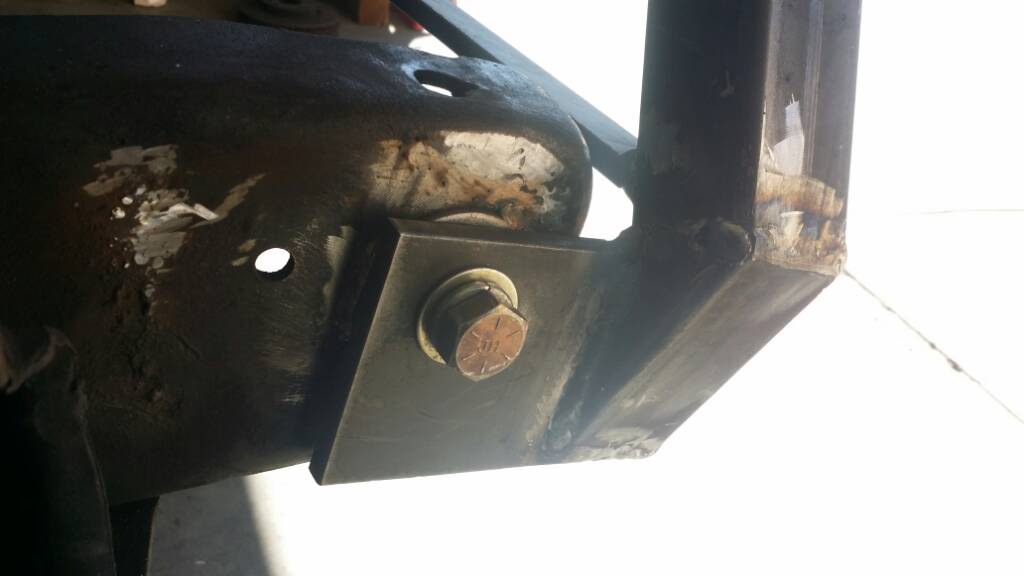

I went out to Santa Ana on Wednesday to finalize my order with Jeff the owner of Deaver suspension. I'm pretty stoked about it! I'm gonna have 10-12" of travel up front and 14-16 in the rear. Now I need some good shocks to accommodate all that suspension. I've been looking all around for some used King bypass shocks and 2-4" gas bump stops. I can't believe how much those things sell for?! Yikes!
The good news ,if ya wanna call it good, is that my Deavers are 6-8 weeks out so I can sorta spread out the sticker shock a little bit.
It's a good thing my wife isn't on the forum! Lol! [emoji85] [emoji86] [emoji87]

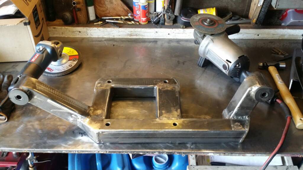

Today I started fabing up my cross member for my 203/205 doubler... installing this thing is gonna be a pain in the @$$!

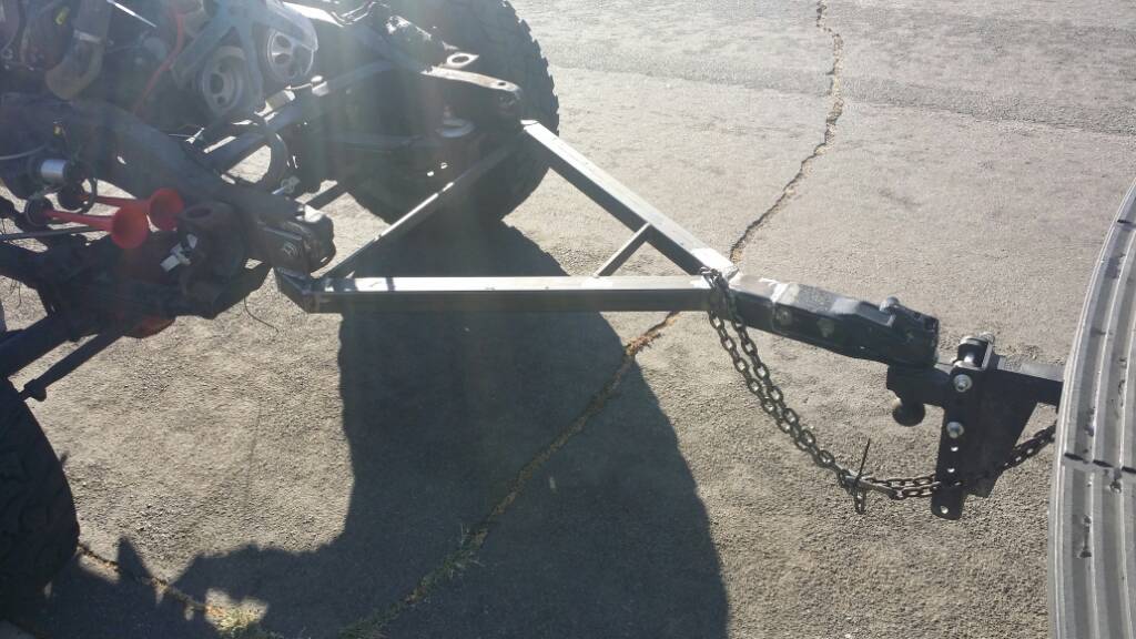

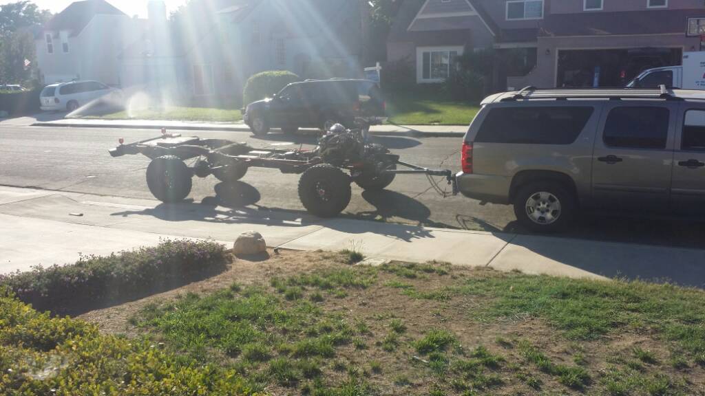

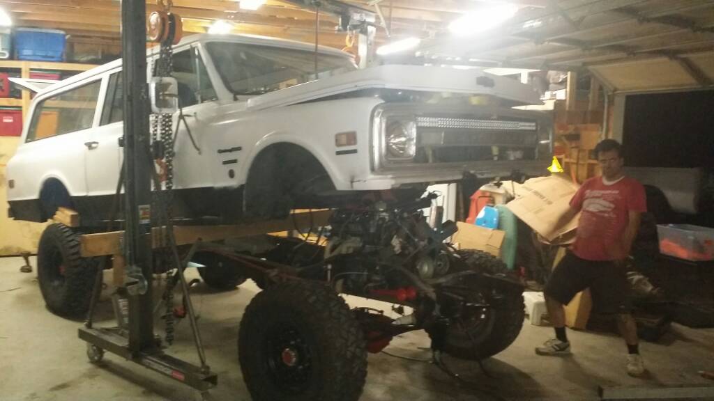

Built a tow hitch to get the chassis around town as necessary. I took it to the car wash and gave it a bath... it was surprisingly clean for a 47 year old truck.

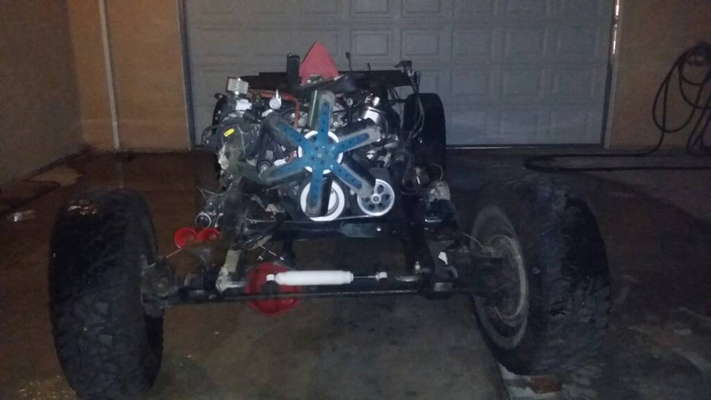

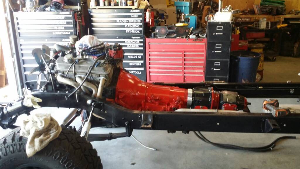

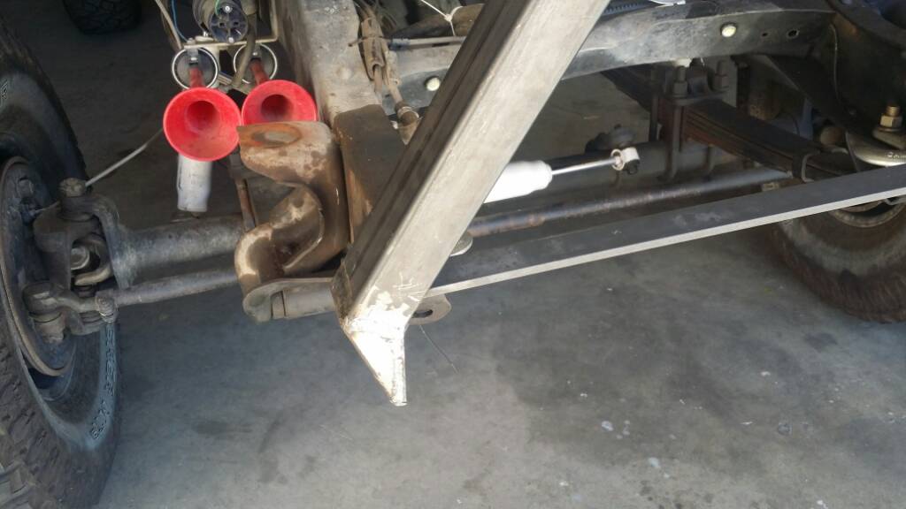

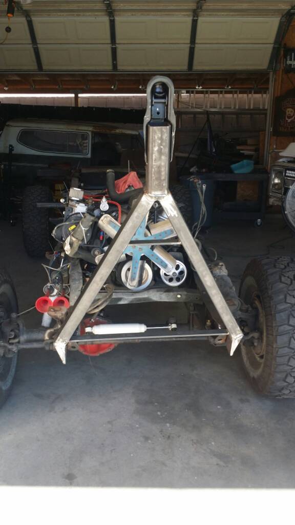

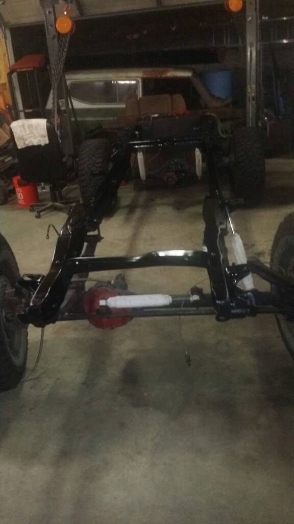

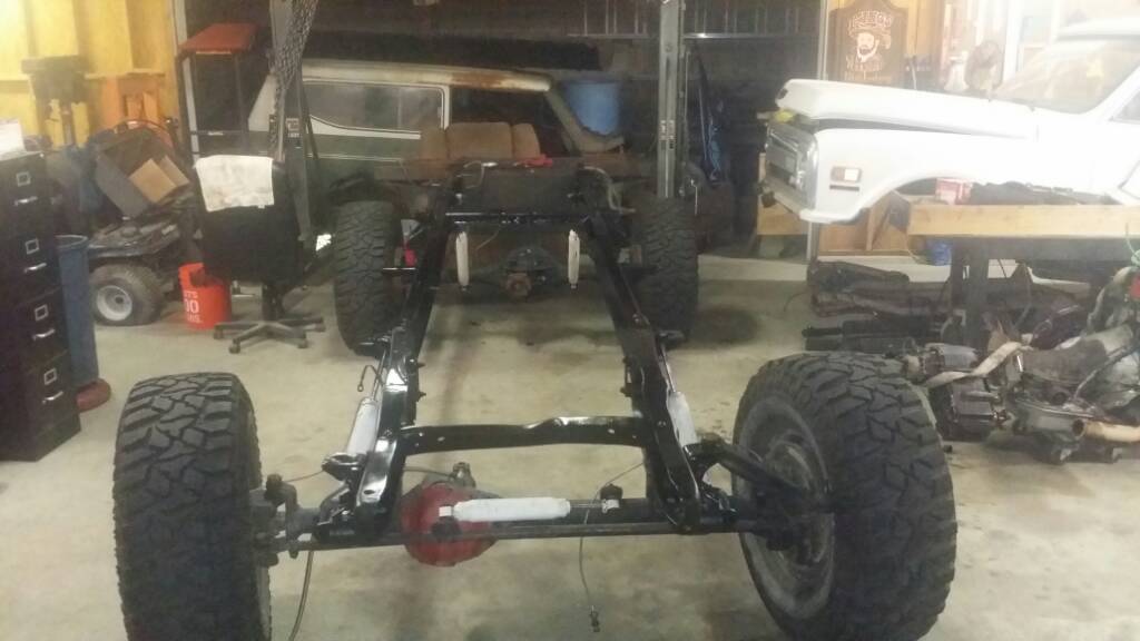

Stripped it down. Cleaned a.d painted the frame.
I relocated the engine cross member forward 2" and fitted the motor, headers, etc.
I cleaned up the fuel and brake lines. I'm gonna put in 2 line locks (front and rear) to lock up the breaks on steep slips where the parking brake isn't enough to hold the truck but you have to get out to move a boulder or whatever.

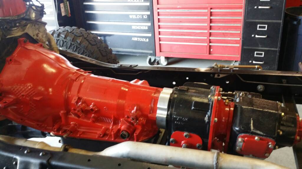

I put in the 4 speed and doubler and I'm in the process of fabbing up a cross member to accommodate everything.
I had to have that aluminum spacer made, luckily for me I have a few machinist friends so this one was free. I'm pretty sure I'll be helping him in the future soon with one of his construction projects. Anyhow things are moving forward... slowly but surely.

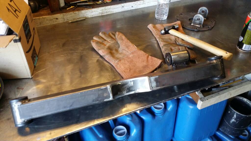

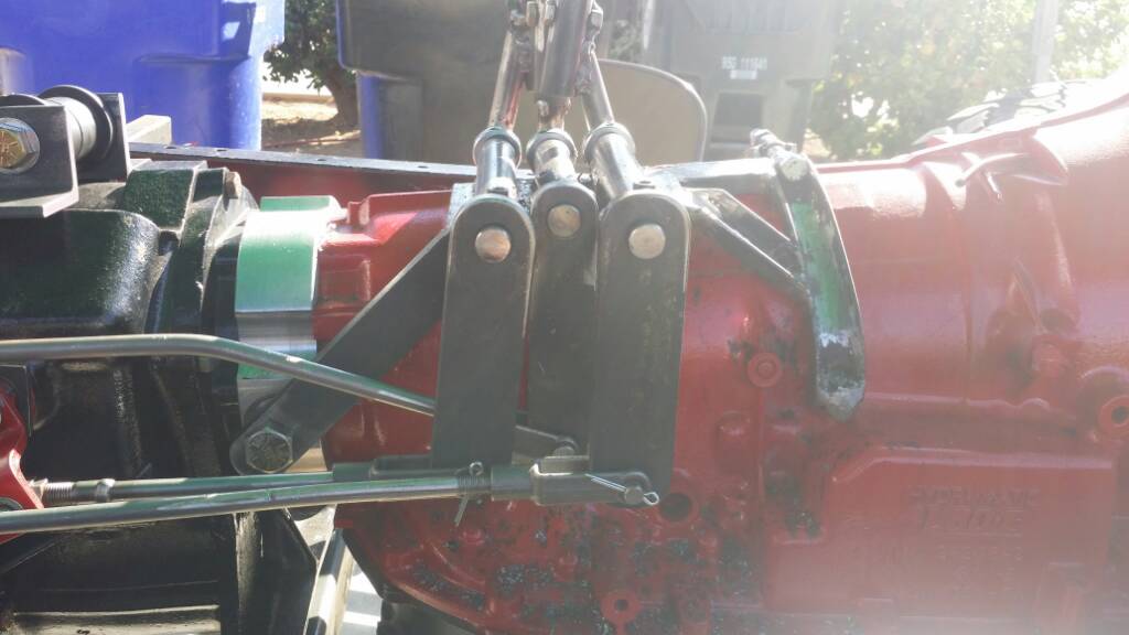

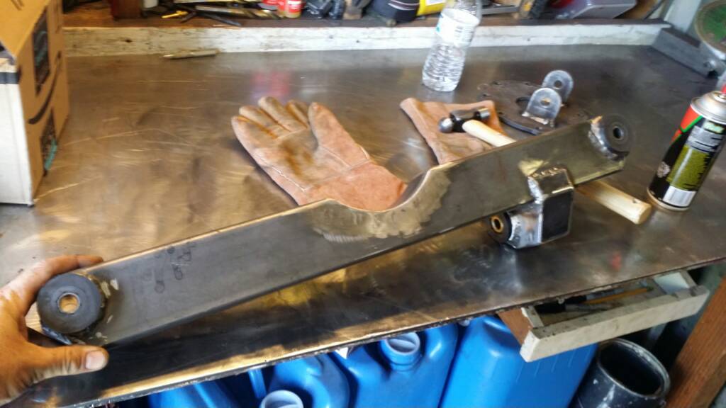

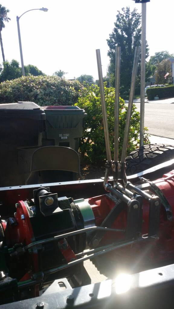

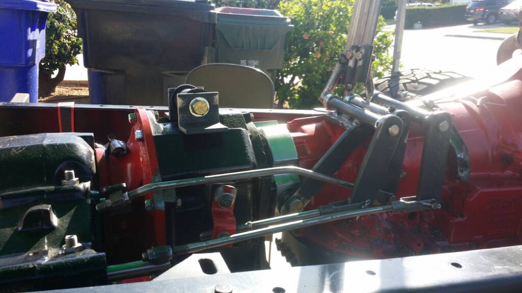

Got my shifter linkage finally done... well like 90% done. I'll still have to remove, clean and paint it. I might add some zerk fittings on those tunes but I'm not sure yet.
I made them serviceable... the sticks are removable as are the flat bar side that the clevis' attach to. So in theory it can all be removed and reworked in the future if necessary. I was careful not to have things interfere with other parts like cooling lines and exhaust system components.
Its going a lot slower than I thought it would but I'm more or less happy with how it's coming together.
Next is the cross member. Updates to follow soon.
Thanks for the interest and encouragement, it helps! [emoji123]
