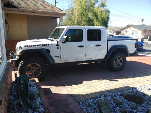

Nice rig. I have a 2020 White Gladiator. So far it has been a great rig. I am confident you will enjoy yours.Truck.jpg

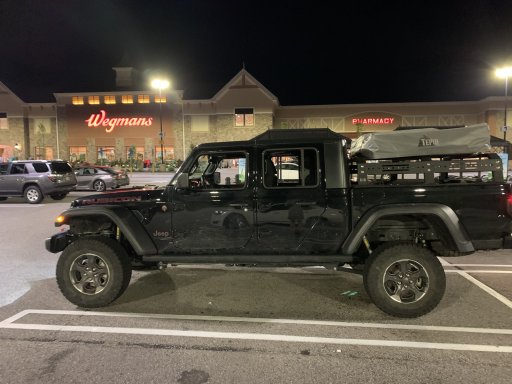

Lifted the truck with AEV 2.5 inch dual sport RT lift with high capacity springs (makes it a 3.0 inch lift). Attached are before and after pics about a month apart. Before lift I couldn't stand under the tent in the back with out hunching down. After Lift I can stand up right with 2 inches above my head I am about 5ft 10 1/2 inches tall. Fender to ground in front was 38.5", after was 42.5", rear fender to ground was 38.5" after was 44". Hopefully it settles a bit. Rides more like a truck less like a car, suspension a lot more stiff which is a good thing, a lot less vehicle roll when cornering.
