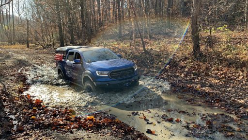

Finally got it put on last night in the snow. Gonna drive around with it for a few days to make sure everything holds up well. I did plan for the overhang but needed the space for my family of four. The aesthetic doesn’t bother me and the tent is plenty supported so it should be fine.
