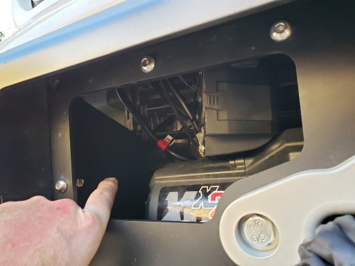

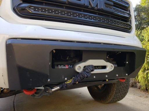

I got my winch wired up this evening after work. It's operational now but I need to make a mounting bracket to hold the control box. I found a nice spot for it that will keep the wireless on/off switch and the connection for the wired input up front and easy to access. I was worked after connecting the wires to the back of the winch without removing the winch from the cradle so I had to call it a day. Zip ties will hold the controller for now. lol
I'll make a bracket and mount the controller box right here.
