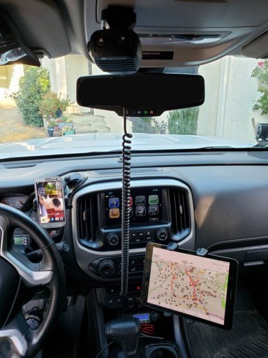

I moved my GMRS mic to the sunglasses holder. I used velcro for 1 trip to see if I liked it better than mounted on the dash to the left of the stereo and it was much easier to grab and replace while driving without taking my eyes off the road. I can also activate it and talk without removing it from the holder. The cable becomes invisible to me after awhile and for daily driving I just unplug the mic and toss it in the center console.827201918813.jpeg
