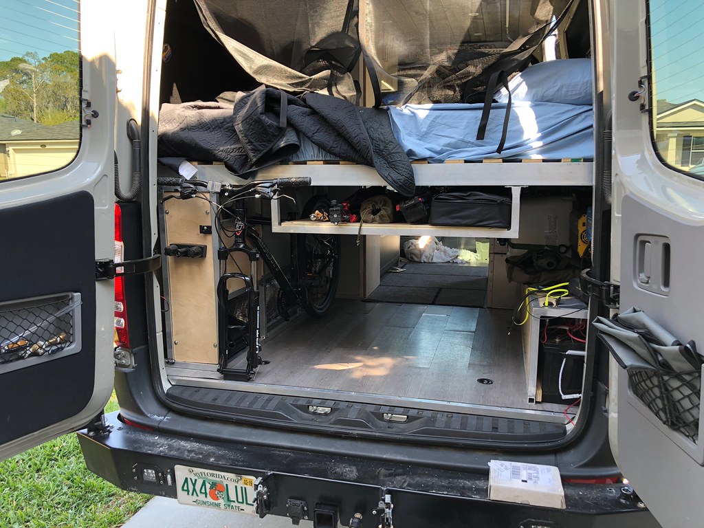

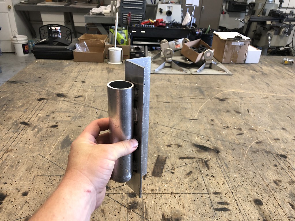

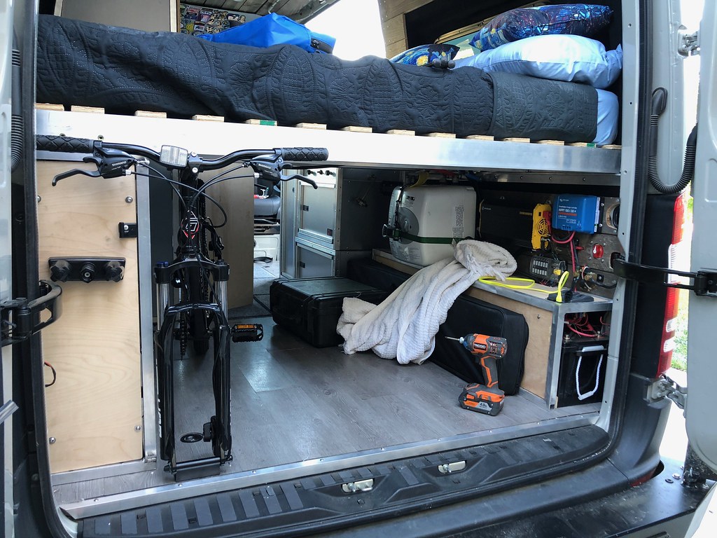

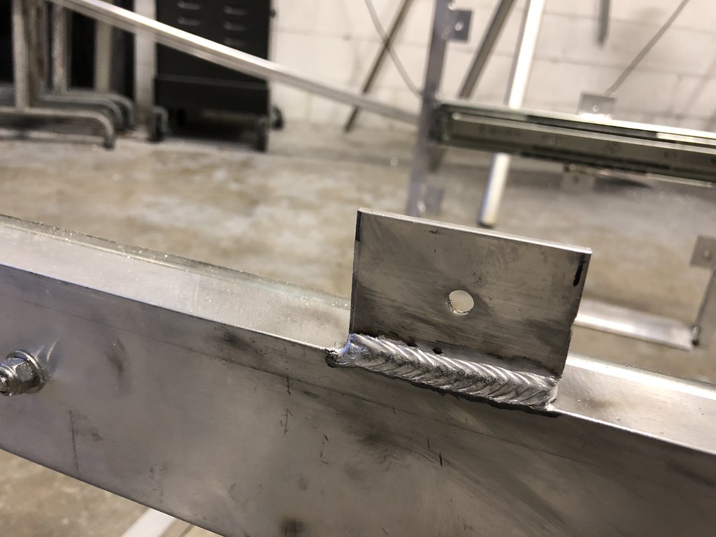

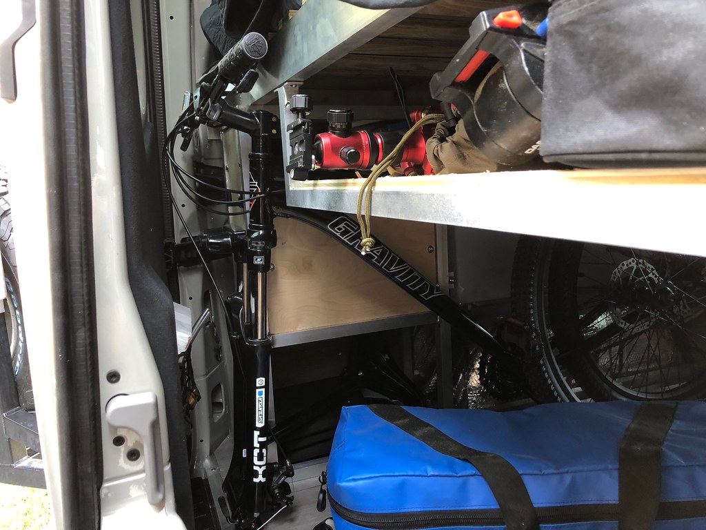

I wanted a storage shelf under the bed to carry the things i always have in the van
2-3 tripods, Video Slider, Flagpole and flags, area light on tripod.
To do this, i used some 1" square tube welded up into a U with some flanges and just used rivnuts to bolt it to the bottom of the bed.
Untitled by
Grant Wilson, on Flickr
Untitled by

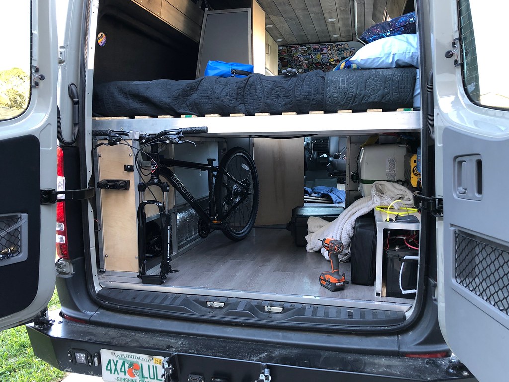

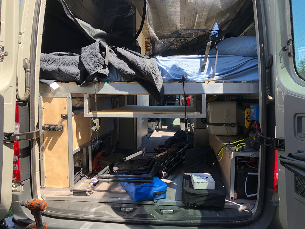

Used some clamps to approximate location and mount the board using some self drilling stainless screws
Untitled by
Final location allowed perfect placement for the bike with no room to spare!
Untitled by
Untitled by
still need to make a rear stop (hit the brakes and everything slid out lol)
Untitled by

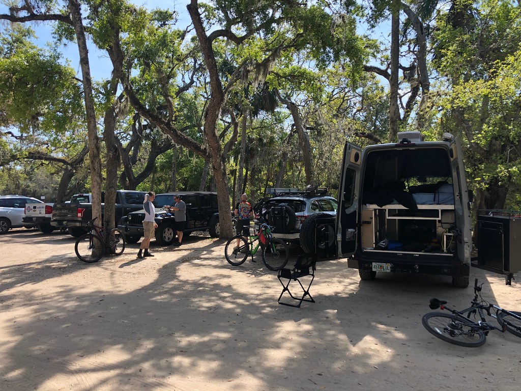

then went out and broke in the new 300.00 Bikes direct bicycle!
Had a great time out at the trails with the guy who bought my outback I built (to the left of me)
