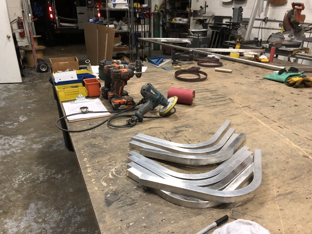

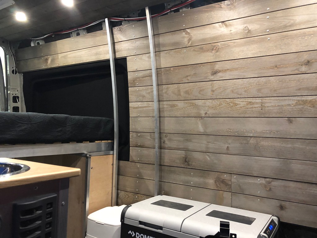

Because old dominion freight sucks dick and my kitchen isnt here to put in and start welding a bed frame, i started on cabinet work

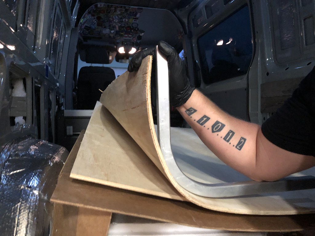

Bent and cut out 9 (need 7, made extra in case) supports to build curved cabinets
Untitled by Grant Wilson, on Flickr
These have a larger (about 1" more...test piece was a 9 " radius, the actual production is an 11" version)
I will be welding mount flanges, and tabs to screw the wood to.
THe bendy wood will go up until there is a vertical surface where the door will start. it will all make sense in about 2 weeks when i get back to them. I was just not trying to waste time tonight and actually get something done.

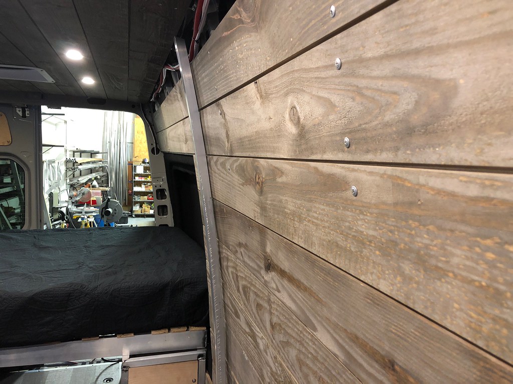

The radiused drawers look fantastic , I own a CNC router 5’x10’ so we have always just ran a few radius tools down the edges of our drawer systems , but I believe I like your look better

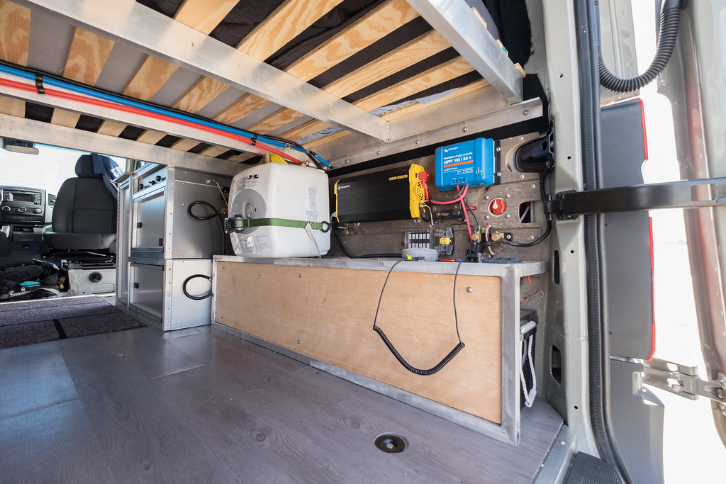

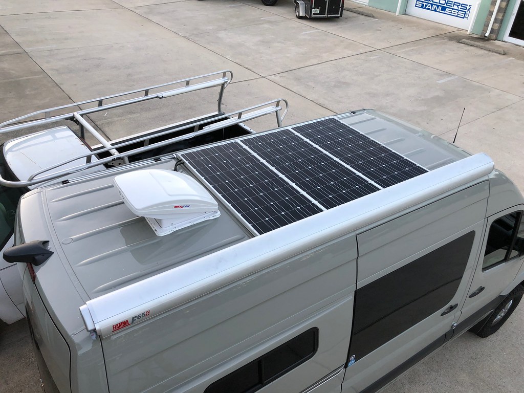

Finally got all the solar in and installed. For the fun of the in
depth portion of this build since everyone always asks what i use, I will divulge into it!
I use renogy. At one time (full disclosure) I was sponsored by them. Even after that ended i continue to buy their panels. They are quality, and work well.
I chose to use 3 100 watt Monocrystalline panels http://amzn.to/2BVLNeh
To connect those panels in series, i used two pairs of these - http://amzn.to/2BUqQk5
Then used these cables with the unused ends cut off to run the rest of the routing, super solid and thick stranded wire for good power conduction - http://amzn.to/2GLhXgx
I used this glad that i sealed, screwed then resealed over the screws - http://amzn.to/2GNWrYb

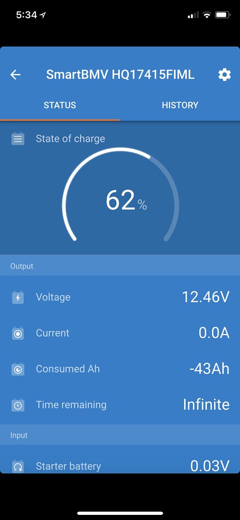

These wires then go into a victron 100/30 Smart MPPT charger - http://amzn.to/2BVhvZc
Which is also monitored by the Victron BMV 712 - http://amzn.to/2E4hKD2
Into this battery - http://amzn.to/2GNTw22
With this combination I can accurately track overall use, history, incoming and outgoing amps, and remaining time along with a shit ton of other stuff.

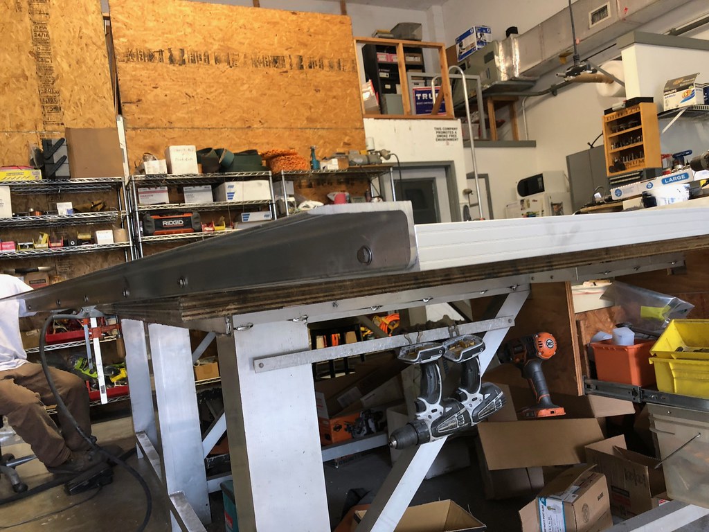

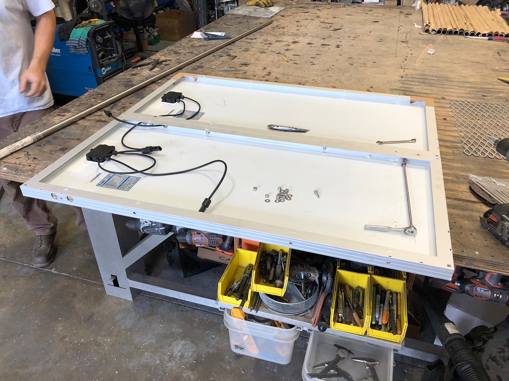

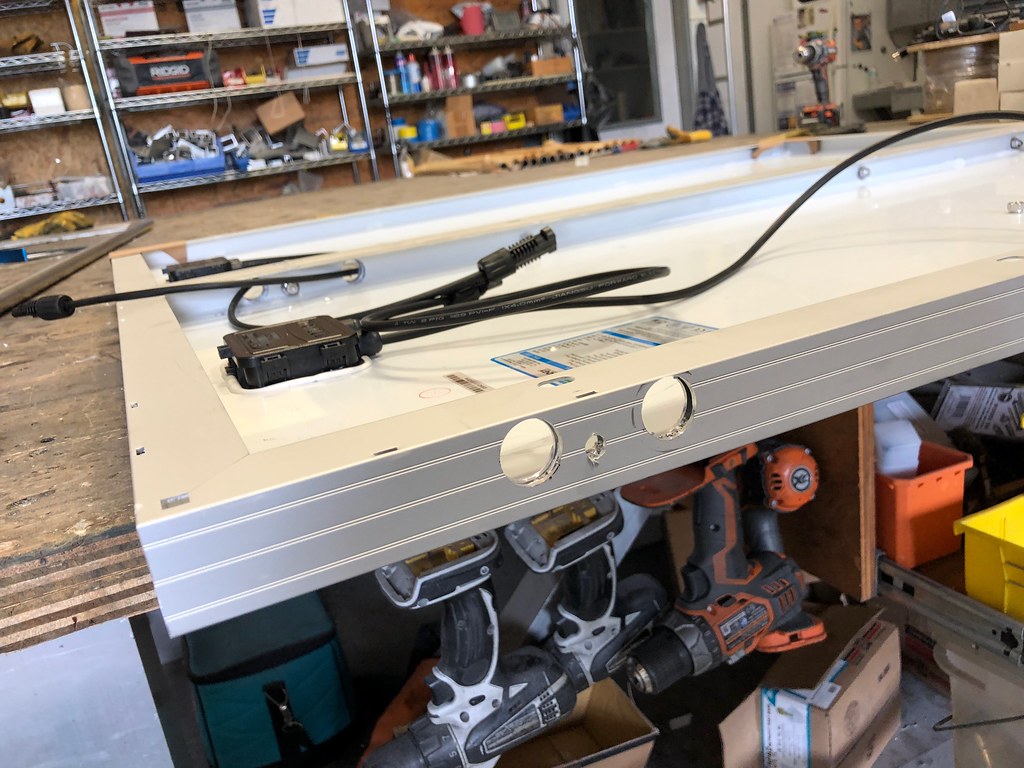

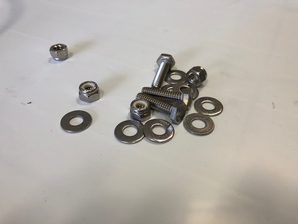

For the panels themselves, i bolted all three together with 1/4" stainless hardware from www.buildersstainless.com
for the mount i used 2" x 3" aluminum 1/4" thick angle with the 2" side on the solar and the 3" on the factory racks

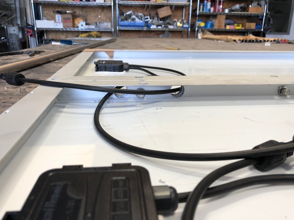

panels bolted, routing for cables (they are later covered in loom for protection)
pretty stainless hardware
two together
angle mounted for installation

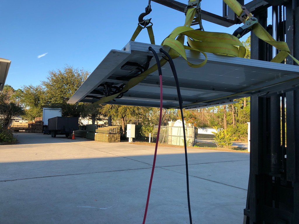

all together, cheating with a forklift
3 panels installed!

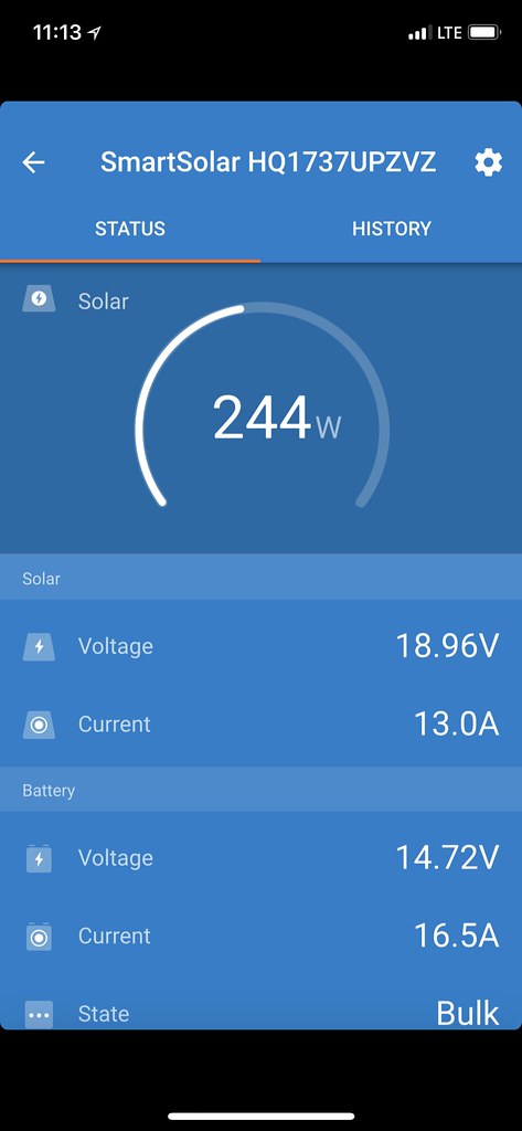

solar production at about 10AM on a winter day
what it takes to run a 1500 watt hot water heater to heat 4 gallons of water in 20 minutes.

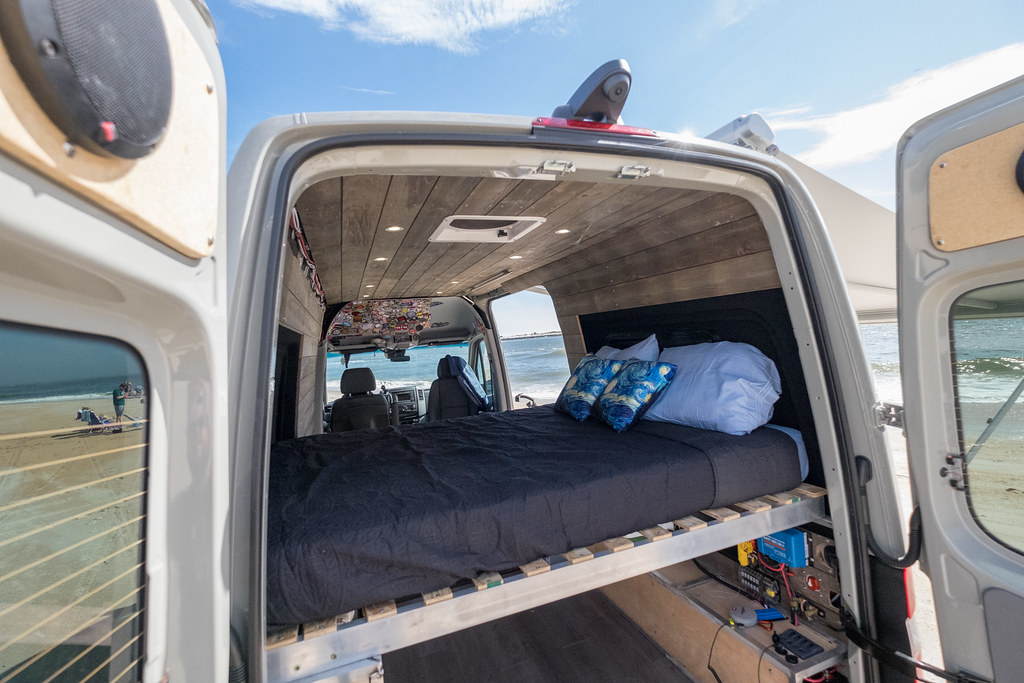

Ok. Lets get yall up to speed

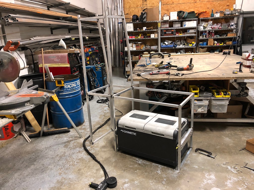

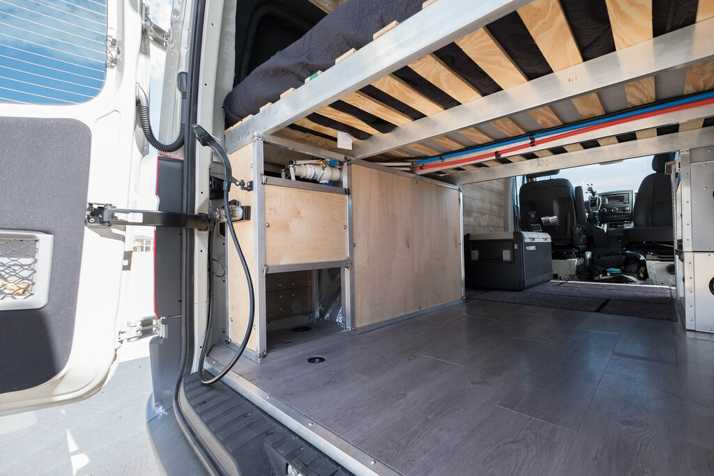

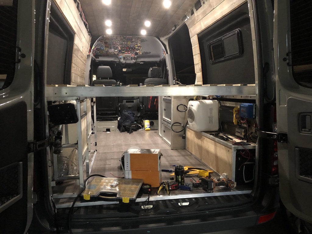

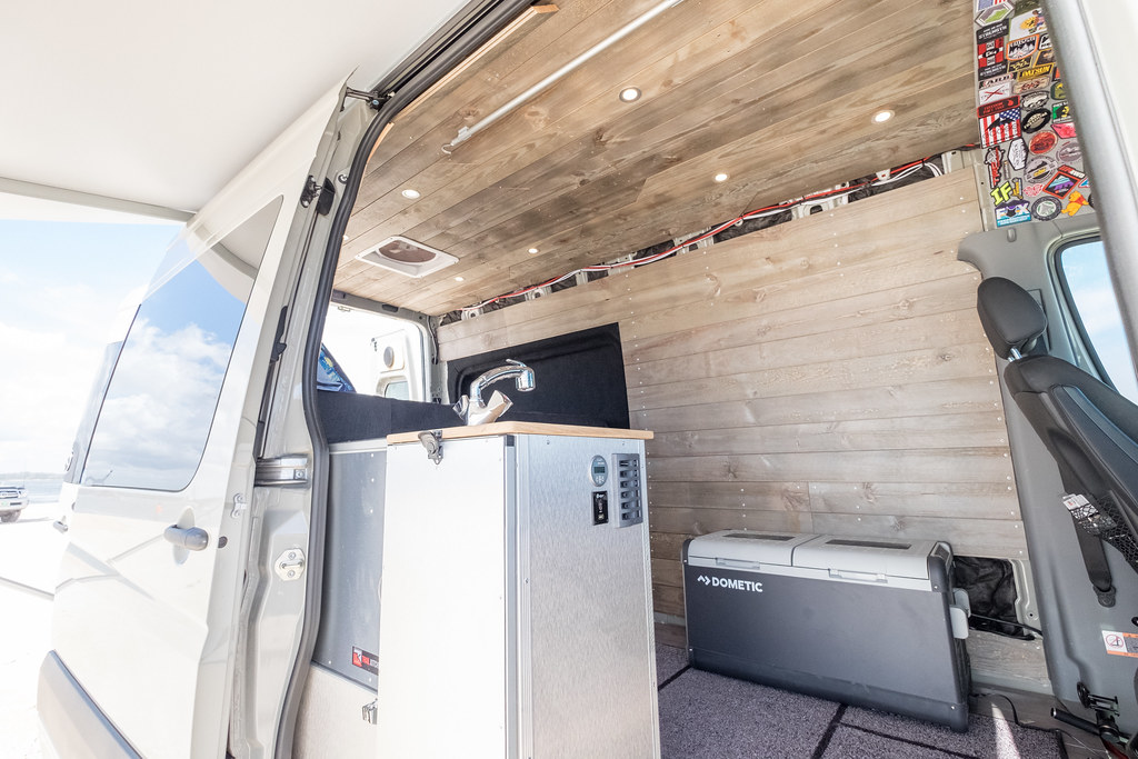

Took a day or two to build the cabinet for the fridge and soon to be closet.

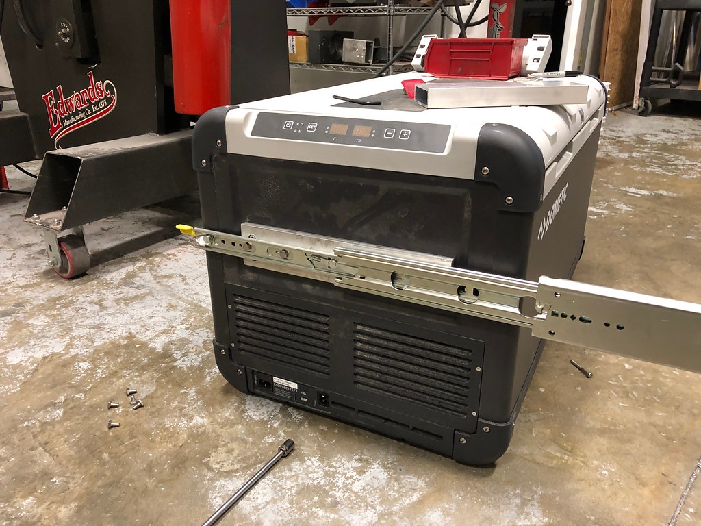

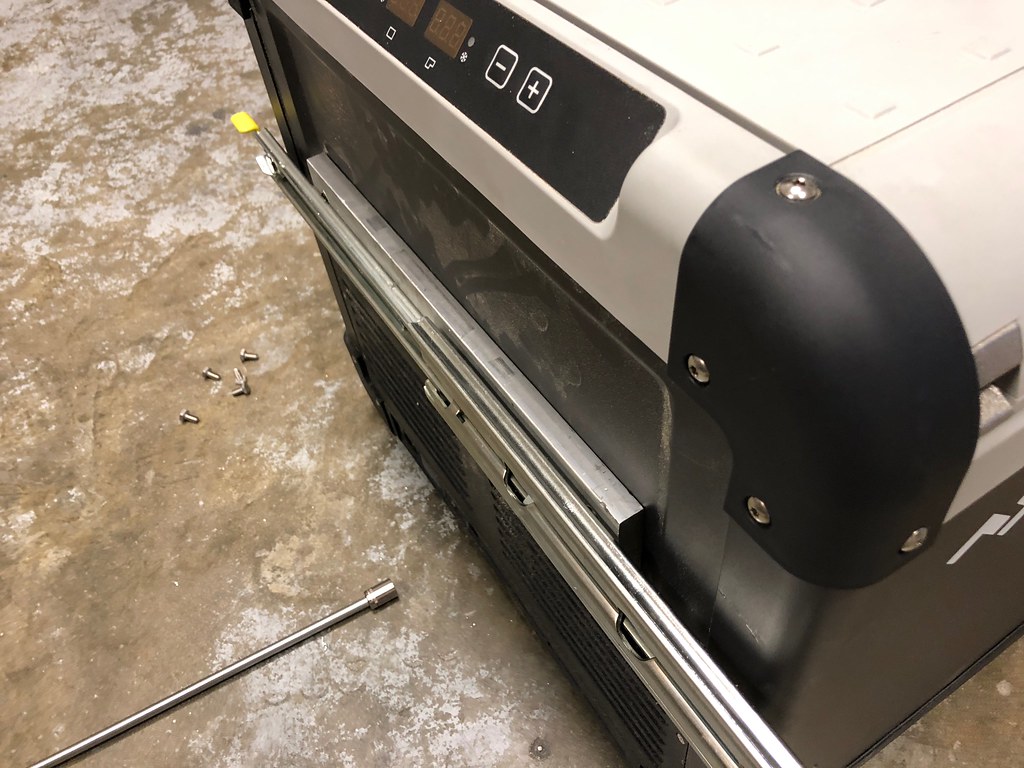

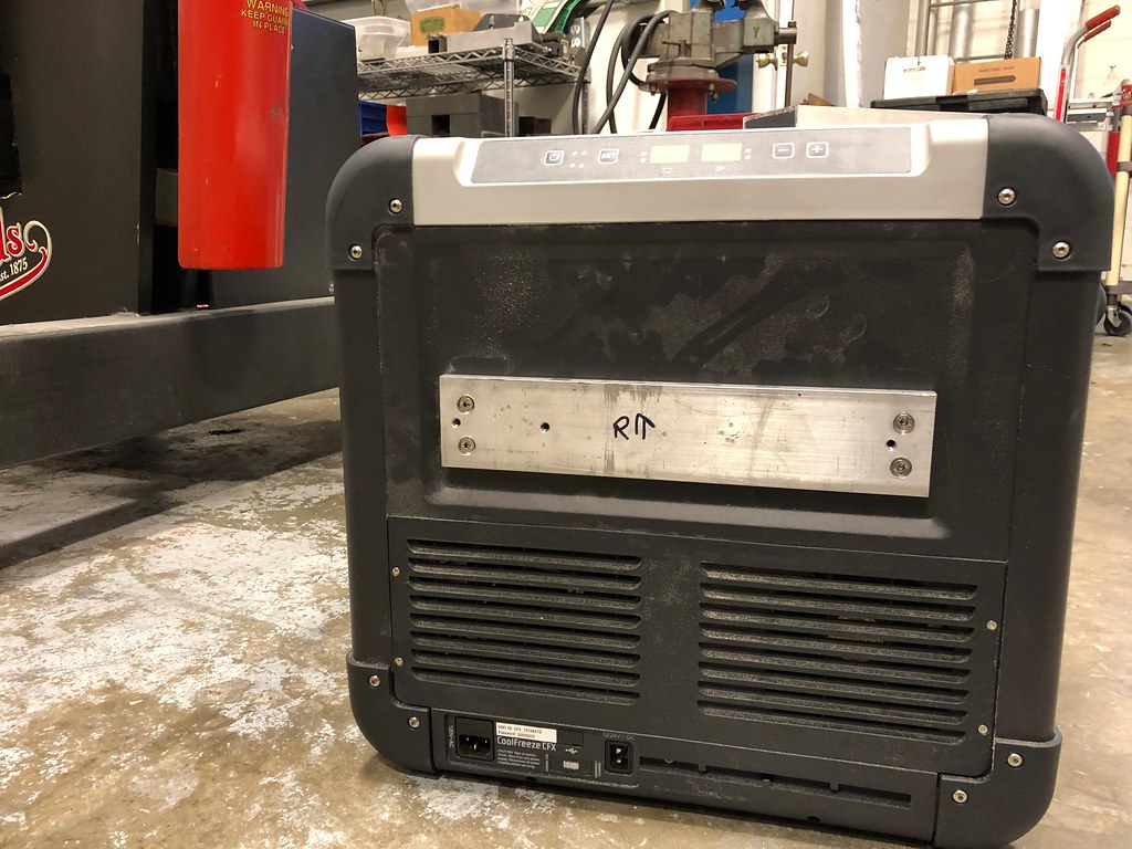

Had to figure out a way to mount up the fridge to the enclosure and save as much space as possible.
I ended up using 3/4" Aluminum block, some socket head m6 bolts. Transferred the pattern from the handle to make the mount holes, used an endmill to counterbore so its all flush, then used the slides to make a pattern for the actual mounting, drilled and tapped them.
This let me make the cabinet as compact as possible, and keep everything nice and close to the fridge so it doesn't stress it. Can't mess up my precious ice cream holder!

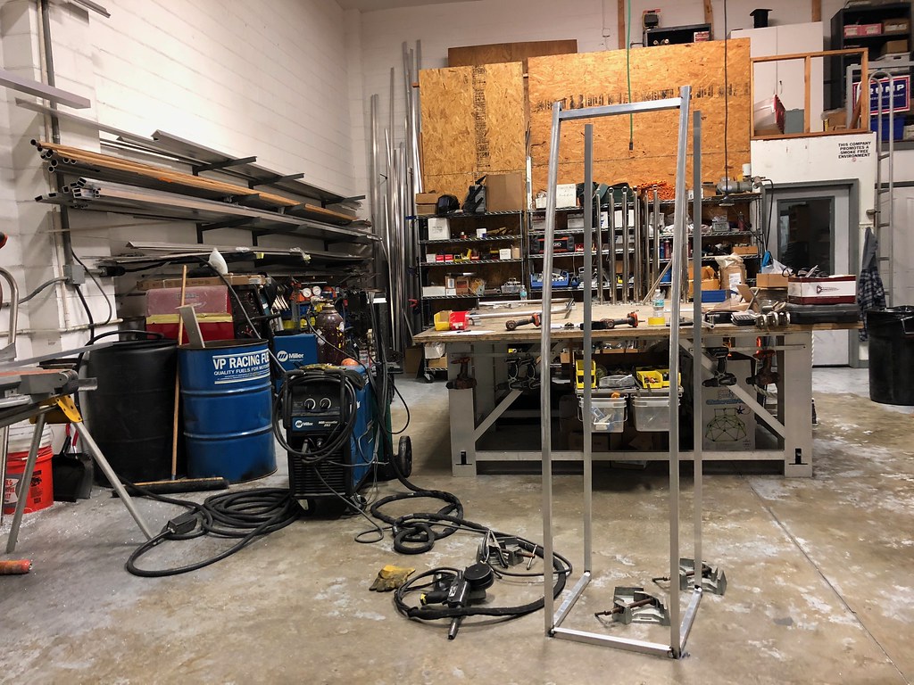

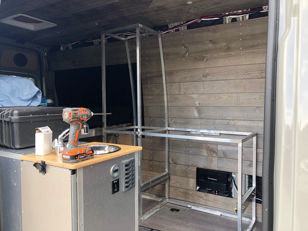

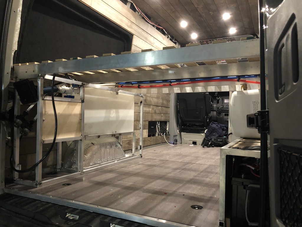

From there I Bent up some rear pieces on the roll bender to fit the contours of the van
A little bit of welding and it gets us a solid base
A little more welding and a burnt phone screen later, we have the carcas

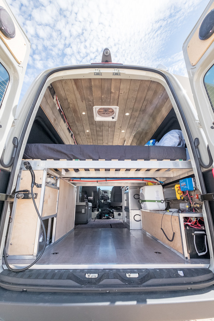

Far from done, but done enough to hold the cooler in while we go camping this past weekend! First weekend out. Can't be happier with the performance of this beast in the softest sugar sand known to man

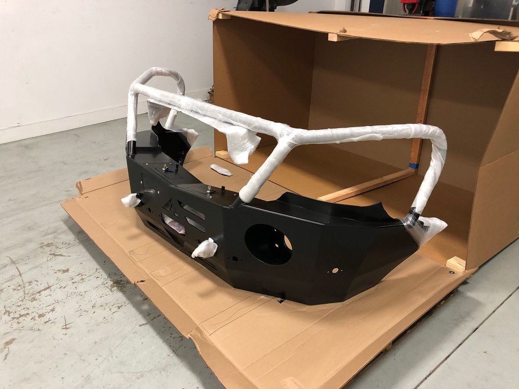

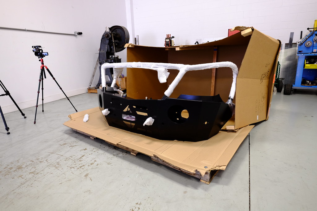

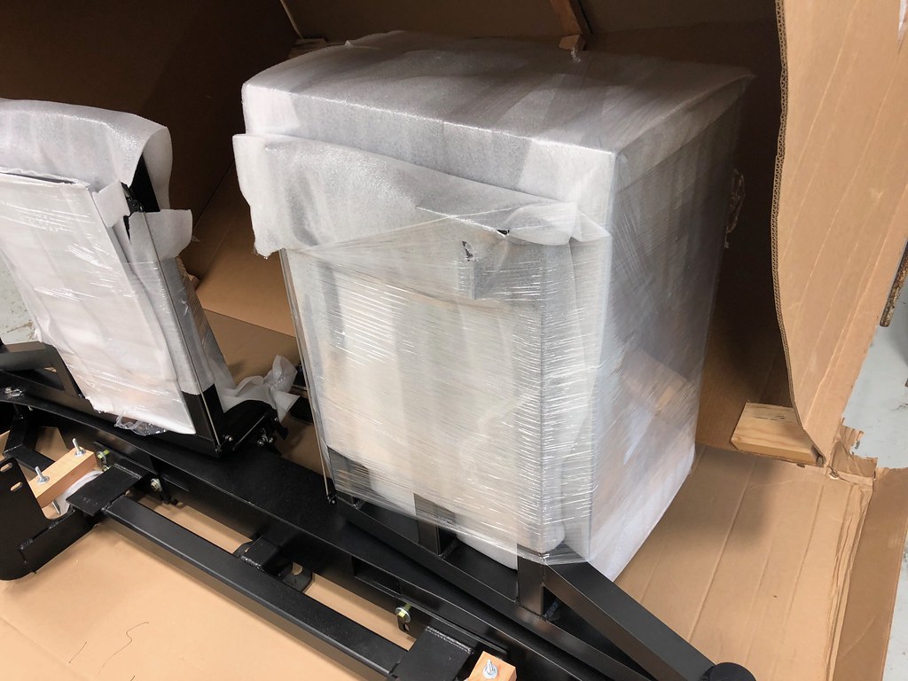

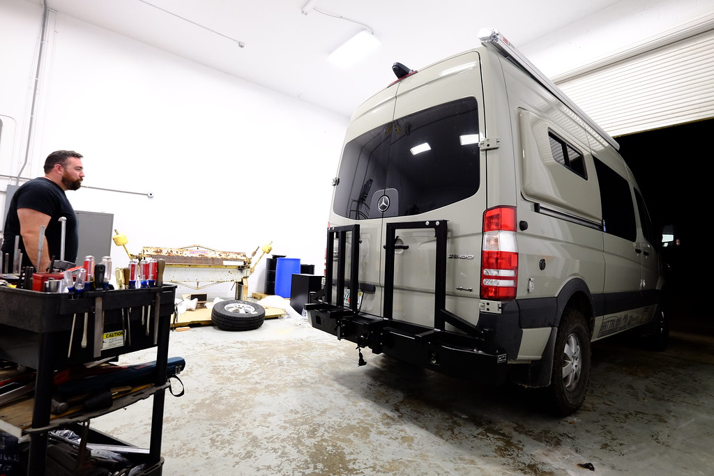

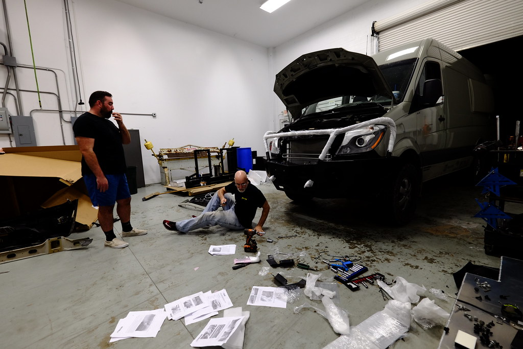

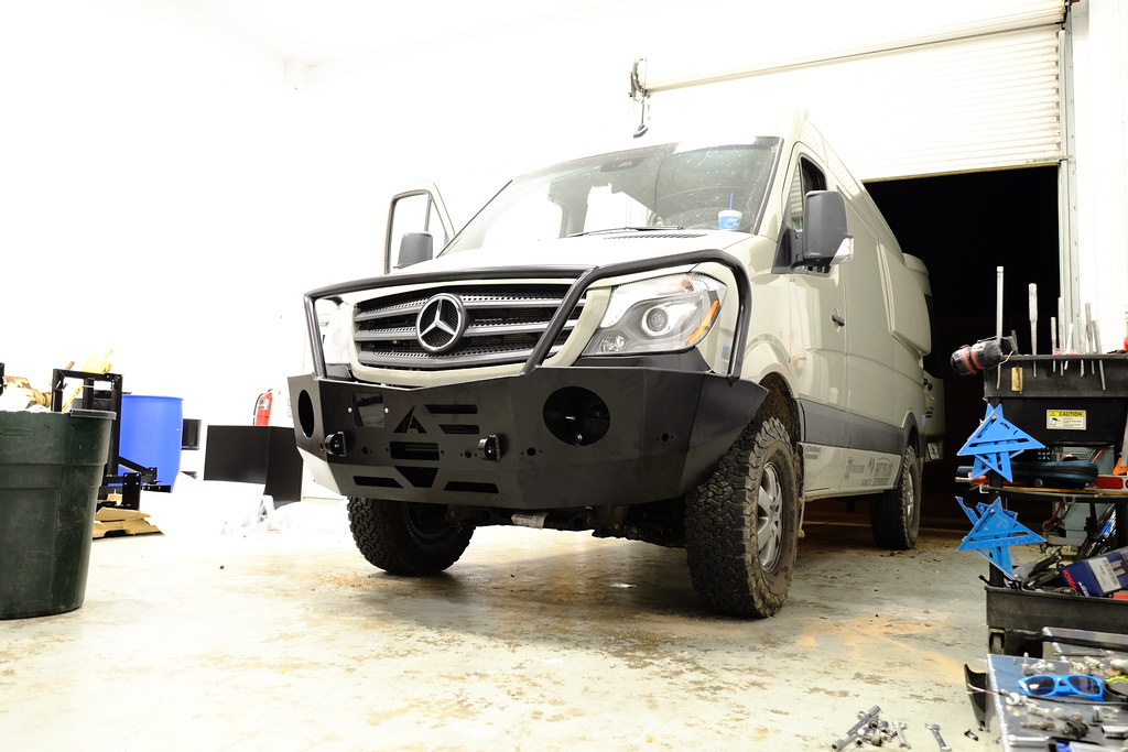

So big moves for little people

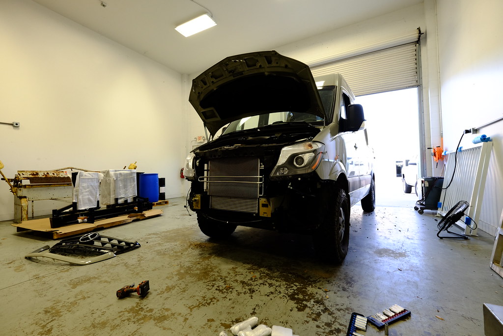

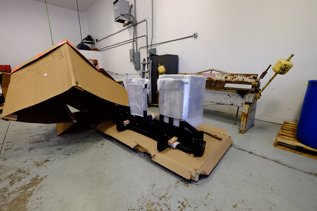

Bumpers!
Aluminess bumpers front and rear.
I will say this. They are the best packaged, safe and sound bumpers I have ever bought. I like the instructions (about 85-90% complete) and the fitment was really spot on. Have about 2.5 hours into it, and maybe a few more into the rear end of it to go. Front end fits perfect with zero issues. Rear end fits well, but wish it was an actual bumper instead of an add on, but i get why it isnt.
Overall, 10/10 would spend an arm and a leg again.
bumpers by Grant Wilson, on Flickr
