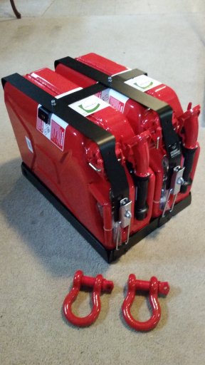

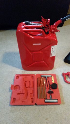

Quick update... Got some goodies for Christmas! Nothing installed yet, but ill get it on eventually... I got the Dual jerry can holder from Front Runner, 2 Wavian NATO jerry cans, an 8x8ft canopy for the roof rack, 2 shackles for the lo-pro bumper (still to be installed), and a flat tire repair kit. Im slowly building up all the gear ill need for next years (hopefully) trip to Alaska. Most of the stuff will still be useful in the meantime as well... I dont know how much ill actually use the jerry cans this year, but they sure do look cool (:20171228_162319.jpg 20171228_162048.jpg 20171228_162225.jpg

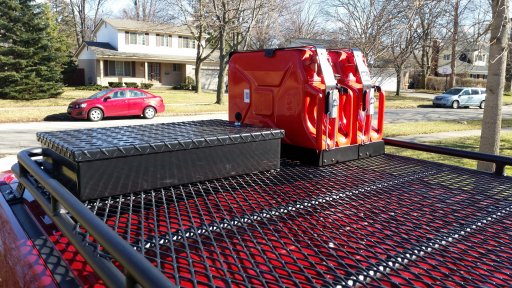

Progress! Got the front bumper powder coated and ready for install. Ordered my smitybilt xrc 9500 synthetic winch as well. Had a day off work with some nice weather, so i go up on the roof and setup the jerry can holder. As this is my daily driver i dont drive around with the cans and top strap all the time... those easily come off, and the base plate just stays bolted to the rack. I had to do some drilling in the base in order to mount it. I had to push the holder far back to make room for the tent. Because of this there was nowhere for the bolts to attach in two of the standard spots. I had to make two new holes further forward on the base. As much as i love my gobi rack, i will say installing things on it is quite the pain. Jamming my hand under the rack trying to tighten bolts is not easy. If you need to get a bolt near the middle of the rack forget about it... Next nice day off im going to figure out how to get the awning mounted. Itll be interesting coming up with an way to mount it so it fits with my tent and still be easily removed when not in use. Front bumper and winch will be the project after that... then on to upgrading the front suspension to deal with all the extra weight.20180226_150832.jpg 20180226_150737.jpg

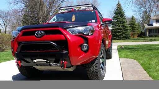

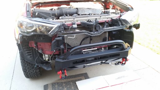

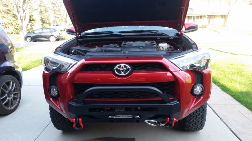

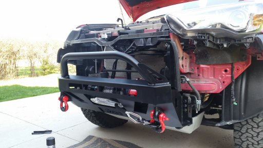

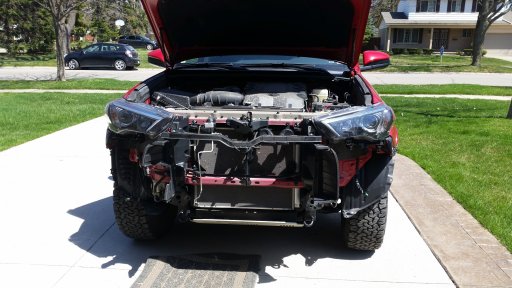

So... Made some progress, but with a few hiccups... First off, I got the C4Fab bumper on. Winch went on too... with just minor fitment issues/ bending of lines. I was, however, pretty mad to discover that c4 had forgotten to send me the L brackets for my light bar. So next week when the brackets arrive ill have to pull the bumper off again to install the light. C4 was helpful with the brackets though, after a quick phone call they said new ones would be delivered within a few days. After finishing everything here is what ive found (and pretty much expected). My stock front suspension had dropped. Im now just over an inch and a half lower in front than i am in the back. With my 275 Ko2's i noticed a rub when reversing and turning down the driveway curb, and also once on flat ground. I knew this was coming, so ill be installing new shocks up front to level it back out. I also spent a day pulling off my sliders and sanding/ grinding off all the rust. Several new coats of paint and they look good as new. I think next time ill get them sandblasted though, because even after almost 5 hours of sanding they werent perfect... we will see how well they hold up this time around. Lastly, snorkel arrived... ill prob do that in two weeks.
