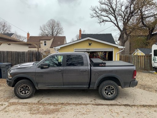

So here is what the truck looked like shortly after I bought it in 2020. I did install the tool box and cut down the tonnue cover. I had already installed the bed slide in the truck.
I bought the truck in late may of 2020. It already had the air suspension removed by the dealership, and not very well I might add. Cheap ready struts in the front and I think HD coils out back with the stock billstien shock.

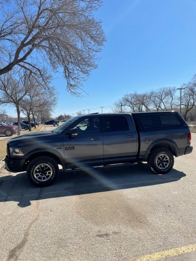

So I quickly installed a level almost immediately then picked up a Bed Cap
