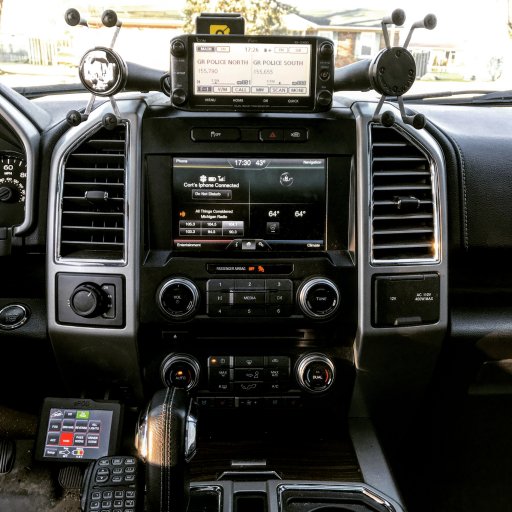

742B5DA4-E4E4-4A0C-8A92-34D1B22B4D9B.jpeg C7FBA1A7-DB95-439D-BCD2-2B8250D0A66F.jpeg 3A0B771A-5D8A-4773-82E3-46BF360F04C2.jpeg I’ve been working and camping so I haven’t done much with the truck over the winter.
Yesterday I upgraded my cock[it with the new Built Right dash mount. I was previously using a RAM two ball hard mount. This set up allows me to mount my HAM, cell, gps, GoPro, dash cam, and more. I am very pleased with this system, much cleaner than what I had before.
