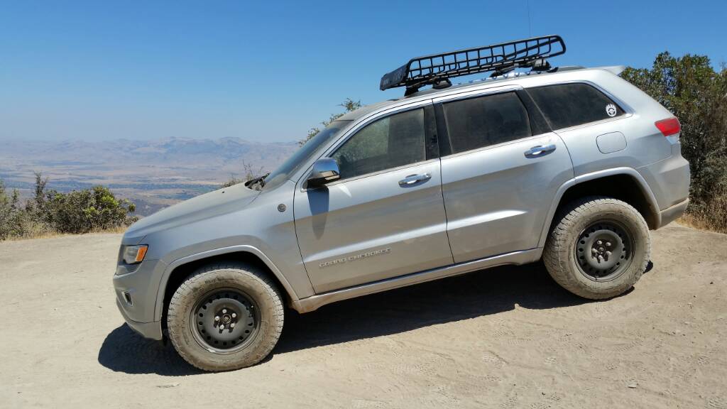

Meta6981. Where did you get your steel wheels and which ones did you get exactly? It is time for new tires on my "14 JGC Overland and I would like to put the new tires on 18's instead on the 20's that are on it now. Thank you.20151026_182743.jpg

Meta6981. Where did you get your steel wheels and which ones did you get exactly? It is time for new tires on my "14 JGC Overland and I would like to put the new tires on 18's instead on the 20's that are on it now. Thank you.View attachment 5532
I am sorry for the delay... I did not get a notification for this... but I got the mopar steel wheels. I went into the parts department of my local dealer and asked for the same steel rim that is on the spare already (Least for the overland package). He gave me a deal and sold them for about $116 a piece. I also bought the second set of TPS sensors for the steel wheels.
