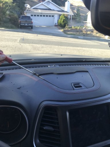

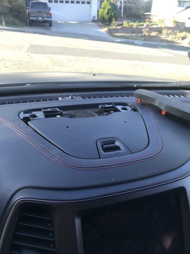

first i had to pop off the screen for the center dash cubby speaker so i could access the hardware to be able to get the cubby out of the dash. (note the holes already placed be cause i decided to take a step by step AFTER i had already started this project)

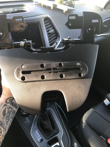

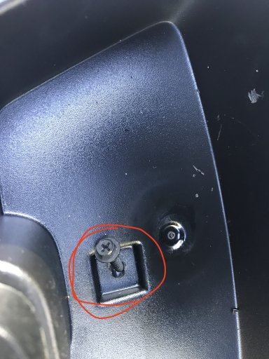

next came the screws that had to be removed in order to pull the cubby out (its all one piece and there 5 total screws that need to be removed) 4 screws under the screen and 1 screw inside the cubby under the rubber liner

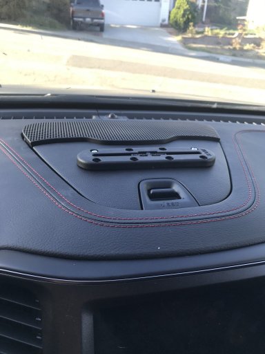

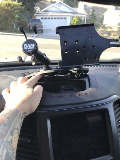

once the screws were removed the entire unit came out and was EASY to handle. i took the RAM mount 5" track system i ordered (took all my measurements prior to ordering parts) and lined it up where i wanted it to go. the first hole drilled i marked with a sharpie so i could drill straight down into the door for the cubby. the rest of the holes i drilled were ace i had the track mounted, going from corner to corner until i had it rock solid.
once all 8 holes were drilled and the screws in place and tightened down it was time to reassemble the cubby back into the dash. all i had to do was reverse the steps i took to get it out!
very simple. the screen cover pushed flush back in, i just took the photo before i had pressed the snaps back into place.
after getting the cubby reinstalled, i added my accessories that i have for now to the track system and got them positioned to where i wanted them.
the best part is.......... i can still use that cubby for storage if need be! I'm planning on putting some kind of power source inside the cubby for my navigation accessories in the near future, under the cubby is a HUGE open space where the cars head unit sits but there is a ton of free space to run wiring and put USB outlets into the area with no other modification to the dash.
