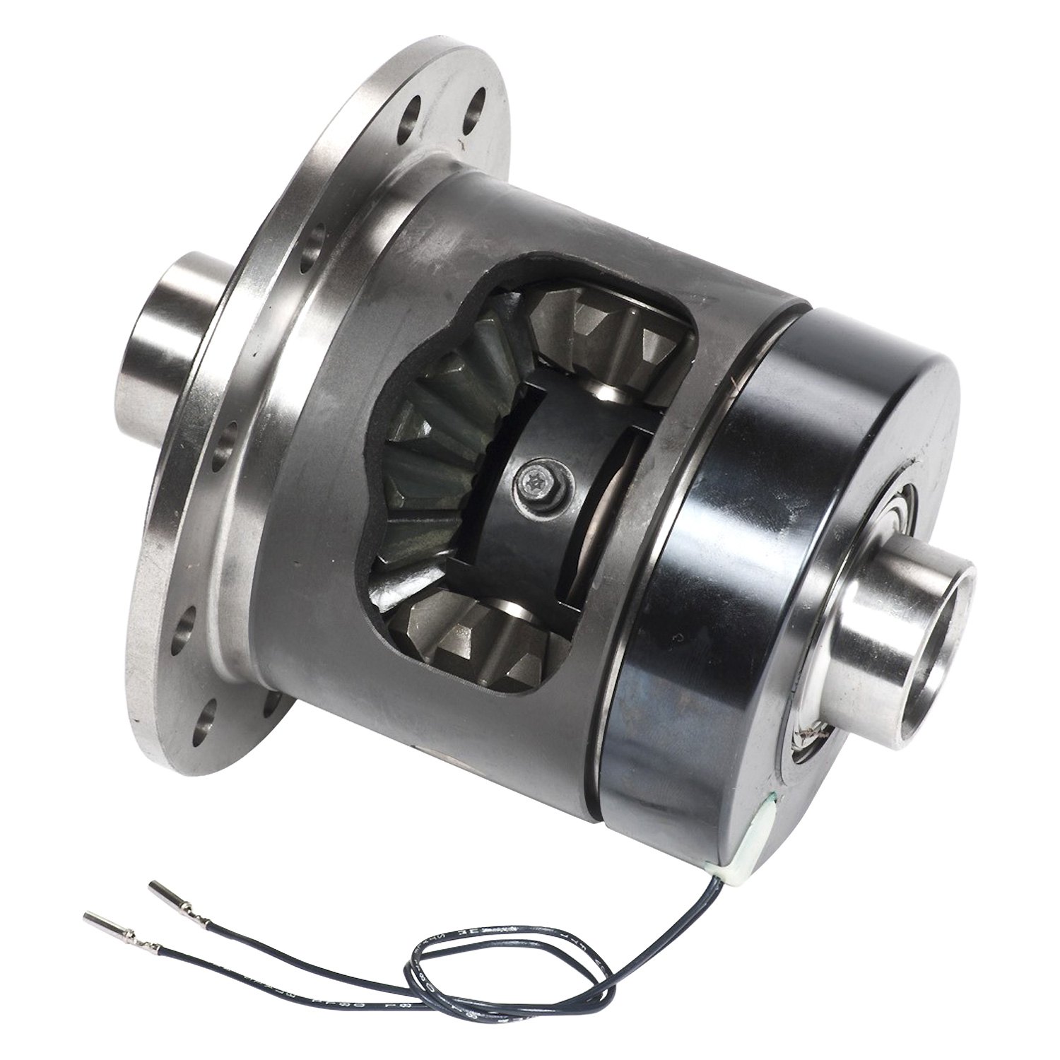

Current one I'm looking at is a locking rear diff. Here's a link:
Personally I would buy a junk yard Ford 9" with a posi unit for $350 and drop it in. But that's me, nothing stronger than a Ford 9" HD (large bearing hub) diff.
They are in cars and 1/2 ton trucks. Both coil and leaf spring suspended but mounting can be modified to anything you have if your mechanically inclined.

I'm unfortunately not very good at mechanics.
Lanlubber In Remembrance
Mimbres, NM, USA
Jim
covey sr
16986
Not a good way to start a build. Since you use the car as an everyday means of transportation you will never learn mechanics.
You cant afford the down time that it takes to do your own work. The locker you posted is more than half the value of your car but will not increase it's value if you sold it. IMO... I would buy another car with the (+ -) $800, use it for your daily while you work and learn on the cop car. Or, if the cheap rig you buy happens to be a truck or SUV, SINK YOU MONEY IN IT AND USE THE COP CAR FOR THE DAILY DRIVER. Any truck or SUV would carry a higher value if you sold it than the cop car. Your going to have to learn mechanics st some point or you will always be spending money on labor instead of investing in your rig. Best advise I can give, hope others will give us their .02$ on my opinion.
