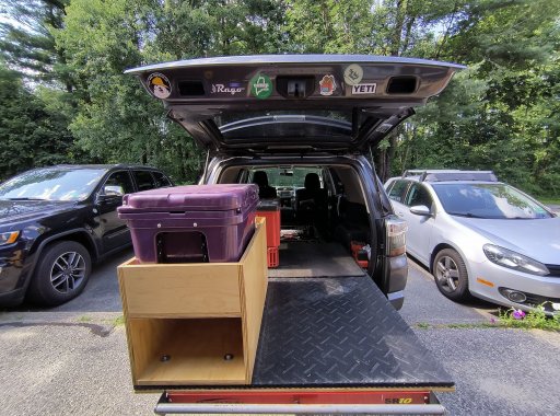

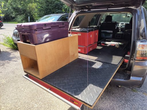

this weekend I pulled my 4runner back seats and my two buddies helped me install a used 6' bedslider I found at work over the course of two days. I carry a bunch of milwaukee packout tool boxes for work and for camping as well so this slider is an awesome upgrade. the only other person that rides back there is my always wet and muddy dog so there is another plus. besides gear hauling it will be nice to have a place to sleep when camping solo with the aforementioned always wet and muddy dog.

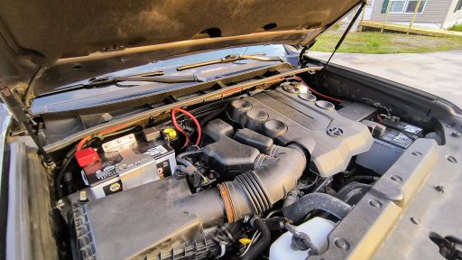

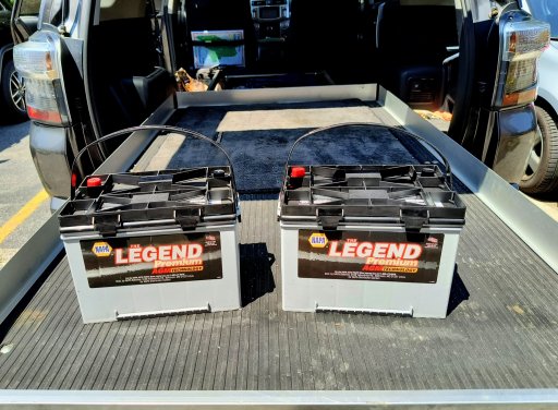

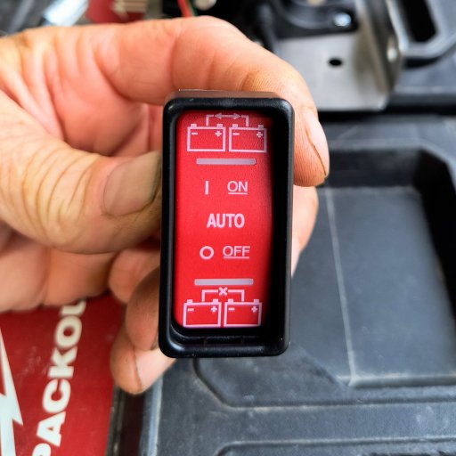

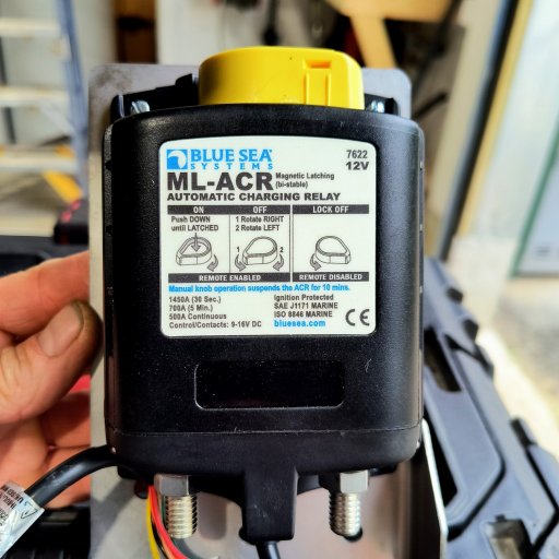

the next task on the 4runner this weekend...underhood dual battery setup. I run an odyessy AGM battery in the TDI and love it but I can't justify buying two odyessy AGM batteries plus the cost of the other items for a proper install on the 4runner.
I ran this same NAPA AGM battery before and was really happy with especially when using glow plugs in the dead of winter. it finally dawned on me the other day that a dual battery setup and robust electrical system is at the heart of every other future upgrade going forward be it a winch, fridge, additional lighting etc so let's start there, right?

I haven't seen anything like that before! Looks extremely utilitarian. Are you looking at adding any permanent brackets underneath the front supports or just keeping the wood? Any concerns with the tray rattling during everyday driving?
Broken Yoke
443
Portland, ME, USA
Christian
Jackson
the plywood spacer is intentional to spread out the weight/footprint of the welded brackets. the majority of the weight if not all of it is being carried by the seat mount connection and the original forward cargo area tie down mounting points, both bolted connections. I still need to swap out those plywood strips for a square piece of 1/2" plywood instead.
the way the brackets bolt in to the seat mounts sandwiches the whole bedslider down. unless you turn around while you are in the 4runner you would never know it was back there.
it is dead silent, no squeaks, rattles, hums etc. between driving around with it loaded tools all week for work and another 6 hours of driving yesterday with it empty I have yet to hear a peep outta it.
longterm plans seem to be building out the entire rear of the 4runner above the bedslider with 3/4" plywood so there is enough room to sleep back there with the dog and wifey.
that bedslider is pretty heavy, between that and all of the other weight I expect to add over the next 12 months to add it will be a long wait to upgrade the suspension.

no work on the dual battery setup this weekend. I was going to go with a full manual caveman (no relays) underhood battery switch setup. I decided to make life easier and instead ordered a rago fab 2nd battery box and a blue seas charging relay from amazon instead. this install will be much easier than the one pictured below. the attached pictures are a 24V system we designed in house and I built, wired and installed on a new tug boat build. I was handed a pile of parts and that is what I made out of it. it was kind of like 'build a bear workshop' but for marine electricians :smile:

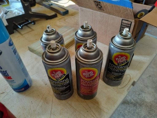

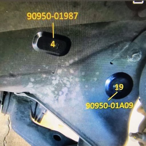

5 spray cans of fluid film later..my rusty undercarriage is happy again. I even went the extra step and popped the body plugs that run the length of the rocker panels and sprayed in there too. I also

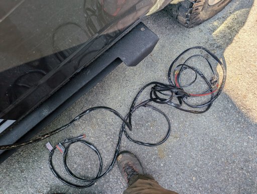

replaced the broken center console lid plastic catch. I was happy to find a metal version on amazon for cheap. I also finished wiring my remote switch for the dual battery charging relay so I don't have to run the
underhood manual switch anymore. the blue sea charging relay with small remote switch is an awesome setup, simple and well designed.

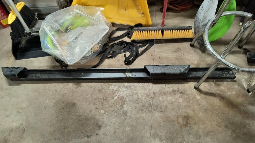

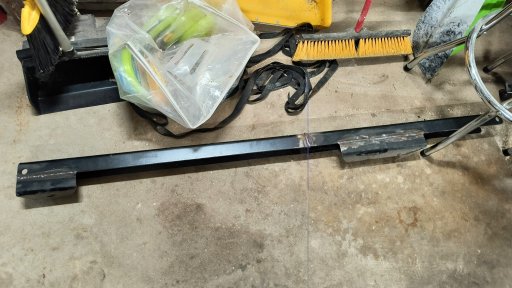

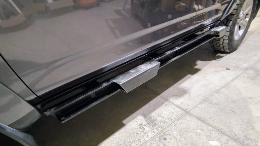

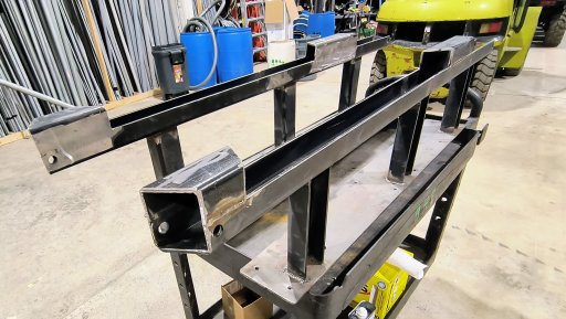

rock sliders almost done being built. they are made from scrap steel generator shipping brackets. the open channel side will be faced out.
the two parts that stick out are the (longer)front door step and the (shorter) roof rack step just ahead of the rear tire. My buddy and I also came
up with a way to thru bolt these all the way thru the box frame and be able to crank them down without waffling the box frame...he is very shmart!

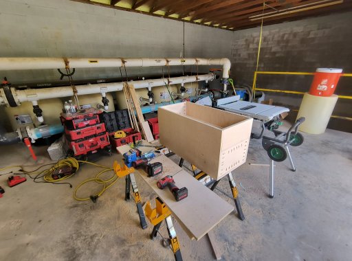

also tweaked the bedslider. I built a base for the new Yeti cooler with room below for a sliding drawer to be built. I replaced the old deck with 3/4"
plywood cut to be a hair longer and 7-8" wider as well. I added a 3/4"x4'x6' $50 tractor supply rubber horse mat as well.

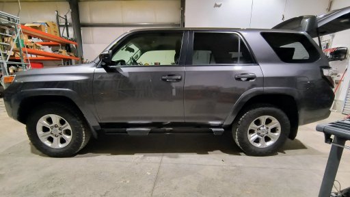

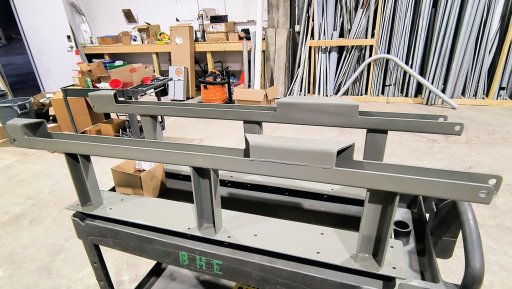

rock sliders built, test fitted, prepp'd and primed. my buddy just finished these up for me last weekend. they are built out of scrap generator shipping brackets and a hair thicker than 1/4" and weight at least 75-80lbs each. the mounting flange (to the 4runner frame) is a single 50" long 1/4" plate held by 13 bolts each side by factory backer nuts inside of the box frame. pretty sure you could hang my 4runner from one of these sliders off of a cliff. they are super heavy and way overbuilt intentionally. I also bite the bullet and picked up my first winch. I have been looking and comparing winches for a year and half and am happy to be done with that exercise.

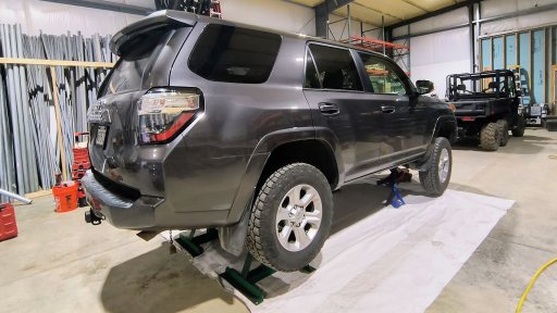

I also finally managed a day where I could put the 4runner up on jack stands and fluid film the underbody. I pulled off all the wheels. dropped the spare, pulled all of the plastic frame plugs, rubber rocker plugs, rocker/step bolt- nutsert cavity etc, etc. this was my third go this season with a new FF gun running off a 30 gallon compressor. the FF gun is kinda pricey to buy but way faster and cheaper than the FF spray cans. the plastic frame caps/plugs on the 4runners don't come out neat or in one piece but are available at the dealership parts counter...see pix below (found online) for part number.

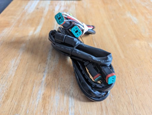

I have been busy in general and haven't updated this thread in awhile. I have added a full length sherpa crestone sport rack. I like the low profile a lot. still getting use to the weight limitations but it is a great rack regardless...with rack unloaded there is little to no impact MPG wise.

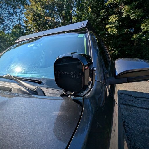

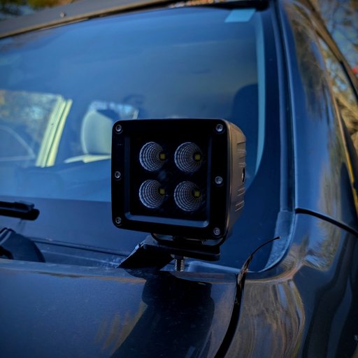

I added a pair of harbor freight 4-LED pod lights to the A-pillar area, more for on road than ditch light use. these HF LED pods are actually well made for a very reasonable price point but I will be swapping them out for something smaller, amber and back lit. the HF 4-LED pod lights are super bright, the amber backlight is nice and tasteful but the side shooter LEDs are too bright for the given location. the side shooters are not clocked (left or right side) and can't be turned off. driving down the road with them on in that A-pillar location is far too bright, the whole hood area is daytime lit up bright! oddly there is another set of HF lights that are smaller and the side shooters are clocked. other than that, its a solid thumbs up on the HF 4-LED pods when installed in the proper location. I also installed an amazon sourced 22" Lasfit brand amber LED light bar to the front of the 4runner for testing before being installed for good in the new front winch bumper. so two things, one, it does condensate as reviews pointed out and two, light output it is not only very bright/even but the reach is way further than anticipated! I might just get a second amber LED bar from the same vendor for the roof rack and call it a day on the front facing lighting on the 4runner. I paired both of these lighting setups with a HF plug and play lighting harness. other than a somewhat cheesy light switch on one of the units they were also well made (think very good solid terminations, correct wire gauge sizing and real DT connectors). You can't fab one from scratch for any cheaper let alone faster. HF uses two different sized DT connectors on their harness kits depending on which LED unit it needs to plug into so choose accordingly.
the existing full bedslider platform in the back of the 4runner is still a game changer. I use it constantly and haven't missed having a back seat once or wanted a pickup truck since.
the super heavy duty rock sliders/rock guards are still a win. I much as I hate the added weight, I still love my overbuilt 80lbs+ each sliders. they have shielded the door/side area of the 4runner from 4-6 really hard shooting rocks impacts while driving down shale roads on the last three camping trip up north. there some portions where it took out chunks of bedliner on the rails down to bare metal on a single strike.

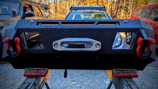

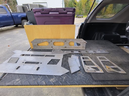

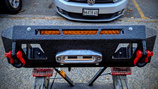

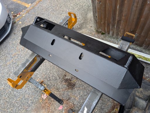

my front winch bumper is about ready for install. after all of the purchase/plans, metal plasma chopping and fabbing all by other I butchered my new front winch bumper paint wise. the short version, it is not a paint friendly shape be it rattle can, brush or roller...so thank god for leftover black bedliner. I have decided to install
the new front bumper without the winch. I recently relocationed a hi-lift jack with a pair of sherpa hi-lift jackmounts permanently to the roof rack and no longer free the need to buy a winch anymore.

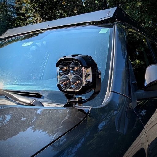

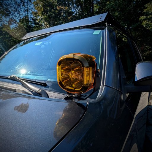

I swapped out my big ass HF 4LED pod lights for a smaller set of HF 4LED cube lights for ditch duty. surprisingly bright with the given size and very easy on
the wallet. I finally got my front winch bumper that I internet sourced and built locally ready to install with or without a winch. turns out i really need to
address the front suspension before I go further...wah, wah :(

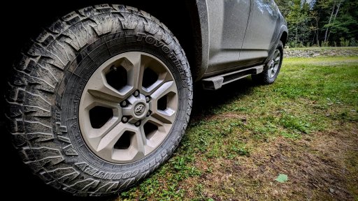

if there is any upside to a suspension rebuild is with a small lift I will be able to go from (undersized for my 4runner )245/70/17 to bigger than stock 285/70/17 or what I really
want to run 255/80/17.

Did you get someone to cut and weld that bumper from plans? Been looking for a partial bumper like that for my 4th Gen 4Runner
Broken Yoke
443
Portland, ME, USA
Christian
Jackson
yes, I bought the plans from etsy, got the steel plate CAD file burned locally at maine fabricators in gorham and welded up by a friend
who is a great TIG fab guy.
the maine fab. guy even tweaked a couple of small things on the burn file for me before that sent it over to production...good shop.
