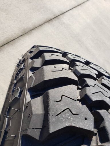

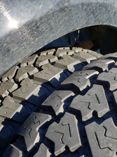

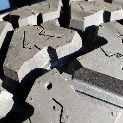

Well I did this a while ago and am just now getting around to this. 5k review of sorts on the mastercraft cxt. 5000 miles some beach, some off road, but mostly streets. Wear appears even and light. No increase in noise. Ride is good. Running them at 45psi. Traction for days in every environment I've had them in. At this point the only reasons I would switch is to see if I eek out some more milage by using a KO2. I rotated in my spare so there is a direct comparison to new tires...20190105_092401.jpegIMG_20190118_005852_628.jpegIMG_20190118_005852_629.jpeg20190105_091401.jpeg

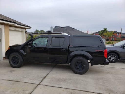

On a side note, I got to test the snorkle out. I had water half way up the windshield and other than having a mess on the outside and a small mishap involving bumpy road and an unsecured fire extinguisher, no problems what so ever... can't wait to install the lift that will be here in March. Also my shrock sliders and bumper should be here at the same time....

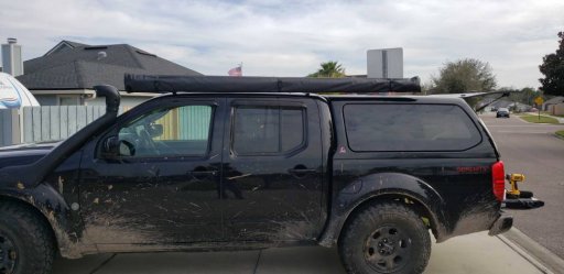

Thanks man. Just wait a little bit. Parts are on order. Phase one will be done in April. It's going to be absolutely epic. In the mean time, the progress continues....20190215_154437.jpegreceived_305086663528307.jpeg
