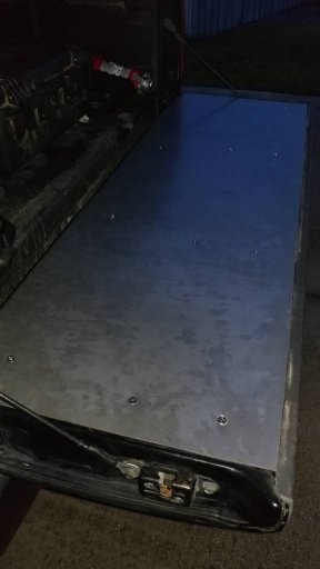

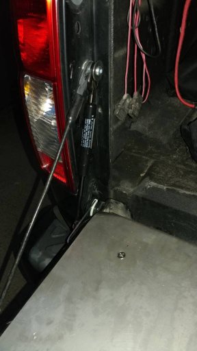

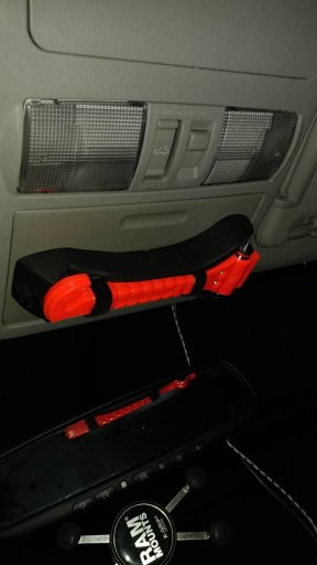

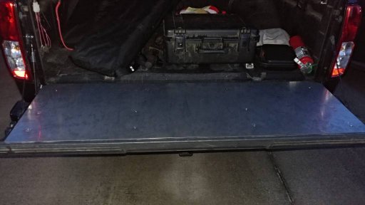

Well I have been pretty busy, but I'm not sure I can remember what all I have gotten done since the last update. I removed the plastic tailgate protector and replaced it with a piece of flat stainless sheet. I also installed a gas lowering strut on the tailgate. Pretty sweet setup now. I took a bunch of pics of my cab showing all the ram mounts and ultra gauge, but my phone apparently decided I didn't need them so here's the pics it did decide I could keep[emoji12][emoji12]20180930_193231.jpeg20180930_193242.jpeg20180930_193252.jpeg20180930_193445.jpeg

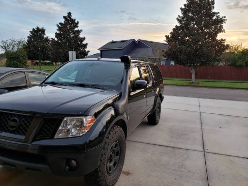

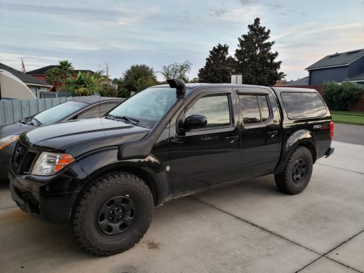

Well I finally did a mod that is easily noticed... until this point, with the exception of tires and rims all my mods have been internal or at least subtle. I present to you the 93$ Ebay special snorkle!!!20181022_184158.jpeg20181022_184132.jpeg

It seems pretty stout. It's got some areas that are thicker than others, but nothing concerning. It's the one for the Navara. The o ly issue I had was the template was off a smidge. It's actually about an inch too far forward, which doesn't affect how it sits on the vehicle so much, but in order to make all the plumbing fit I had to leave my air box sort of free floating in the engine bay. I also had to do a fair amount of dremel work to get some of the pieces to fit. But I have everything hose clamped and Rtv'd and it seems to be working.

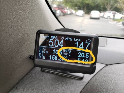

Well, preliminary results are in. With the engine at operating temps and parked my intake temp was at least 45 or 50 °F cooler than it was pre-snorkle. Also on a drive I make almost every morning I made +2mpg from my previous recent record. As far as perceived performance, it seems to be a bit more responsive in the low end, and cruising throttle seems to give higher instantaneous mpg readings. Preliminary results only, and likely influenced by wishful thinking....20181023_110417.jpeg20181023_110518.jpeg
